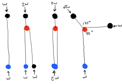

Try thinking about it as if nothing is moving.  Imagine that the truck is fixed too, and is just using the winch to exert tension on a static rig.  I'm bored tonight, so I drew pictures
Anchors are black dots, Power Wagons are blue dots, and single blocks are red dots. The winch exerts W pounds of tension. For easy math, all winch lines are parallel except for the last example. No friction from the blocks.
1. The first diagram is a straight pull. The Power Wagon is experiencing a pull of W, and the anchor is experiencing an equal and opposite pull of W.
2. The second diagram is also a straight pull. This is the scenario that people sometimes "think" gives them a double advantage, but does not. The only benefit to this rig would be to get line off the drum to get down to the last wrap. The Power Wagon is experiencing a pull of W, the anchor right next to it is also experiencing a pull of W in the same direction, and the anchor with the tree strap and block is experiencing an equal and opposite pull of 2W to keep the system in equilibrium.
3. The third diagram is a double pull. The winch line goes through the block, and back to a tow hook on the Power Wagon. Two connections to the winch line means the Power Wagon experiences a pull of 2W. The anchor experiences an equal and opposite pull of 2W.
4. The fourth diagram is a redirected single pull. The placement of the anchors just happened to work out for really easy math. Lucky me! The Power Wagon experiences a pull of W. The right anchor, connected to a single leg of the winch line also experiences a pull of W. The anchor connected to the block is connected to two legs of winch line at 45-degree angles and feels a pull of 1.4W. The higher the angle between the two winch line legs, the less pull the block anchor would feel. The lower the angle between the two legs, the more pull the block anchor would feel. If the angle between the two legs was zero, we'd be back at scenario 2. If the angle was 180, we'd be back at scenario 1.
In every scenario except #1, the block, tree strap and shackles between the two need to be rated for more than the winch rating. You get more rating out of your tree savers if you rig them with a basket hitch versus a choker hitch. I won't even get started on rigging for triple pulls, especially since that would be done using more hardware rated for double pulls. No need to go shopping for 1" shackles

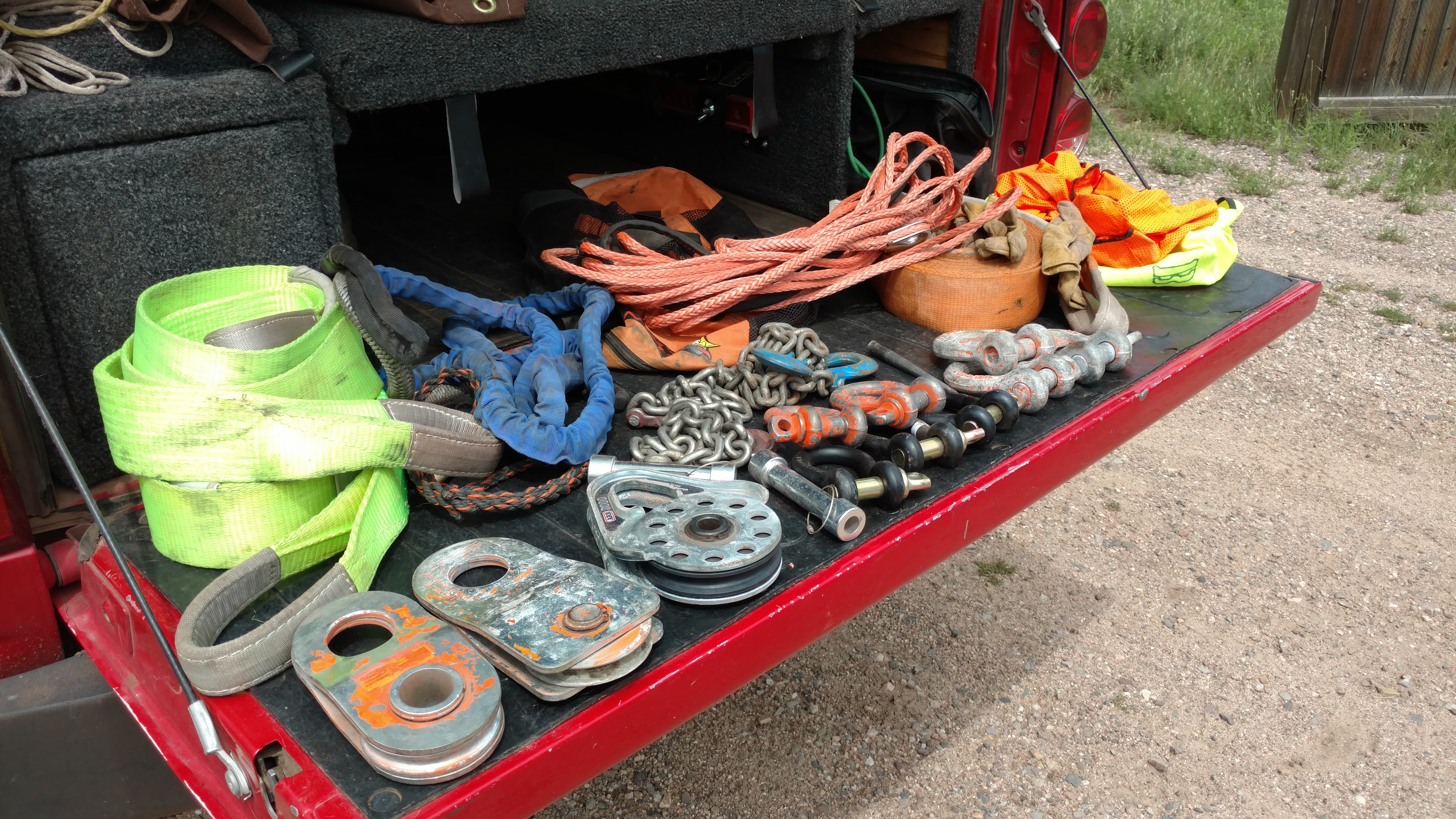

This is my kit. All three pulley's are 20K rated, the shackles are (5) 3/4" and (3) 7/8", all rated at 6.5T. Don't over think it - these have done multiple double line pulls, dozens of single line pulls, and many redirected pulls. The snatch blocks are: Smitty Built 20K, ARB 9000 20K, Warn 88899 20K. If I'm going to load the system really heavy, the ARB is my #1 choice. Two ARB tree savers, one WinchLine.com 50' extension, one 10' rigging strap, two rope bones, one ARB 3" x 30 tow strap, and a couple safety vests. If we know we're heading into really bad conditions, I take the gear out of the JKUR which doubles what's shown here.

Good point. The hole in the RW14000 is 1-1/8", but I thought it was larger until I went out and measured it.A 1" shackle also has a 1-1/8" pin, how big is the shackle pin hole at the end of your pull pal?
