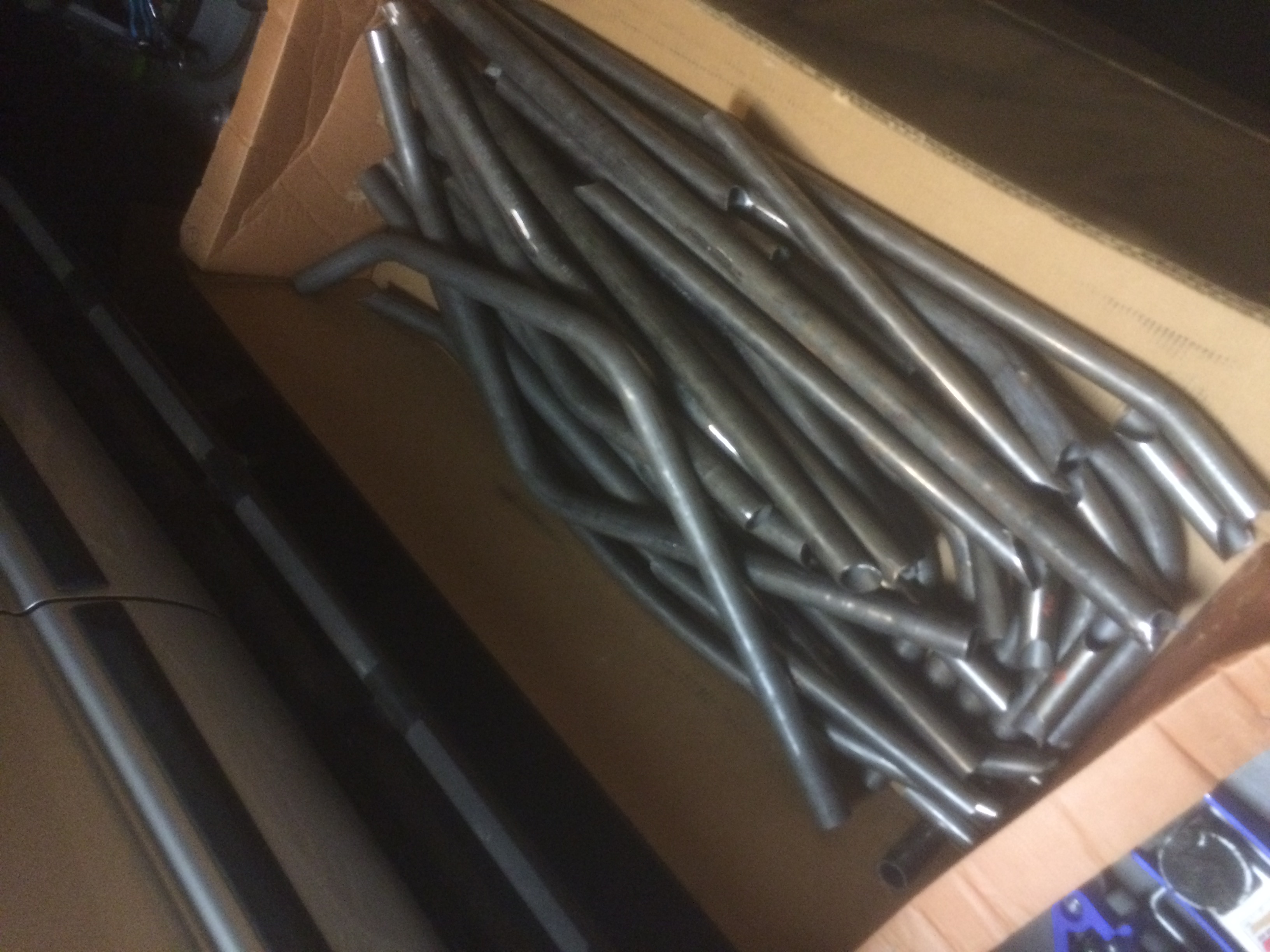

Took delivery of the roll cage, it's very well done, can't wait to get it burned in.  I had to take my front end apart to reclock the grease fittings on the lower ball joints. If you put them where Carli recommends the zerk is inaccessible with rcv axles. Put them exactly opposite and alls good. Front ends almost back together. Should be able to measure for driveshafts this week and be off to the fab shop soon.

How much does it weigh? Was there a shipping label on the box that says?

268 pounds sir

Worth it's weight in gold!
