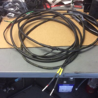

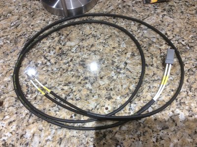

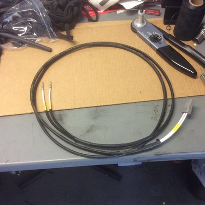

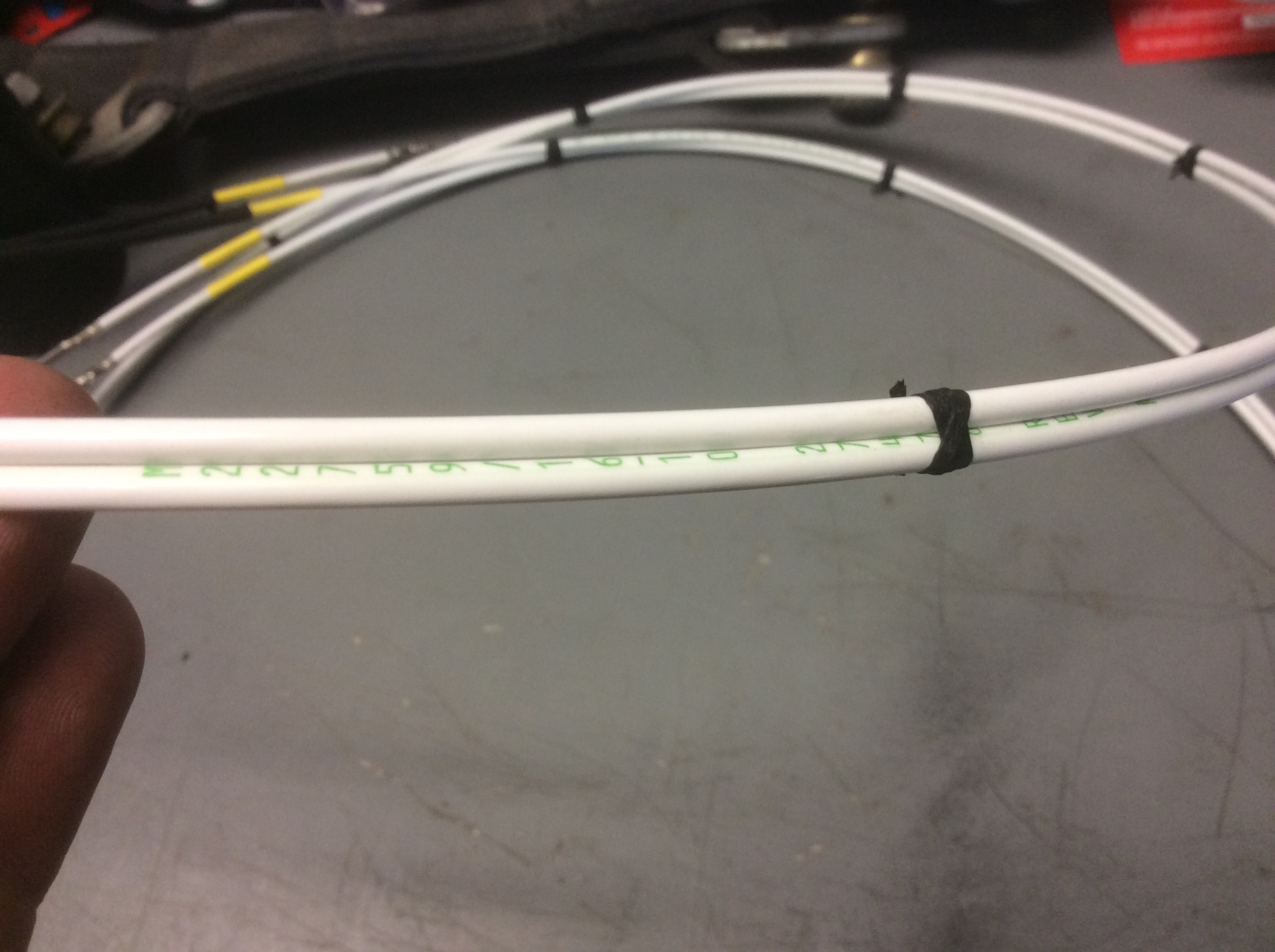

Okay! Started the first portion of the wiring today. Using MIL-W-22759/16 mil spec wire for everything, it's Tefzel insulated good to 300* and each individual copper strand is tin plated. It comes in any insulation color you want, as long as it's white lol. Therefore wire identification tags are a must. I'm using a BEE3+ heat shrink tubing thermal printer to label every wire then clear heat shrink over the tag. Instead of zip ties I'm using MIL-T-43435B lacing cord. Good to about the same temp as the wire and 50lb test. Every couple inches you tie a clove hitch followed by two half hitches to bundle the wires securely. Sheathing the bundles in Raychem DR-25 Heat shrink which is resistant to fuel, oil, and battery acid and good to 300* then sealing the ends of each bundle/harness with either a shrink boot and epoxy or adhesive lined heat shrink depending on location and connector style etc. Deutsch DTP and DT connectors for everything.
This first bundle is the power feed for the ham radio. Deutsch size 12 pins at the firewall connector to 10 gauge wire, all rated for 25 amps continuous. Down to a two position male DTP connector for the kenwood.

Very nice, I have piles of Tefzel, Kynar, TFE, PTFE, type of wire. Lots of it from aircraft, the rest of it laying around on spools! lol Have a drawer in my tool chest that cost an average of $100 a square inch in tools to do all the prep/crimping. I don't use standard wire strippers on the hi-rel assemblies, I have a heated no-nick wire stripper for that. Zero chance of a break from vibration. Wire assemblies/harnesses is one of my jobs. I plan on doing the entire truck one day, if I get the time that is, lol.

You're a damn Renaissance man pit slave!
This is my first foray into wiring on this level but thus far I am really enjoying the process. The tools and materials were a huge up front investment for me but it seems well worth it. If you or any other knowledgable fellas here have any pointers or suggestions I'm all ears, I've only read about all this up until now but am eager to learn and do! Doing the entire truck would be fantastic, just incredibly expensive and time consuming lol. I'll probably do it piece by piece through the years as things need attention though.

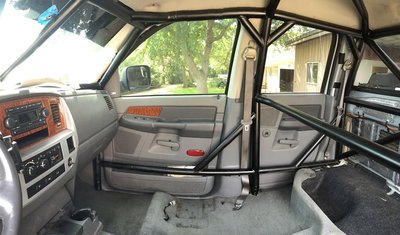

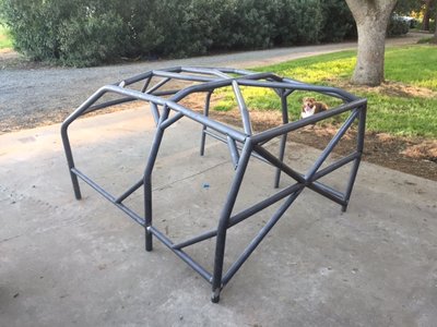

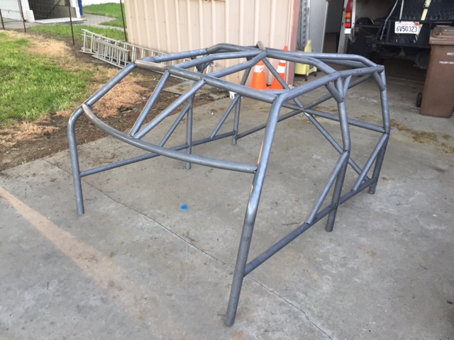

Just put a deposit on a rollcage kit for the wagon! Should be bent up and notched and shipped in about a month. Here are some pics of the cage kit installed in another 3rd gen crew cab

That's just fucking awesome!

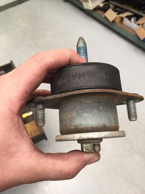

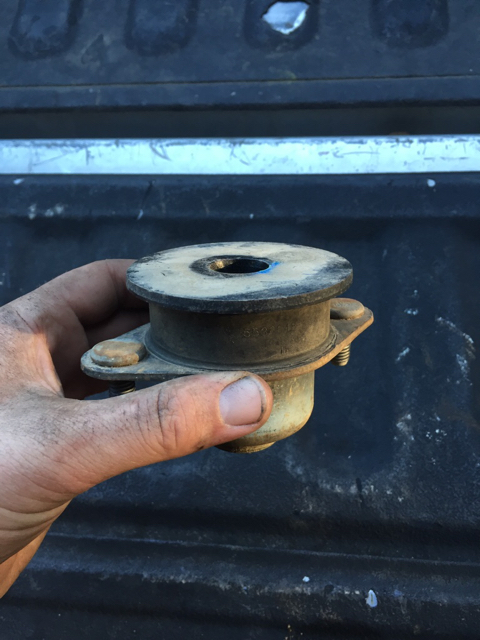

Hey Tim stoked you actually pulled the trigger! What are these mounts everyone is speaking of?!?

Thanks guys! Debating now which seats to go with, I'm leaning towards the prp enduro tied into the cage.
Lee, maybe you're referring to the body mounts for the cab? When you tie the cage to the body and the frame you need to either rubber bushing mount the cage or use solid body mounts so you don't cause problems between the two. Not sure which way I'll go with the cage mounts just yet

Lol ok that makes sense!!!

The factory cab mounts must go, they're on my list.

Will, go get some hockey pucks and a drill man! Save your cab corners from further damage

Bro, that cage...
Is there a company making these?
Can't wait to see what it looks like when everything is finished. Safety equipment may not be sexy, but nothing's more important.
