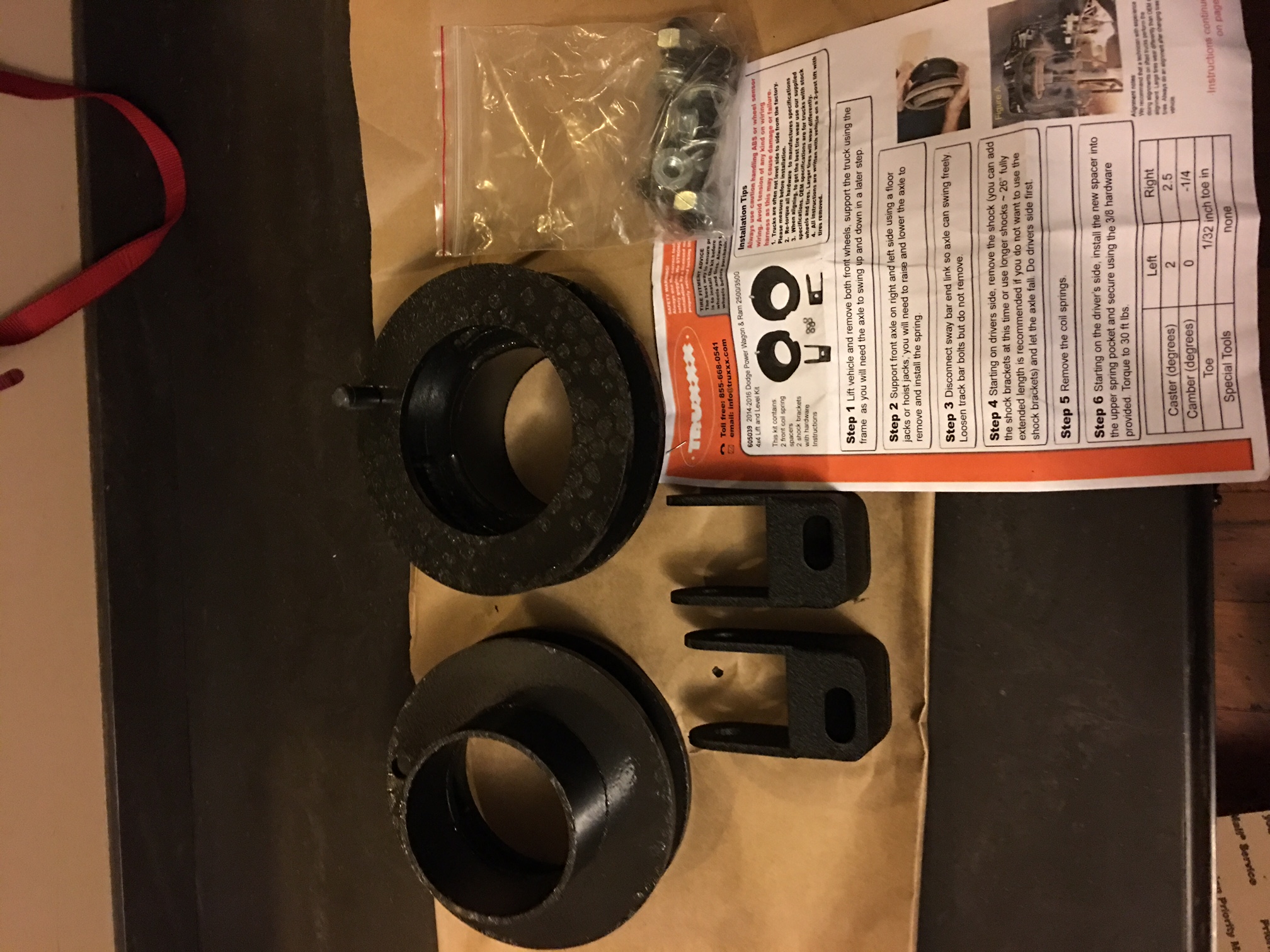

TRUXX 1.5" PW Specific Level Kit
MOD: PW specific 1.5" front end level kit
MFGR: Truxx
COST: $160 + $19 S&H
I am not a fan of the front end rake on Ram and GM trucks. I do not have a slide in camper anymore, so I'm not worried about riding nose high right now. I've spoken with the marketing & sales rep, Robyn, & the manufacturing machinist to get a feel of the product, the materials, testing & discuss performance, and was impressed with the responses. If the 4.88 gear swap is completed by Thursday, I'm going to try to rent a spring compressor & install the kit this weekend.
MFGR: Truxx
