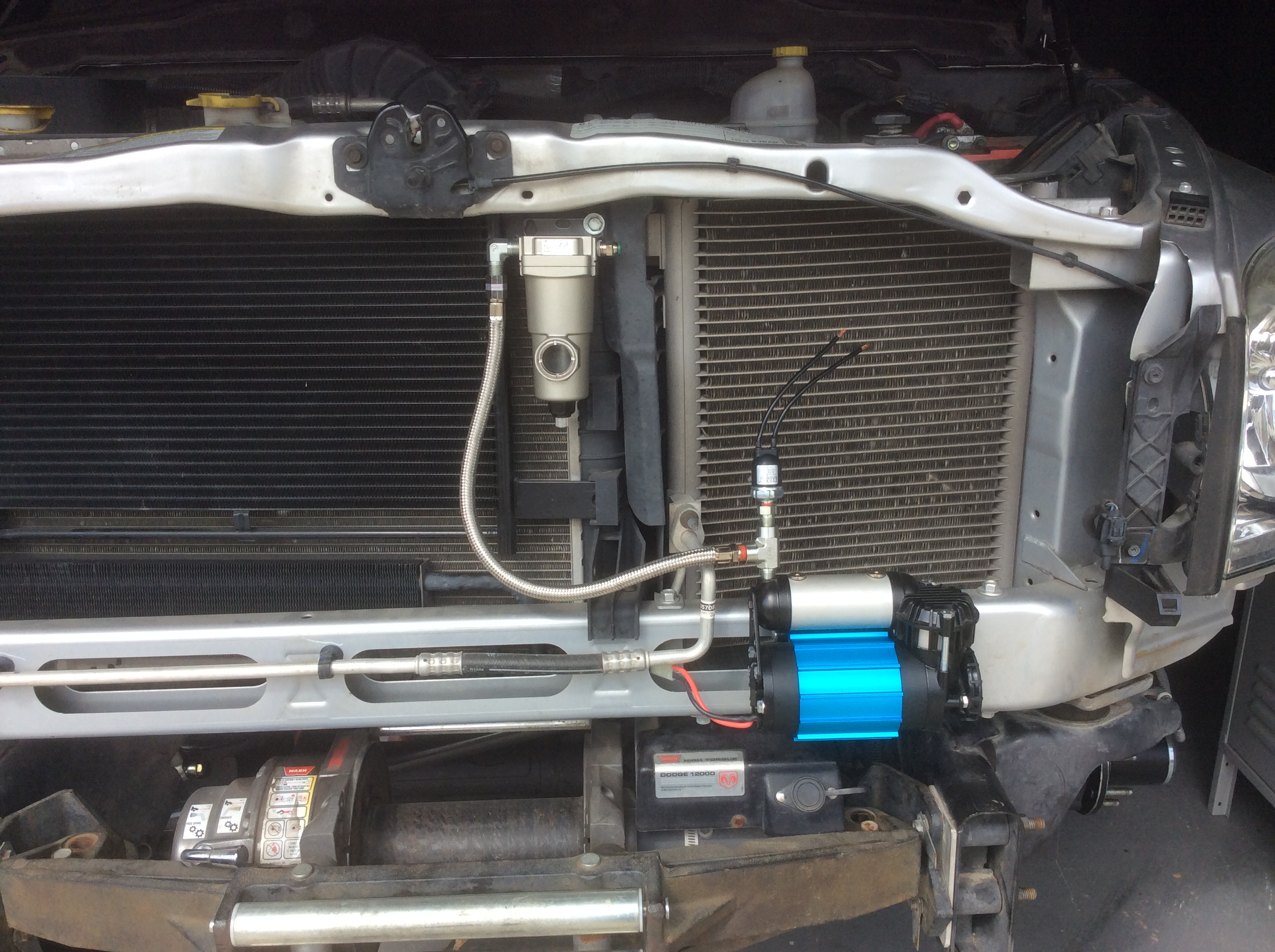

Got the arb compressor mounted this afternoon, put it up on the core support behind the grill. I'm going to cut off the connector that it came with and replace it with an environmentally sealed deutsch connector and route the air intake up behind the headlight.

I ordered an inline water separator/filter to keep crap out of the lockers and lines and a braided stainless leader hose to keep the compressor from cooking the 1/4" air tube. Waiting on some tools and supplies to start wiring everything up. Damn deutsch crimper was almost $300

I was surprised it being from arb and not having a water proof set of connectors on it as it's meant to be underhood anyways in the elements. The stainless lines is a killer idea I will have to keep an eye on mine as I'm not sure what the temperatures of the air output will reach after the pumps been on for awhile!

Progress is slow these days, but managed to get a little done with the compressor. Mounted the air dryer and started scoping out the exact location for the auxiliary fuse and relay box.

Nice spot. Should keep it dry most of the time, and clean air. Unless you're about to nerf someone of course lol

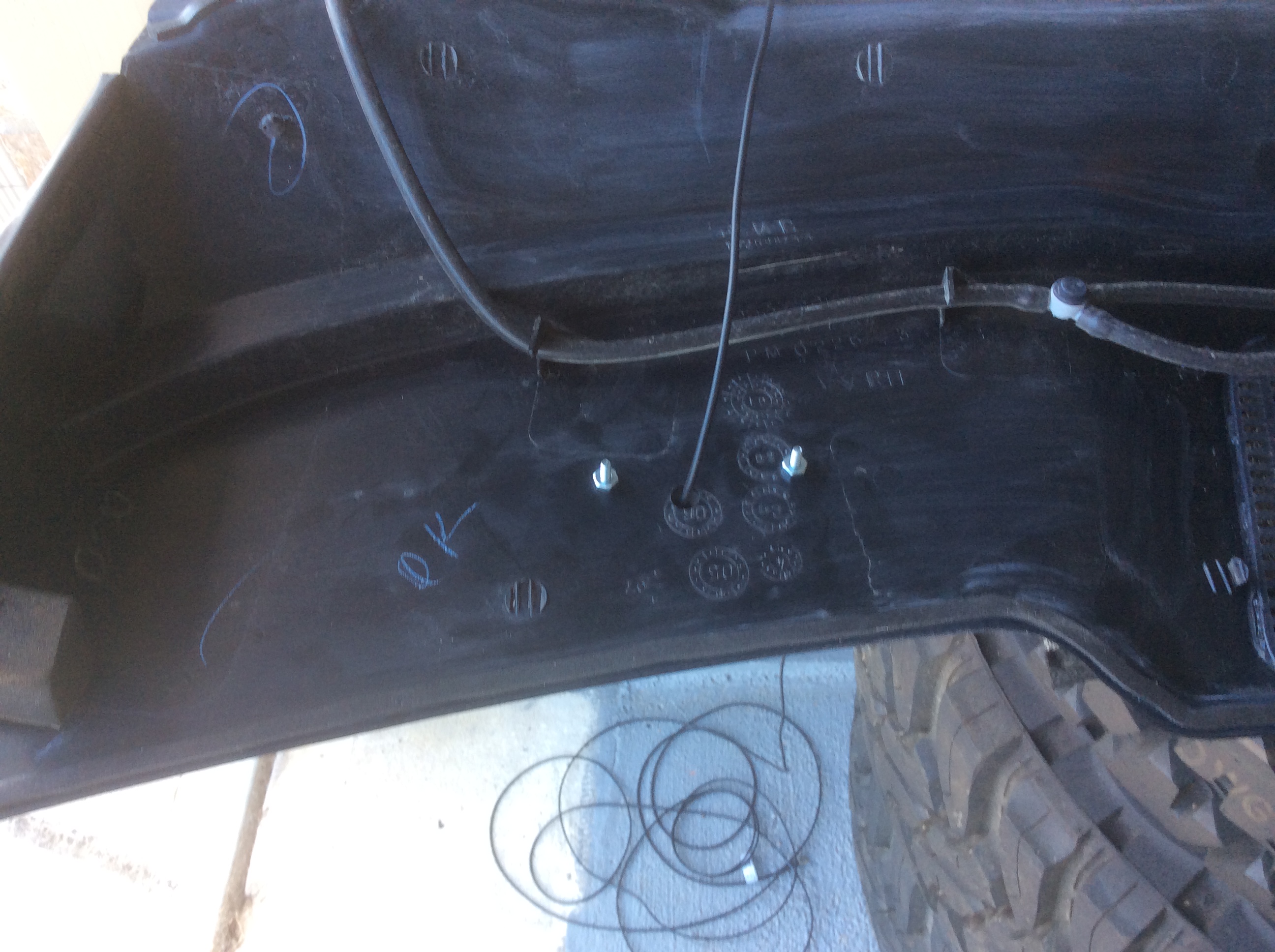

Got the gps antenna mounted and the wire run through the wiper arm bulkhead. While I had the cowl off I cleaned it up and put new weatherstripping.

May paint the antenna black so it doesn't stand out quiet so much, not sure yet though.

Ya paint that shit looks like you got a crispy creme sitting on the cowl

looks slick but I agree paint it!
Re: Boogie wagon take 2
Crispy creme=cop magnet. Definitely painting it black now lol
IDK, I might still mount mine on the roof. What phish phinder did you get? I have the HDS-5M gen2 I'll be installing soon.
That's a nice unit pit slave! I just have the hds 5m baja (gen 1) does yours use the point 1 antenna or the smaller one like mine? I haven't seen the point 1 in person but the smaller one i don't think would seal very well without some sort of backing plate or a little something extra. Might need rtv or sealant of some sort down the screw holes as well. I'm curious to see what you come up with man!
