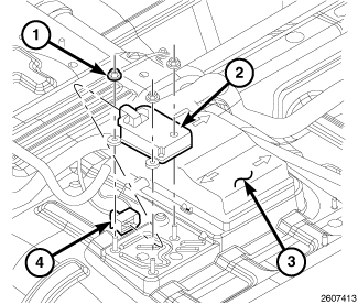

What I'm thinking that this is a Yaw sensor. On my Nismo. There is a Yaw sensor under the center console. We cut one wire (power), then wire in a switch to eliminate the sensor, stability control, and traction control. If you want it to work again. Shut off the car,and flip the switch. Then restart. Find that sensor in the PW. Think you might be in luck to fixing your problems.
Yes, the yaw sensor. That is it. What you did to your Nismo is exactly what I did to my Jeep. Functions the same way also... have to shut the vehicle off and turn back on to get the system functioning again. Wonder if the new waggies have the same setup. Easy fix if so.

I think we have to find out where this yaw box is in the 4g power wagons! Would be nice to do a doughnut from the flick of a switch. This should be a new topic!

The yaw sensor should be around the center of the vehicle.

As I suspected, the yaw sensor is indeed part of a 2 sensor system called the Dynamics sensor (P/N56029341-AC) for roll & yaw motions, I have nonid a how to get to this location, but for what it's worth, this is from a Ram vehicle systems engineering manual:
"The yaw rate and lateral acceleration sensors are housed into one unit known as the dynamics sensor (2). The sensor is used to measure side-to-side (lateral) motion and vehicle rotational sensing (how fast the vehicle is turning - yaw). The dynamics sensor (2) is located on the floor panel transmission tunnel under the center floor console (or if equipped with a bench seat, under the front center seat section) next to the Occupant Restraint Controller (ORC) (3)."
