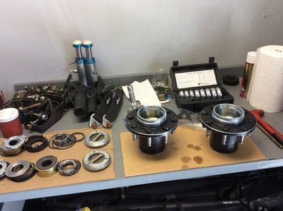

Pulled the dynaloc hubs off my tj and swapped in the drive flanges from the truck, I missed having lockouts on the street. Packing the new bearings and hubs with redline cv2 and getting them on the truck this weekend I hope.
It turns out that when the axle was trussed they put a weld washer on the track bar mount to reinforce it and it has rendered the stock bolt to short :doh: McMaster Carr came through with a M16x2.0 80mm flanged hex bolt grade 10.9 to my door in two days for 12 bucks. The fastenal in town would only sell a pack of 25 for 110 and could have them in a week lol.
Cleaned up and laid out ready for assembly

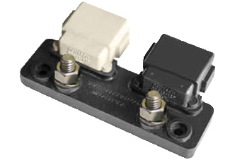

Just picked up a 50qt arb fridge on sale today, then next major purchase will be gps and a ham radio for the truck. I think I've decided on a kenwood TM V-71A dual bander and a Lowrance elite 5m baja with external antenna. Also picked up a couple of sealed fuse/relay blocks that use metripack terminals and a sealed buss bar that has a couple of 12 pin deutsch connectors. Should be able to wire everything in with a damn near factory look and be environmentally sealed to boot.
Sealed bus bar-one side ground other power
Bussman fuse relay block w/bussed fuse power to 80amp
TE connectivity sealed fuse relay block (got 2 of these)
Kenwood radio, gonna do MARS mod and get broadband antenna for max versatility
Not just good, good enough lol. Not the newest or fanciest but it'll work well for my usage

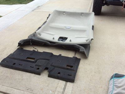

Pulled the interior today in preparation for sound deadening and install of ham radio, gps, air locker plumbing and wiring and fire system plumbing. Seats and carpet are out as well as all interior paneling and the headliner.
