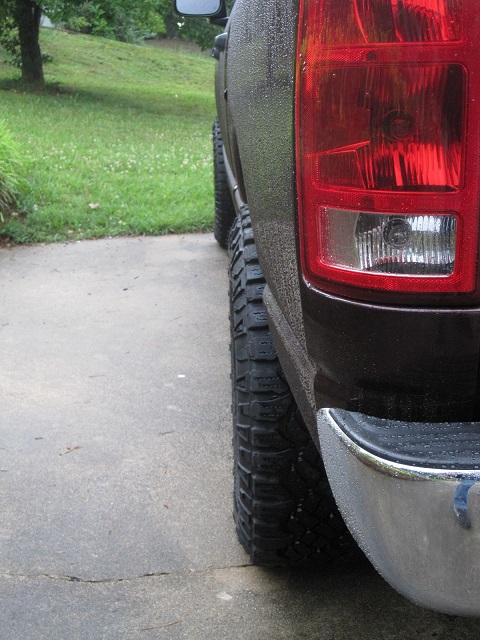

Well, using your wheel specs above the PW wheels stick out 1.75" beyond the wheel mounting surface, while the H2 wheels are 2.937" beyond the wheel mounting surface. So by those calculations, I would say the H2 wheels will stick out roughly 1.187" further than the PW wheels.azracer wrote:Just for reference.

Back when I was looking into my options I went to Discount tire to get all the above info. I also thought it was about 1.1" farther out but the Discount tire guy subtracted .25 for the 0.5 additional rim width. I thought it all went on the outside based on the numbers but he insisted it was split between the inside and outside. He is their Rim fitment guru. He answers all the fitment calculations for southern Arizona Discount dealers and was trained by them to do that job so I just let it go. Why quibble about little more than .25" is how I figured it and is why I said I was told and did not say that I calculated it to be about .75". I knew someone would do the math too but I still opted to go with posting what the trained tech told me it was.olyelr wrote:Well, using your wheel specs above the PW wheels stick out 1.75" beyond the wheel mounting surface, while the H2 wheels are 2.937" beyond the wheel mounting surface. So by those calculations, I would say the H2 wheels will stick out roughly 1.187" further than the PW wheels.azracer wrote:Just for reference.

Yeah usually the pros are the guys to trust. But in this case the pro is wrong. Its just simple math between backspacing and rim width. The offset is not needed at all if you have those two numbers.azracer wrote: Back when I was looking into my options I went to Discount tire to get all the above info. I also thought it was about 1.1" farther out but the Discount tire guy subtracted .25 for the 0.5 additional rim width. I thought it all went on the outside based on the numbers but he insisted it was split between the inside and outside. He is their Rim fitment guru. He answers all the fitment calculations for southern Arizona Discount dealers and was trained by them to do that job so I just let it go. Why quibble about little more than .25" is how I figured it and is why I said I was told and did not say that I calculated it to be about .75". I knew someone would do the math too but I still opted to go with posting what the trained tech told me it was.
He can split the extra rim width in half if he wants, or add it all to the inside of the wheel if he wants, but once you calculate in the backspacing... well it pushes it all back out hahahaha.

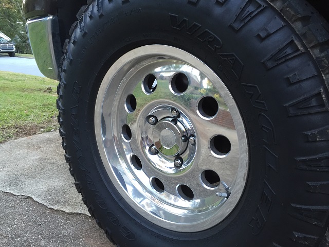

Not a Power Wagon, but I run just about the same wheel as RustyPW.
Rotary forged
Polished finish
Made in the U.S.A.
Reasonably priced
Clean styling
3200 lb. load rating for a 44" tire... overbuilt for my application. I'm sure the studs will all shear off before the wheel breaks.
I found a set of low-profile center caps on Ebay that fit, and I run composite centering rings to keep everything hubcentric. Never had any balance problems whatsoever.
Rotary forged
Polished finish
Made in the U.S.A.
Reasonably priced
Clean styling

Nice looking wheel.Alakablamo wrote:Not a Power Wagon, but I run just about the same wheel as RustyPW.
Rotary forged
Polished finish
Made in the U.S.A.
Reasonably priced
Clean styling

I went with the 17"x8" size because I don't ever plan on running anything larger than about a 12" wide tire. Only offset for that size and bolt pattern is 0mm, so the backspace is 4.5". This is a 2005 Ram 1500, so it only moved the wheel outward 1" from stock.RustyPW wrote:Nice looking wheel.What back spacing you go with?
I installed tube UCA's, and the upper ball joint boot touched the tire (LT285/70R17 Duratracs) with the OEM off-road wheels, so I needed a little more clearance. The Centerlines clear the boot well, and don't push the tire out too far.
