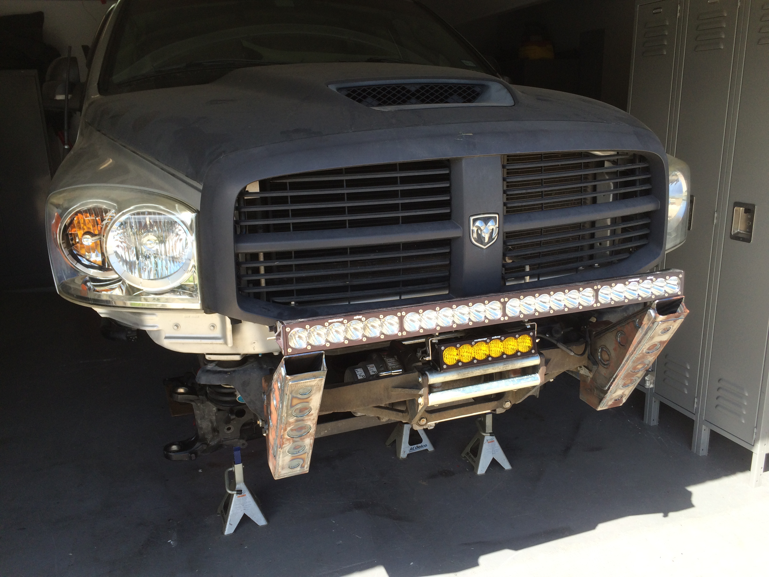

								by Colibri » Tue Oct 27, 2015 11:53 am
			Just for giggles test fit the bumper horns today

								by Pit Slave » Tue Oct 27, 2015 12:35 pm
			Who did you end up going with for the horns? PattonFab? I need to clean up and paint my Carli and CJC bumper before I put them on.

								by Colibri » Tue Oct 27, 2015 1:08 pm
			Patton horns up front and a Thuren style rear. I love the cjc rear bumper, and very curious to see how you integrate the fairlead into the front

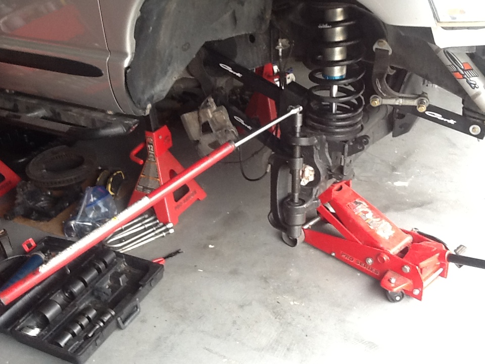

								by Colibri » Mon Nov 02, 2015 6:12 pm
			Did the carli ball joints this weekend, holy sh*t! removing the cooked in joints from when creative fab trussed it was insanely hard. Used my snap on press and a breaker bar with a hilift handle extension and I barely was able. A few times a joint would let loose a little and it sounded like a gun going off and I thought I broke my press lol. Got the knuckles back on and the spindles cleaned and painted. Front should be back together soon.

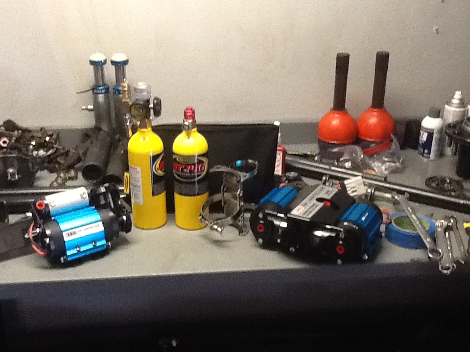

								by Colibri » Mon Nov 02, 2015 6:21 pm
			All the major components for the pneumatic system are here, ckma12 and jetpack solely for the lockers and the ckmat12 for tires and tools with the 5 gal ridetech aluminum tank. Decided to forego electronics to activate the lockers and instead use clippard mjtv-3 air toggles.
Fire systems showed up today, got two halgaurd handhelds and two coldfire suppression units. Going to plumb one to the engine bay and one to the fuel tanks and keep a handheld in front of each front seat.

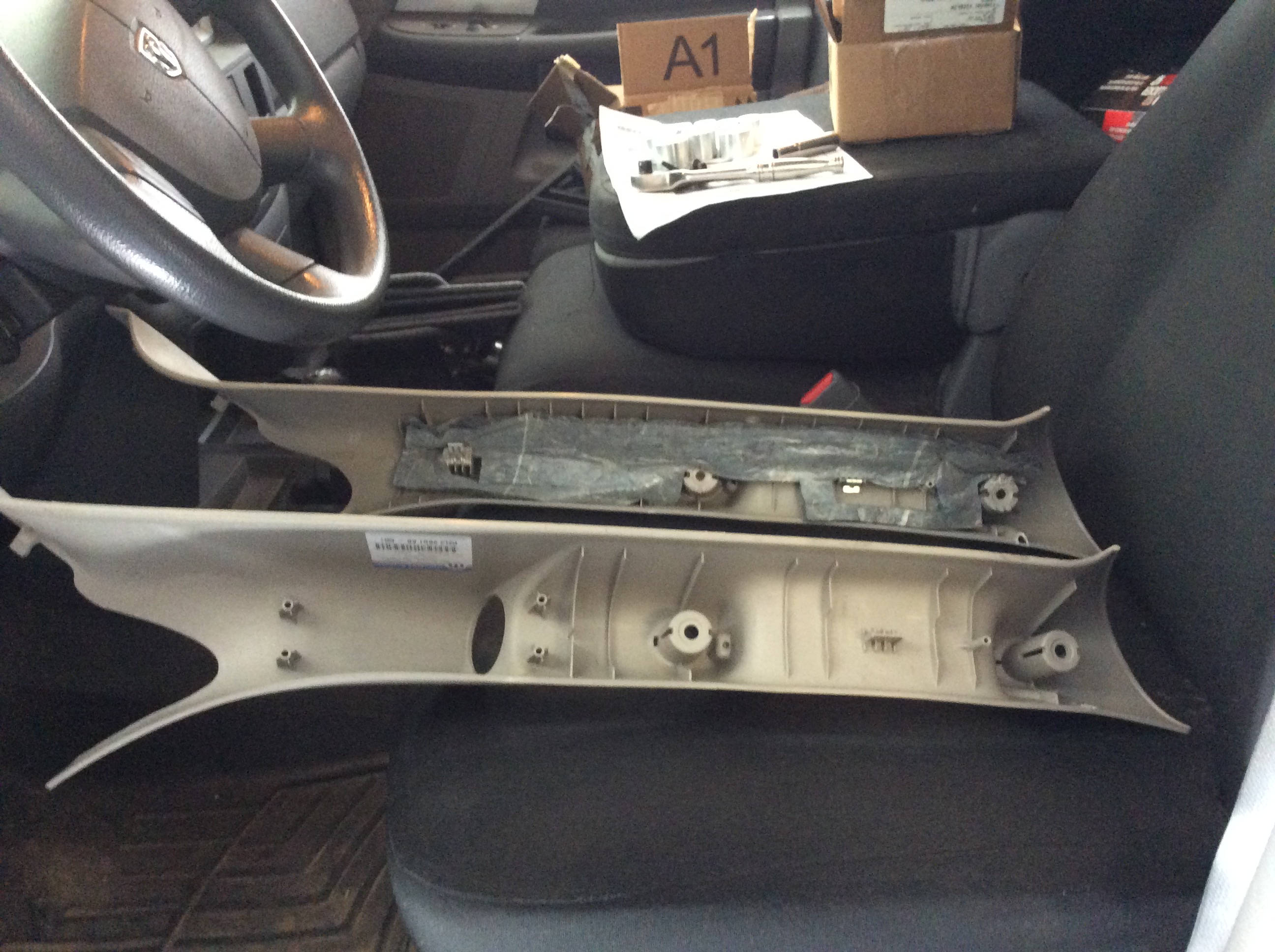

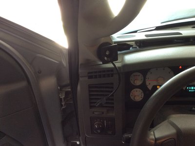

								by Colibri » Sat Nov 21, 2015 12:29 am
			Got a little side project done today, drivers side a pillar got swapped out for the srt unit and both a pillar grab handles got reinforced with geno's garage billet aluminum hardware. Ran the cable for the diablosport and installed the gauge pod adapter so I can use it to monitor the transmission temp.

			Nice! I did similar and love Geno's A-pillar kit, although when I got mine it was from the guy who makes the kits (at a higher cost though).
Post some pictures with the programmer installed. Looking good!

								by 2011RPW » Sun Nov 22, 2015 1:49 pm
			I've thought, a couple times, how the grab handles are weak. I wasn't aware there was a reinforcement kit. That's an awesome idea.
