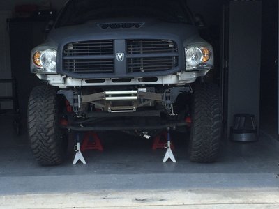

Hello everybody, I figured I should start a build thread over here to share what's going on with my fellow power wagon freaks. My truck is an 09 I've had it about 4 years (second owner) and it's been a gradual work in progress.
It's on jack stands in my garage right now getting all kinds of good stuff done to it, it recently went through a big overhaul and the details of that can be found here: http://dodgetrucksxtreme.com/index.php?topic=13842.0
Unfortunately only about a week after it got back on the road I broke and bent my front housing, sooooo here I am yet again lol.
She sits on a carli dominator setup with front and rear hydro bumps 37" open country's and hutchinson beadlocks. Motor is stock save for a cai and catback. It's got a sharadon stage 2 545rfe and edge tc. Aluminess front and rear bumpers and white knuckle sliders. The entire starting and charging system cable-age was replaced with 0 and 2 gauge sgx it has an odyssey battery and an anl fused alternator feed. It's a dc power 270 amp alternator. Going to install a howe steering tc pump, remote reservoir, cooler, steering box, and ram assist. Also getting extreme overkill steering with emf tie rod ends put on. I got ahold of a trussed front axle housing done by creative fabworks and a rear 11.5 which are currently at my axle builders getting REM treated 5.13 gears and arb lockers front and rear. Have rcv shafts, carli ball joints, spyntec hub conversion, and poly drive flanges going back on the new front and ebc pads and rotors all around with crown lines.
In a couple days a sye kit will arrive from transfercaseexpress and I will be rebuilding the case and getting a tom woods rear shaft. Swapping bumpers and going with high clearance tube style front and rear from patton fab, and I have 3.0 4 tube king bypass shocks ordered for the rear. Also going to have rcv make their first set of rear 10.5/11.5 shafts and drive flanges for me soon.
It's too many pics to repost so I linked the original build thread but from here on out I'll put everything here as it happens. Hope you guys enjoy, thanks!

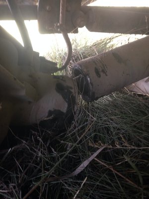

Here's the frown that prompted this rebuild
Re: Boogie wagon take 2

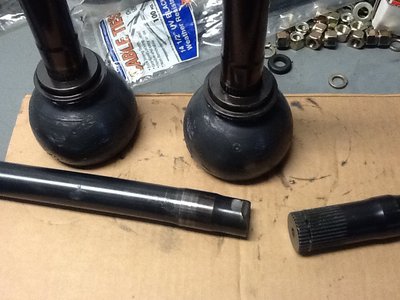

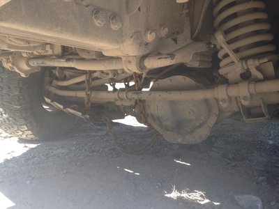

The front housing deflected so much it snapped the long side Rcv shaft off at the carrier. The only thing that held the axle together was the Carli truss, cracked center section and the tube seperated completely. Managed to drive it home afterwards very slowly

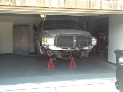

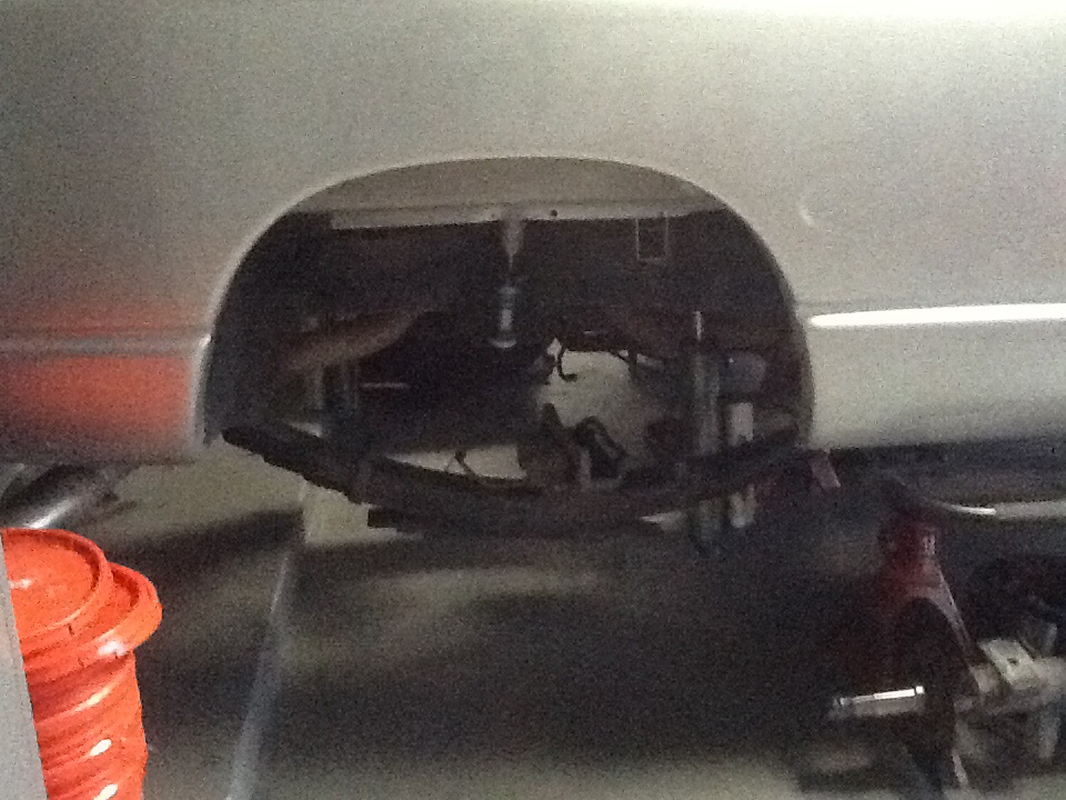

Rear end pulled

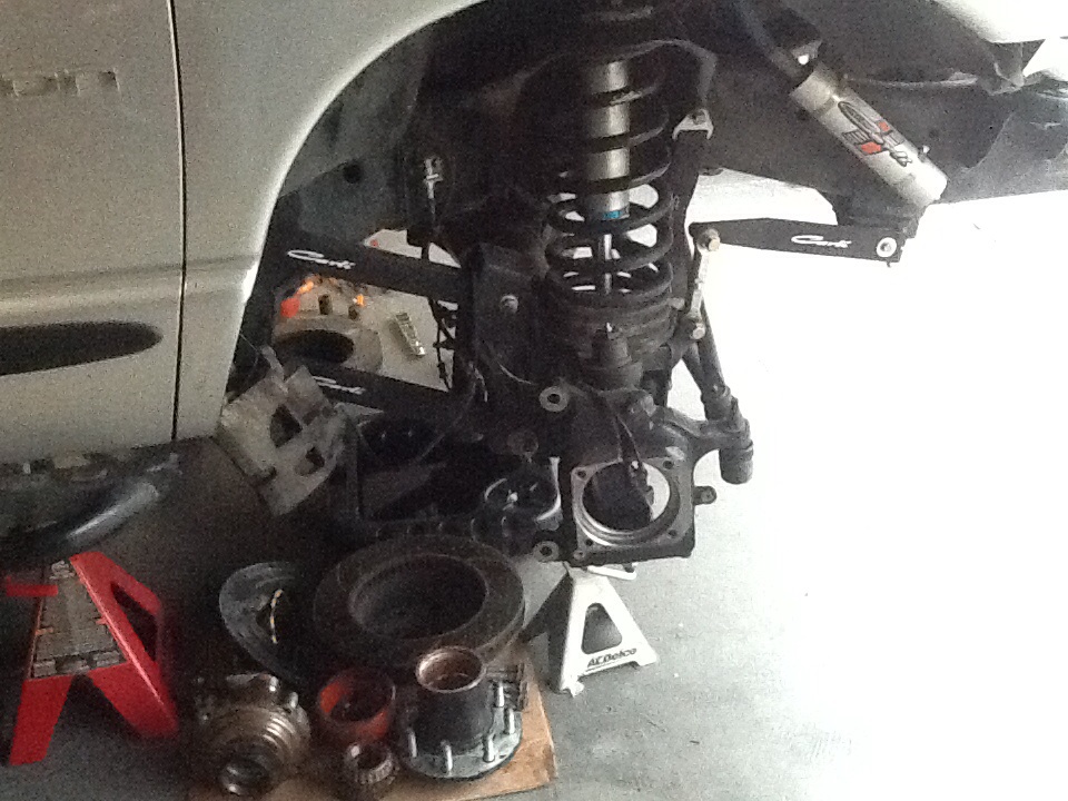

Taking front apart today

And a little more carnage detail

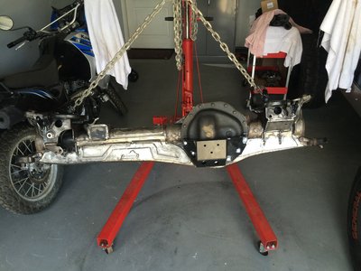

And this is the new front housing

Cant wait to see the final results.   May I ask,,,    How the hell did you bend the front AAM 9.25 axle????    I have beaten' on mine so badly over the last few years, and am still not showing any signs on bending...   Numberous jumps,,,   wheel stands under full throttle,,,   bashing into rocks etc.etc.   With good luck so far...
Do tell.....
						Do tell.....
Hahaha well, I was traveling at a speed of about 45-50 mph down a dirt road and came up on a fork in the road, I decided to go right and veered over letting the drivers side tire go through the grass a little, now I've been down this road a hundred times before and never noticed that just below the grass there was a very large diameter tree stump. It hit just to the right of the center section. Hit so hard the front end went airborne and the engine shut off. Rolled to a stop got out and saw the damage. I was out where no tow truck would go so I had to limp it home about 4-5 miles doing 5mph. It made it and the axle seemed to take the brunt of the damage. Seriously tough trucks lol
Dammit man.....      Yes...   THat would do it...    Sorry to hear..      New axle looks great..
