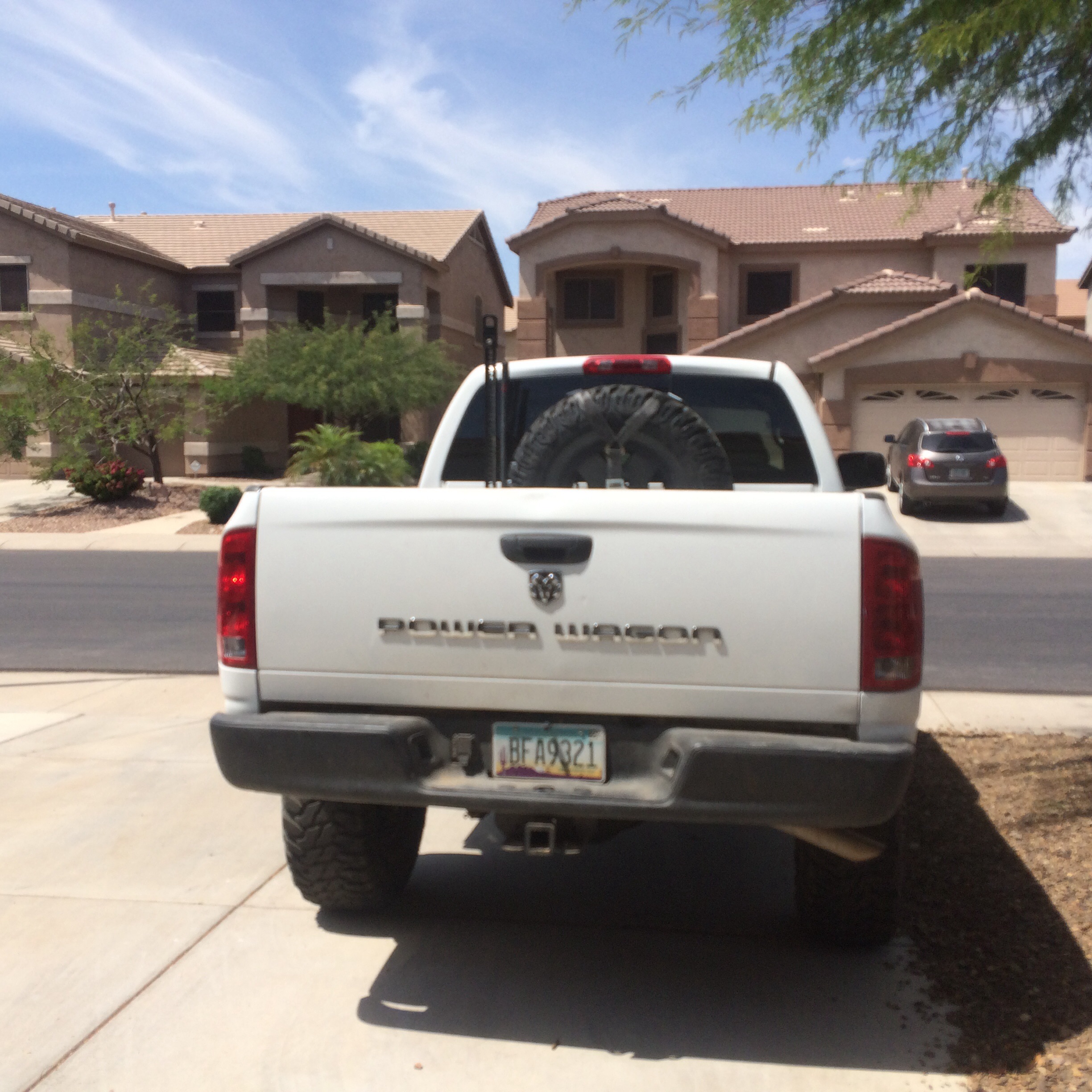

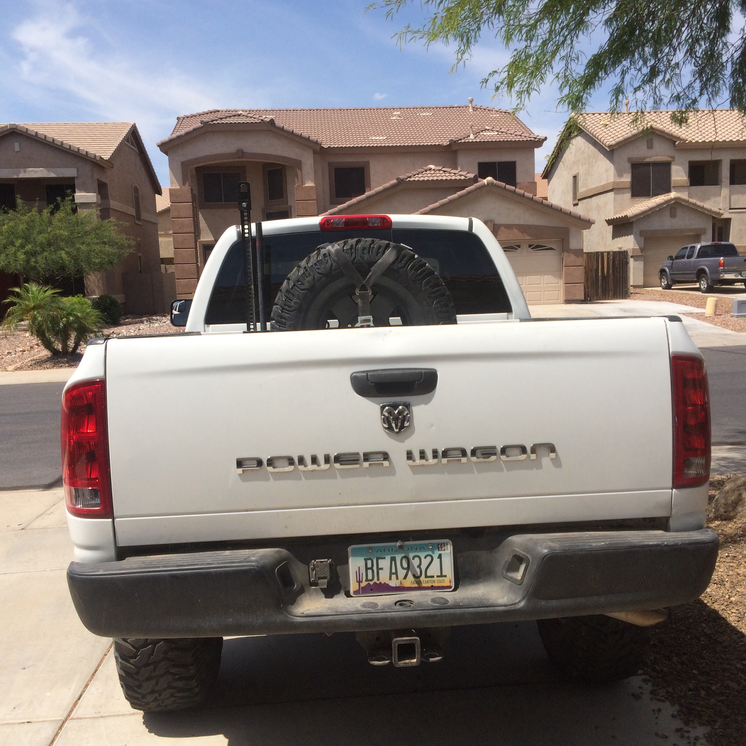

I finally mounted my 37" spare tire. Sheepdog Outdoorsman found a set of 4 power wagon wheels for sale on Craigslist and didn't need all 4, so I bought one for my spare. I mounted the spare vertically in the bed, up against the cab, using rivet nuts, I bolts and a tire hold down strap from Poly Performance. I also mounted my High Lift jack. I used rivet nuts into the bed of the truck and bolted it through the bottom of the jack and one of the holes in the cast iron part. The jack and spare tire are both solid and have no movement. Here are some pics.

Nice!
