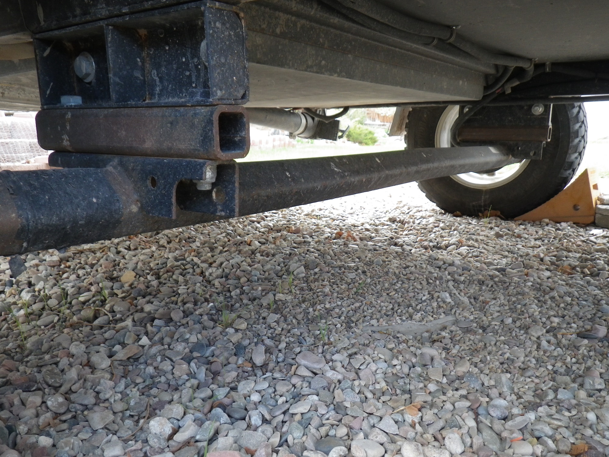

How did you go about lifting the trailer with the Torflex axle? Did you just add taller blocks between the axle and trailer frame, or did you swap out the axle? I have the Hood River Edition as well and also considering lifting it a little more. I am considering swapping the axle to a 5,000 lb. leaf spring system.TheDirtRoad wrote:We bought an RPOD 175 Hood river edition in 2011 and we really enjoy it, plus we have an Engle fridge/freezer we mount in the truck. I have done quite a few mods to the RPOD , added another 2" of lift , raised the tongue jack , raised the spare tire,removed the microwave( built a pantry in place of it),125 watt solar panel,360 degree external lighting that is remote controlled from the truck or in the trailer, I just finished building a mount for a 40" LCD TV(old tv from the house bought a 55"), and now I am in the process of designing under carriage protection. We can take it in a lot places others can't get there trailers. We use it as a base camp,1 reason for the external lighting so we can light it up when we get back to camp after dark.cell4soul wrote:My wife an I just bought an RPOD 179 for similar reasons as you. I already had an Engel fridge, so I can camp for extended periods of time. I generally like setting up a base camp and using the truck to explore from there. I also have a Kodiak Canvas tent, cots, -30 degree sleeping bags, and all the other camping essentials if I want to camp in very remote locations. The wife loves the trailer, otherwise I probably would have been fine with the tent.Cactus Red wrote:My friend All has over 300 nites in his Flippac with virtually no problems, and zero cracking. His only complaint is putting it down in wet weather, but that applies to any tent type setup.

I believe they list it as an option, it is shown as "Axle riser 20 lb" and I believe they specify it will add 20 lb to the trailer. I know on the AR One if ordering the Extreme package you get 5” extra ground clearance and a different entry step.

Thanks for the info. My trailer already has the standard axle riser, but I was considering going a little taller. I think that having a taller axle riser fabricated would lack in strength, which is why I considered going to an axle/leaf spring set up instead of the Torflex axle. Also, the Torflex axle on the trailer is rated for 3500lbs . The dry weight on the trailer is right at 3,000 lbs. by the time I load it down, I am pushing the limits of that axle. I probably won't do anything for a while......I'd rather put some more money into the Power Wagon.azracer wrote:I believe they list it as an option, it is shown as "Axle riser 20 lb" and I believe they specify it will add 20 lb to the trailer. I know on the AR One if ordering the Extreme package you get 5” extra ground clearance and a different entry step.

I was going to build a whole new riser but instead I just added a 2" square pipe spacer and stronger bolts. To make a template for the bolt holes I removed the bolts from one side raised the trailer enough so I could slide a heavy piece of paper in between then set the trailer back down, the weight imprinted the paper for exact location of bolt holes. The trailer pulls the same as it did before the extra lift and I have had it on there since 2011 and taken the trailer in some rough terrain with no issues.The photo is giving the illusion that it isn't square but it is, ( I had to go back out and make sure after looking at the photo) .

Thanks for the information. I was thinking about doing the same thing that you did to add some lift, but wasn't sure about how strong it would be. I am glad to hear you have had it down rough terrain. I may just have to do this.
