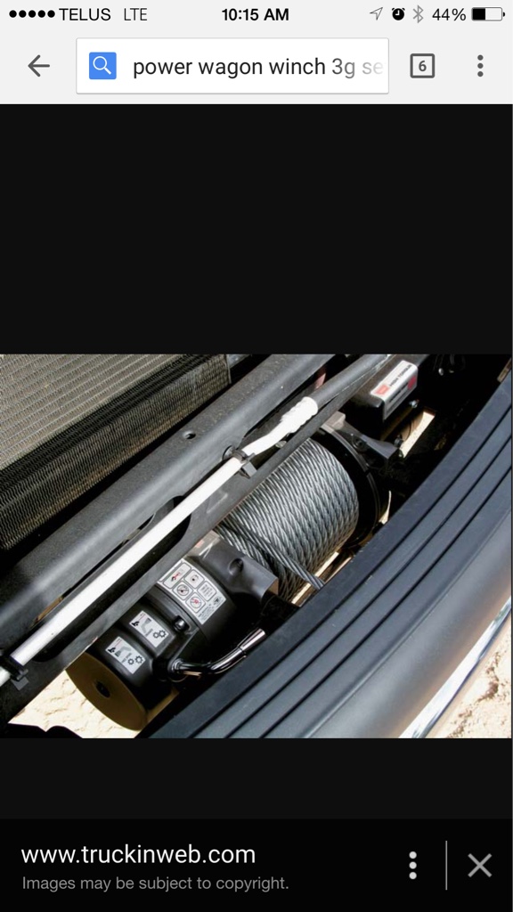

Hey guys, Big Blue and I need a couple pics of an installed 3rd gen winch, hood up, bumper on pics. My 4th gen seems to be clocked a bit different! Help us out!

Thanks rusty, I don't have access to that! I'm not part of their forum, can't see it. Can anyone tell me if this looks right for the 3G?

This is what I was able to pick of the web. Any 3G guys able to confirm this is your configuration? Short clutch lever?
This photo is a 3G setup. The short lever on the passenger side, relay pack on the driver's side. And the grille raises with the hood, which affects access to the lever. Hence the long lever for the 4G.

Ya that's what I thought. I looked at a 2012 at the dealer this morning and the winch I have is like that one. I started to install it yesterday but I didn't have any help (heavy SOB) and it wasn't fitting so I stopped until I could research a little more. It seemed like the mount/cradle would fit in the brackets between the frame but It didn't seem like there would be enough room for the control/relay box, and the lever was definitely not gonna work. Gravel Travels and I exchanged a couple of texts and he said the level could be moved (clocked) so I may need to do that. How does that level attach? Does it just screw off? Might make it easier to install if that were out of the way. May actually have to flip the winch in the mount depending on the space available. That will create another problem though. The hole in the mount for the remote connector will be wrong. Guess I should have made sure it was a 3rd gen winch before I bought it. Assumed they would be the same. Besides, no 4th gen guy would sell his winch right? :oops: If anyone knows for sure if it will or won't work in my 2007 I'd appreciate the info. Thanks.

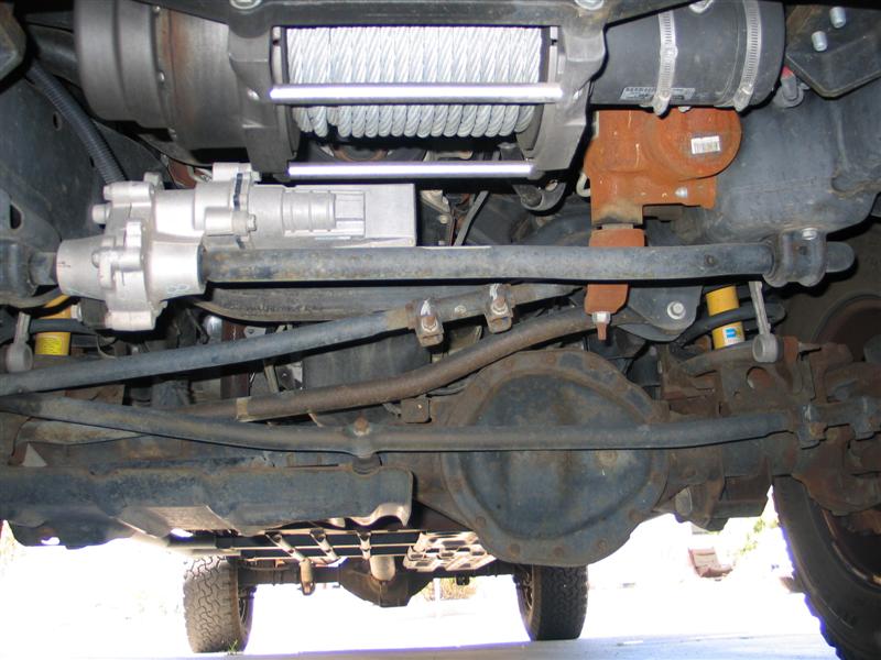

Post by cruz » Thu Mar 19, 2015 9:30 pm
Pics...
my '05

Thanks guys!! You're awesome!! Big blue, you might have to see if that long clutch handle will hide behind the grill, or else buy a short lever. Either way, text me if you want, I can run you thru clocking it, if need be!
