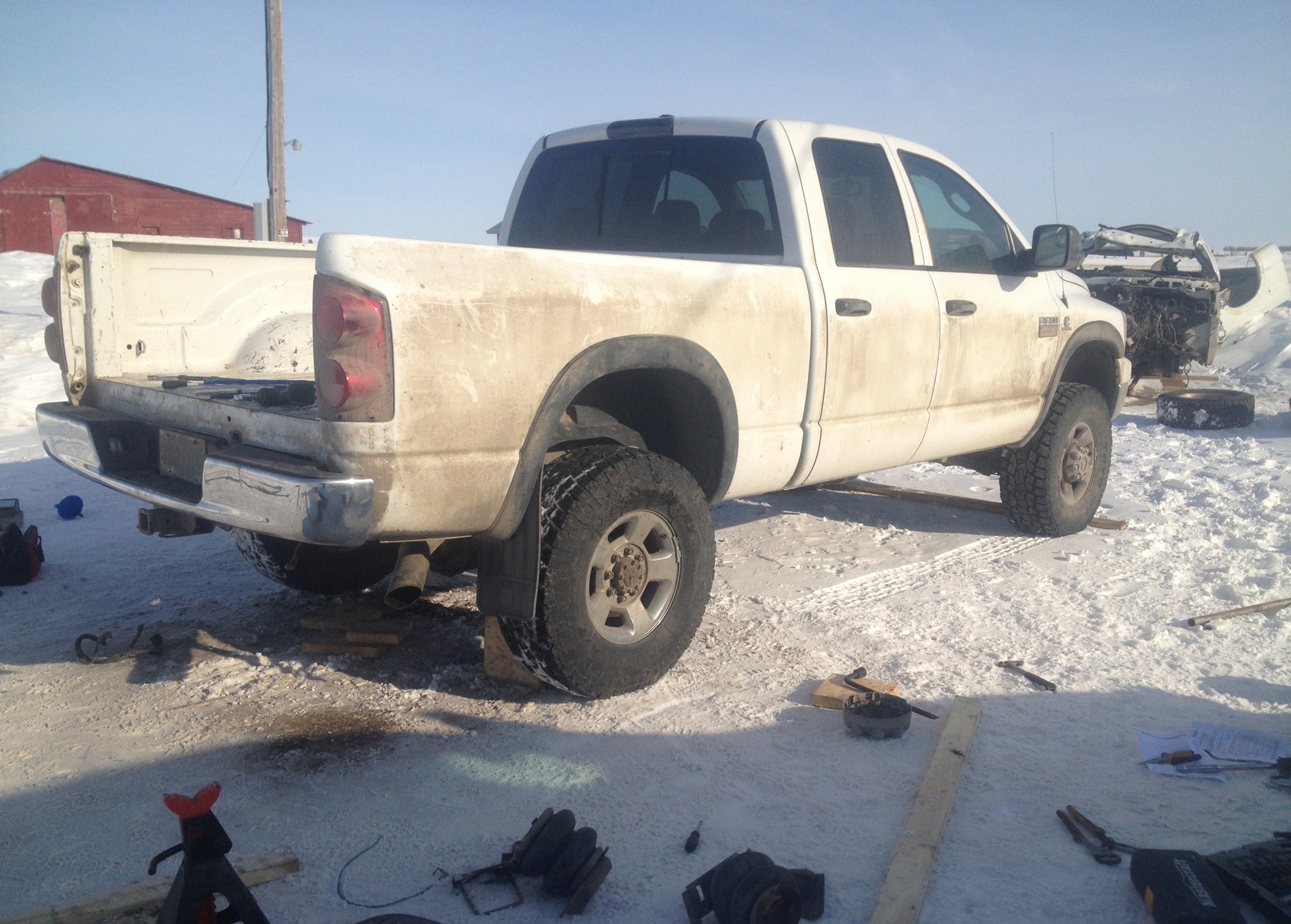

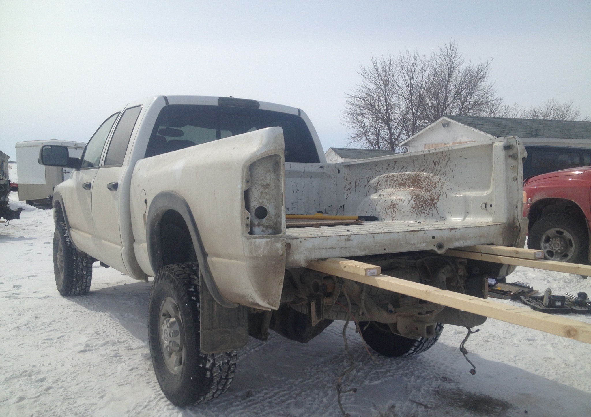

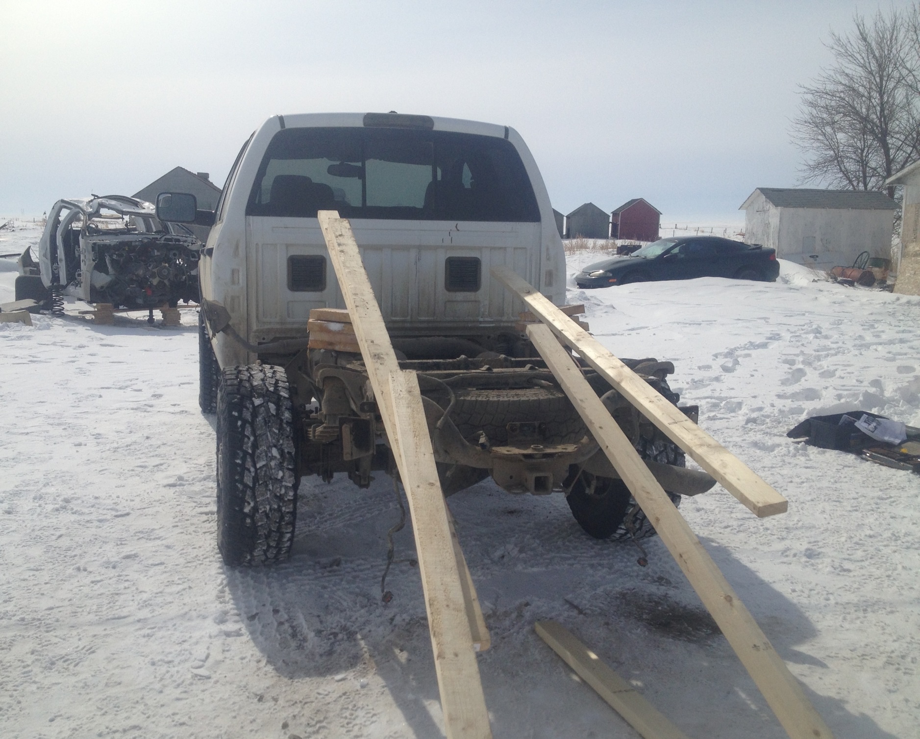

Post by nts007 » Tue Mar 25, 2014 11:50 am
Alright boys. Today is the day for the rear axle. I convinced a buddy to come help me take the box off. And gonna tear into the rear end. I'll make sure to take some pictures. Here we go

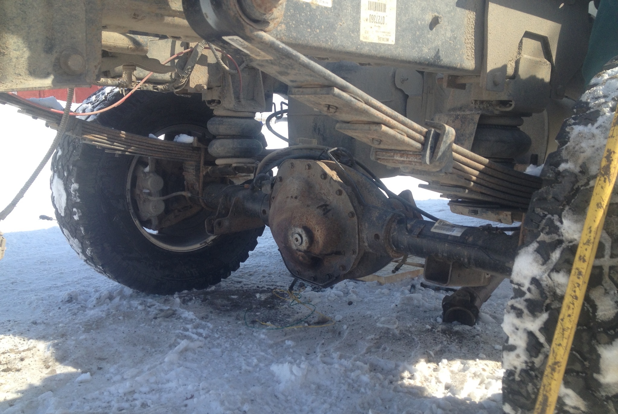

Re: PW Chase Vehicle Build By NEO
Post by nts007 » Tue Mar 25, 2014 7:09 pm
Alright. 5 hours with 2 people and no hoist or fancy tools. Still have to take it for a run. Fluids and brake bleed yet to go. And track bar in front
The before
How a contractor does things lol
Airbags didnt stay. Need longer ones

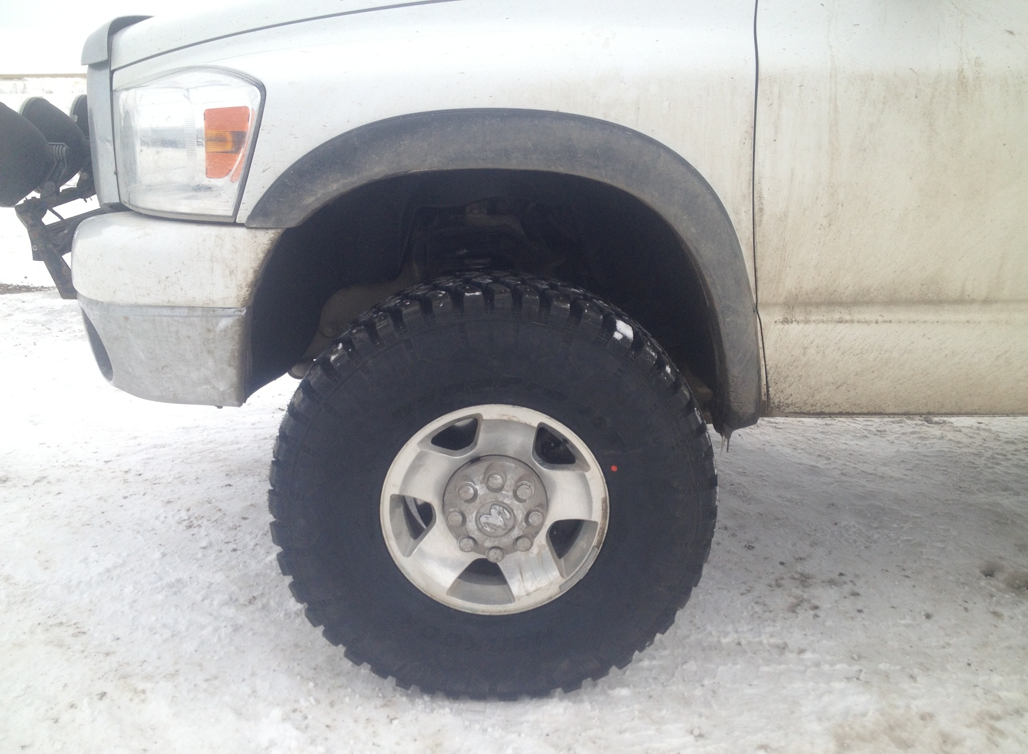

Post by nts007 » Sat Mar 29, 2014 12:59 pm
Tires on!! Had to trim the fender flare on fronts at bottom but otherwise fit perfect

Post by SheepdogOutdoorsman » Sat Mar 29, 2014 6:46 pm
What size are those?
Post by nts007 » Sat Mar 29, 2014 6:52 pm
SheepdogOutdoorsman wrote:What size are those?
37-12.5/17

Post by nts007 » Mon Mar 31, 2014 9:33 am
Same trimming i had to do on my old powerwagon. And there is no rubbing on control arms or sway bar so im haply
Post by nts007 » Mon Mar 31, 2014 11:35 am
Factory control arms sort of. I don't know how much of a difference but im using the pw lower arms with the diesel upper. Also when I swapped the track bars cause the diesel was shot with the powerwagon it moved the axle. I noticed because i had to re Center my steering. Also looked a hair longer side by side. Realistically i am now the height of you guys. Any taller isn't worth it. Tires are what give you the real ground clearance.
