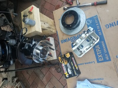

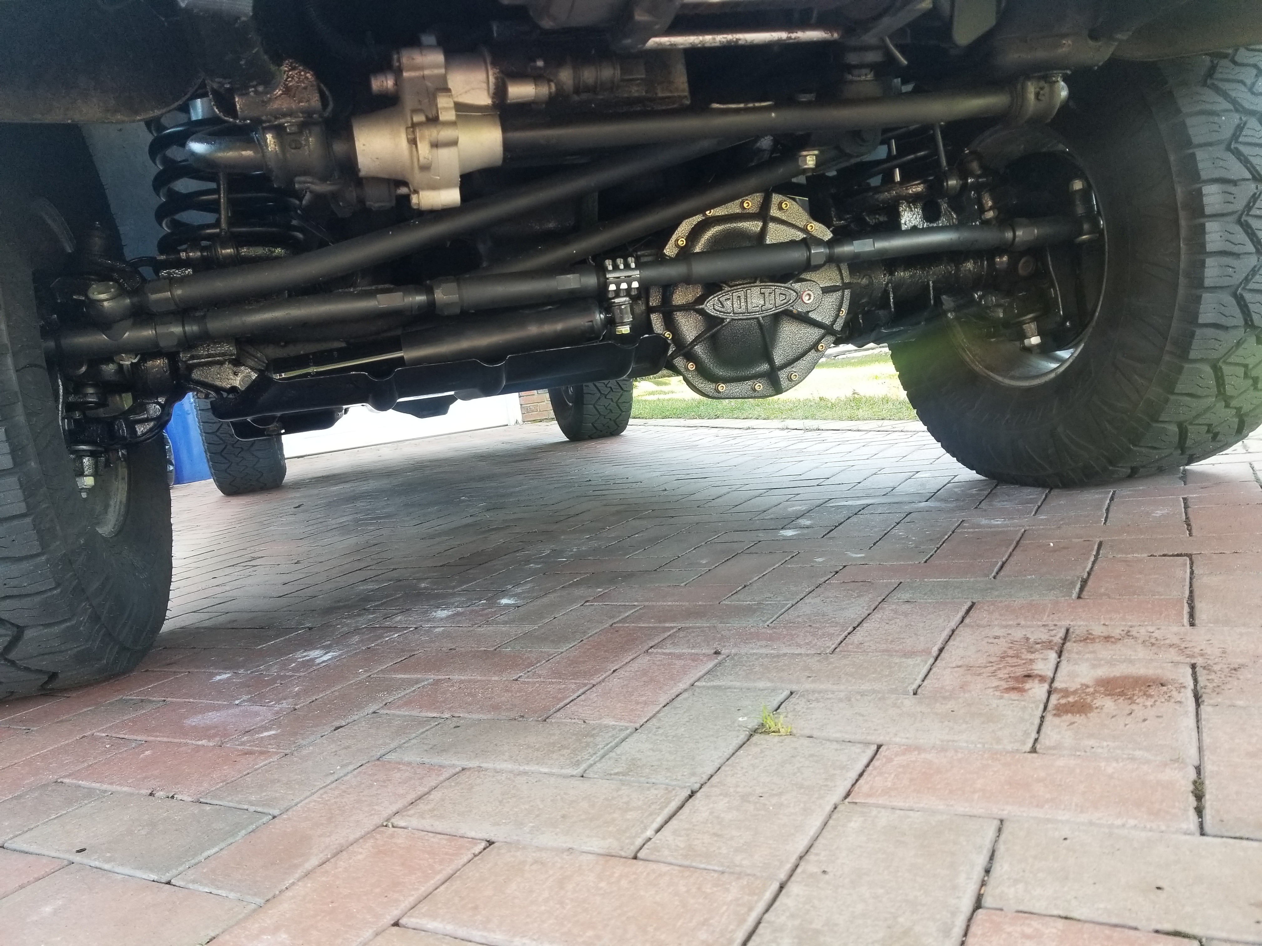

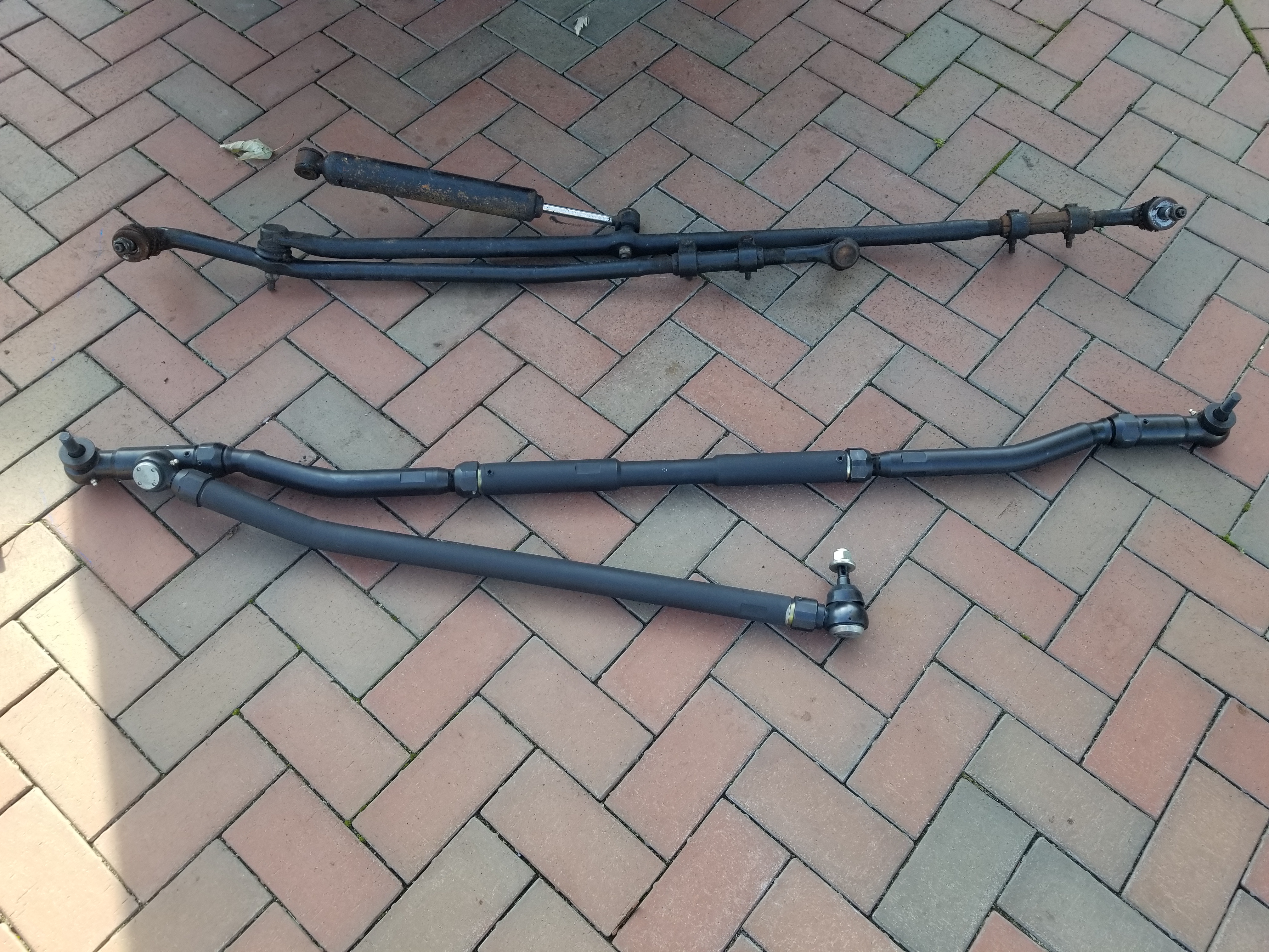

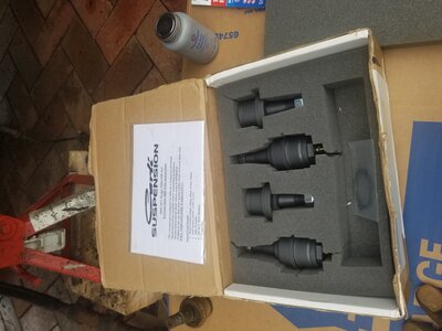

Well its been awhile....had hip replacement and shoulder surgery...just wrapped up a complete overhaul of the front end...
Re: preventive maintence
Thuren tuned Fox shocks,control arms,coils
Carli balljoints, track bar
SKF hub bearings
Spicer axle u joints
Powerstop brakes rotors
Raybestos calipers
PSC steering box
EMF Steeeing kit..and shaft washers
Mopar steering damper...steering cooler..and lines
Cleaned the diff ..put a Ductile cover and Amsoil
Now I need to take it hunting before season is over

That steering box definitely looks more beefy. May have to look into that

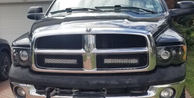

I also did the retro fit HIDs...years ago...big improvement my lenses are cloudy going to change them...i also did a write up on the mods for the fog lights..HIR.....after all this work...I went hunting on my property upstate NY..and my drivers side exhaust manifold cracked....lol..should I go....shorties or oem ?

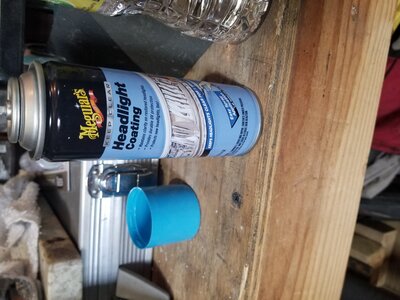

Headlight lenses got crazy cloudy....some sanding ...compound...buffing wheel...and clear coat of paint
- Posts: 5441
The stuff lasted about 18 months for me.
I used this for sanding the headlights. Add a few drops of baby shampoo to your water when wet sanding. I used the clear coat that came with this kit on the motorhome. It was so~so. For the PW, I used what you used. Seem a bit better.
