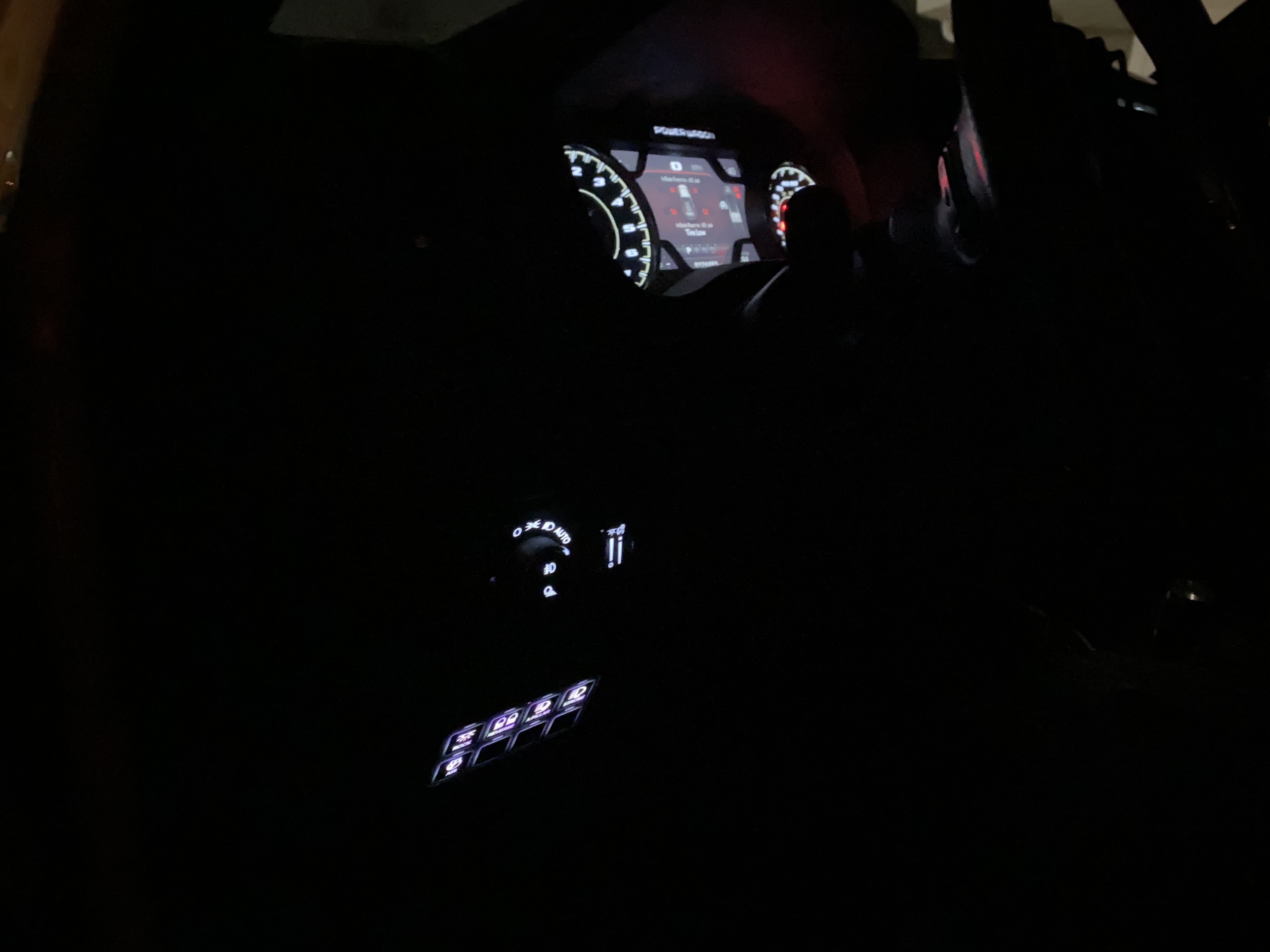

I’ll bump my own thread. I went with SwitchPros 9100. Was able to perfectly color match the backlighting to match the rest of the interior, the SQHQ panel mount is right below the headlights switch, no glare and I don’t really need to look at my switches while I’m driving.
Only the rock lights are hooked up so far. Need to make a bracket for the air compressor(under rear seat) and then finish wiring it in. I don’t have the other lights yet but wiring them in will be easy once I do!

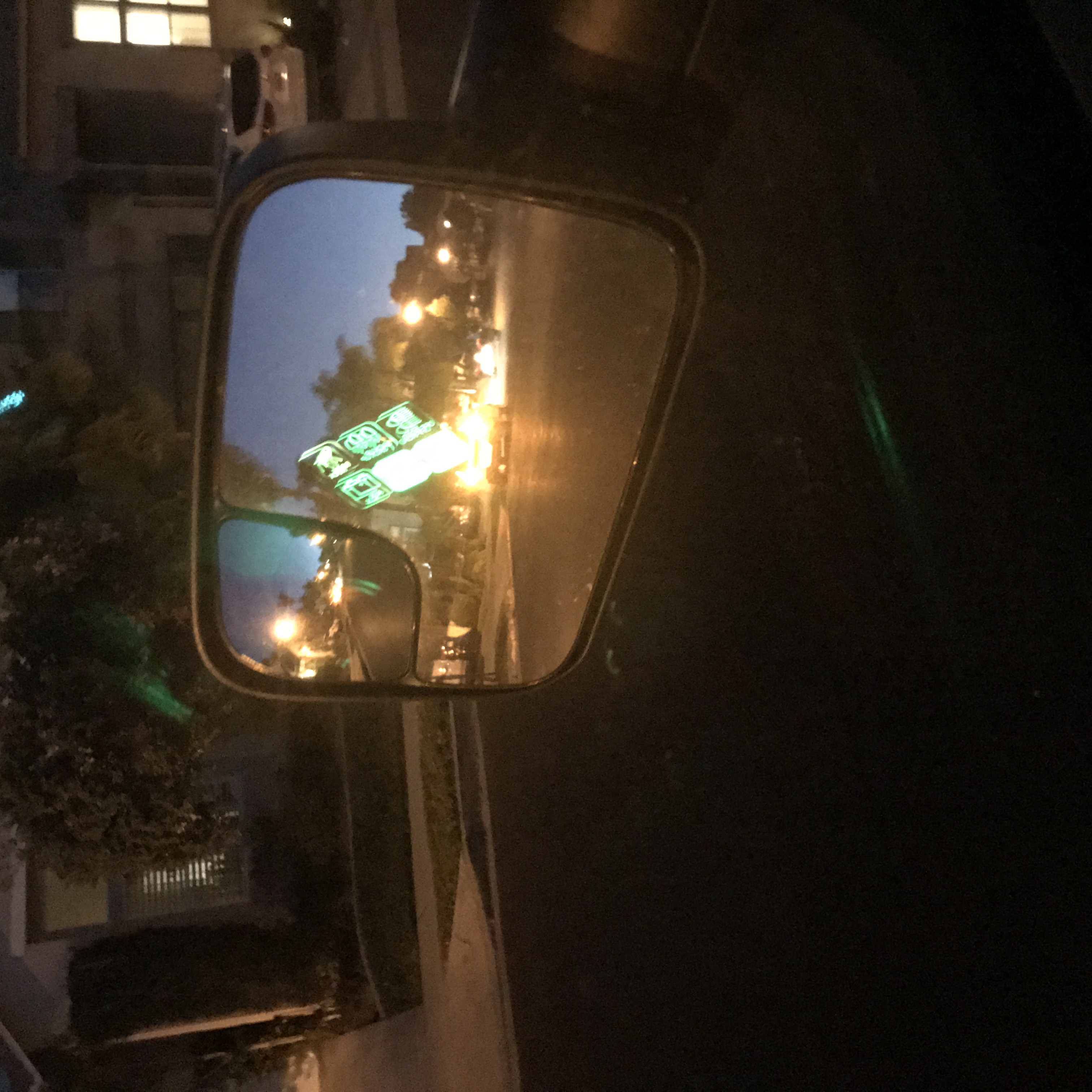

I finally decided to add some switches to my truck, I went with an inexpensive panel and remote relay/fusebox setup. The reason I chose this option is because it's compact and I like the fact that it uses traditional relays and fuses that are serviceable. The newer, more expensive units use integrated circuits that are non-serviceable, so if one mosfet dies, you have to replace the whole unit.
I used a piece of aluminum angle to mount the control box to the top of the A/C condenser fan shroud.
The switch panel fits perfectly behind the turn signal switch and I didn't have to drill any holes to mount it.
The only downside is that there's a reflection on the drivers door glass that's perfectly centered in the rearview mirror : (
The steering wheel blocks the glare at night and I've kinda gotten used to the reflection in the window. The newer version of this system offers a dimmable switch panel. My total investment was less than $70
