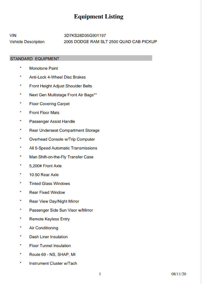

Need help. What does my PW have?
Just bought my 2005 PW this weekend and it came with nothing. No owners manual, no winch remote, no spare (no biggie), no key fob (s) or any idea if it came with one...and I basically have no idea what options it came with. My VIN is 3D7KS28D35G901197.
It's got some stuff wrong with it, luckily most items are addressed in this forum I've been engulfed in since I came aboard. ANY help you can give me would be very helpful. I have no idea if anything has been modded/replaced/upgraded. So I'm pretty lost.
Thank you in advance for your help.

Re: Need help. What does my PW have?
Post up some pictures.
Code: Select all
https://www.ramtrucks.com/webselfservice/BuildSheetServlet?vin=3D7KS28D35G901197Vehicle: 2007 Power Wagon Quad Cab - Factory Options (Inferno Red, Premium Cloth Bench Seat, Light Group, Automatic Transmission, Leather Steering Wheel)
That's weird it gave you an error. I was able to pull it up. And I'd wish I'd have waited before spending 5 bucks for the same thing.
Thanks for the information!!

And to solve the color/year debate:. I love my Power Wagon and everything about it. Even the stuff that doesn't work. I get enjoyment and satisfaction bringing something back to life and giving it some attention. I look at some of the members rides and they are amazing. I would be thrilled to own any of them. You should all be proud. I'm proud to own one...period. I do enjoy the ribbing on who's is better but they are all awesome machines!!
Oh, I thought of adding a "protester" bar on the front. Anyone know of which ones will not interfere with winch operation?
I'm sure I'll also have to get the Abel locker bypass and smart bar bypass if they're still available. But that's not a priority right now. I've got many issues to resolve. The rear brakes were "bypassed" meaning the brake line broke and was plugged with a screw and sealer and the bleeder was broken off. So easy-out it is. And some new brake line.
The exhaust is a true dual exhaust, kind of suspect attachment though, and mufflers are blown out. So putting some Thrush Welded mufflers and finishing the duals out each side behind tires.
AC clutch is bad so that will be replaced. And also the winch spooled out for about a second and stopped. No clicking at all. So off with the bumper and dropping the winch, tear down and clean, lube and reassembly is in order. Then it will be on the road.
Next is the front end ujoints need replaced. Thinking of Moog or Spicer... recommendations anyone?
I put the Carli ball joints in mine. Have 60,000 miles on they and they are still tight.
Which ever ball joints you get. DO NOT get ball joints that are splined. You will ruin the hole for the next time.
