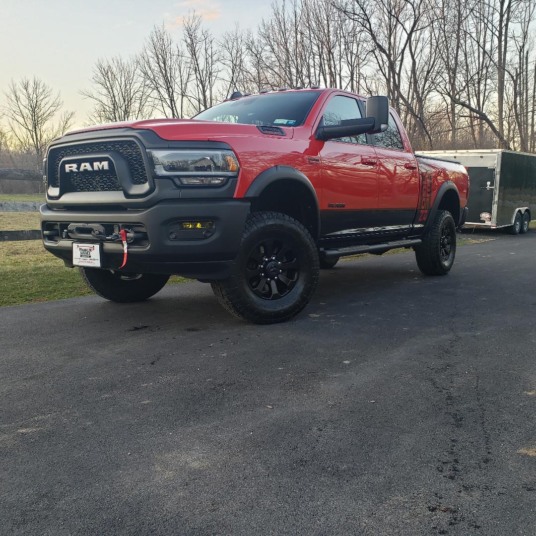

35x12.5R17 / 315/70R17 on stock wheels fit perfect, I’ve not noticed any rubbing turning or off-road. Photo of my 2019 on 315/70/17s attached.
I’ve heard 37s fit without any additional lift, but require some trimming, and you can’t fit a full size spare under the bed.

Just fit 35x12.5r17 Duratracs onto the factory wheels (I think the dealer put the 2020 black wheel on this 19 before I found it).
No rub anywhere I've been, but I haven't run it to full flex yet. Daily driving, gravel, tight turns, and slight bad road trail use has been perfect.
Also, I bent the heat shield a bit and fit a brand new ProComp 315/70r17 Xtreme MT2 on the factory spare wheel under the truck. Its inflated to 20 PSI, but I'll be damned if I could flex it at all anyway as it's a thick tire. I'll try again at 30lbs when the weather warms up. It tucks up nice and slightly higher than the bottom of the receiver hitch without issue. I'll run 3 safety cables around the tire to the frame etc in the event the factory tire winch cable breaks, but they will be easily cut with wire cutters should I need the tire.
I'm going to do more mods and physically move the heat shield and re-run a smaller exhaust tighter to the passenger side of the truck to improve clearance, but for no ti works just fine.
