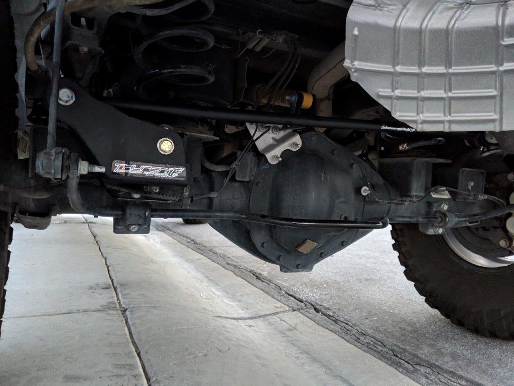

Re: EasyDoesIt's Build - 2018 Power Wagon "White Rhino"
Installed the Thuren Rear Trackbar this afternoon, pretty straight forward after you understand how all the brackets fit in.
The first test to see if the trackbar was worth the money is on my trip to the airport in the morning, I usually get an intermittent rear shimmy at highway speeds.
Should get the front springs installed in March.

Thanks Marcus. The truck seems to behave better at high speeds.DamageWagon wrote: ↑Mon Feb 25, 2019 1:27 amSweet man!!
FYI When you do the front springs don’t forget to disconnect the locker plug on the axle.
Good call on the locker plug.
