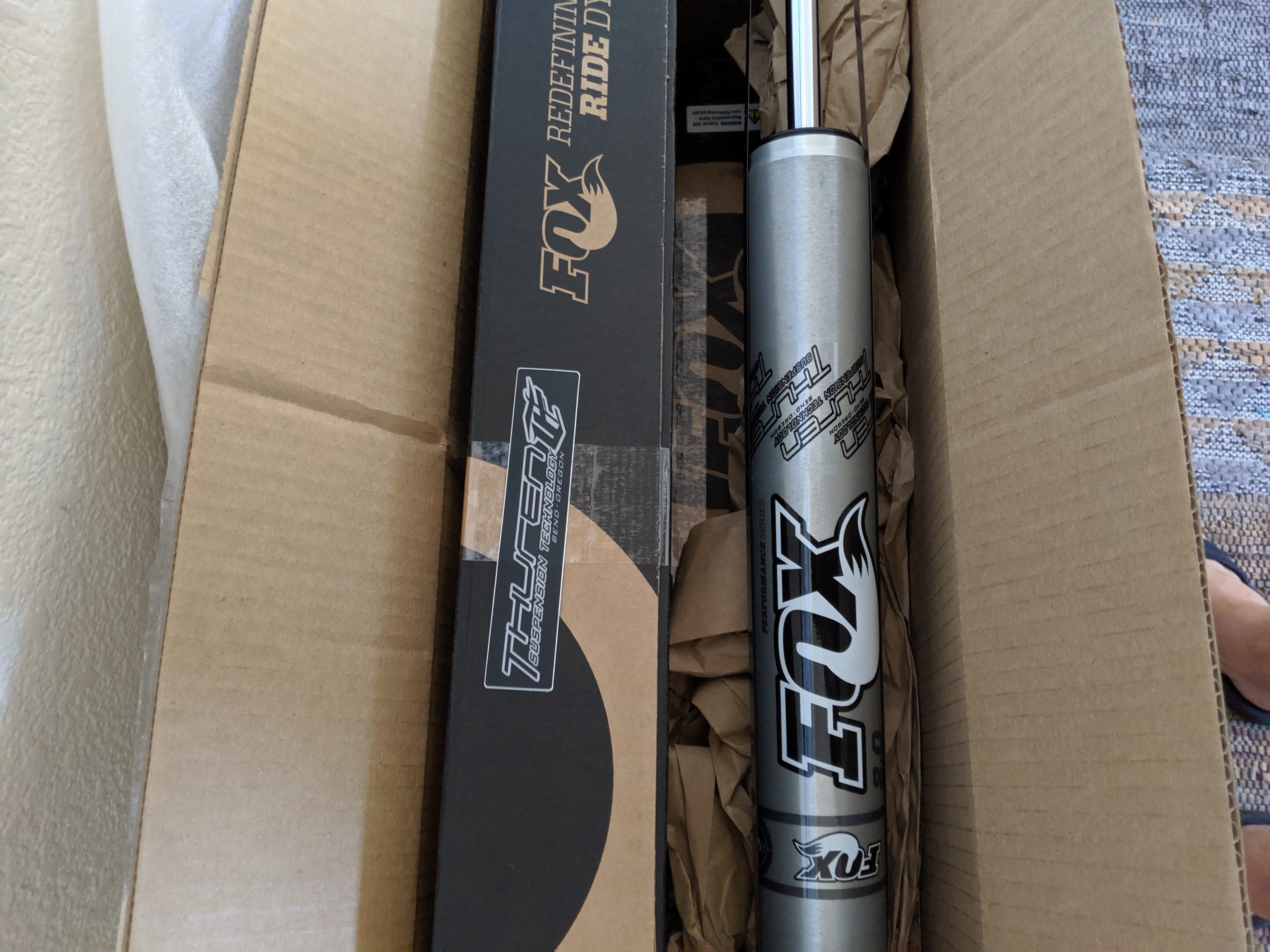

I've officially ordered Thuren 1.5" lift front springs, rear track bar, and Dethloff skid (Thanks Marcus).
Stayed tuned for install details
