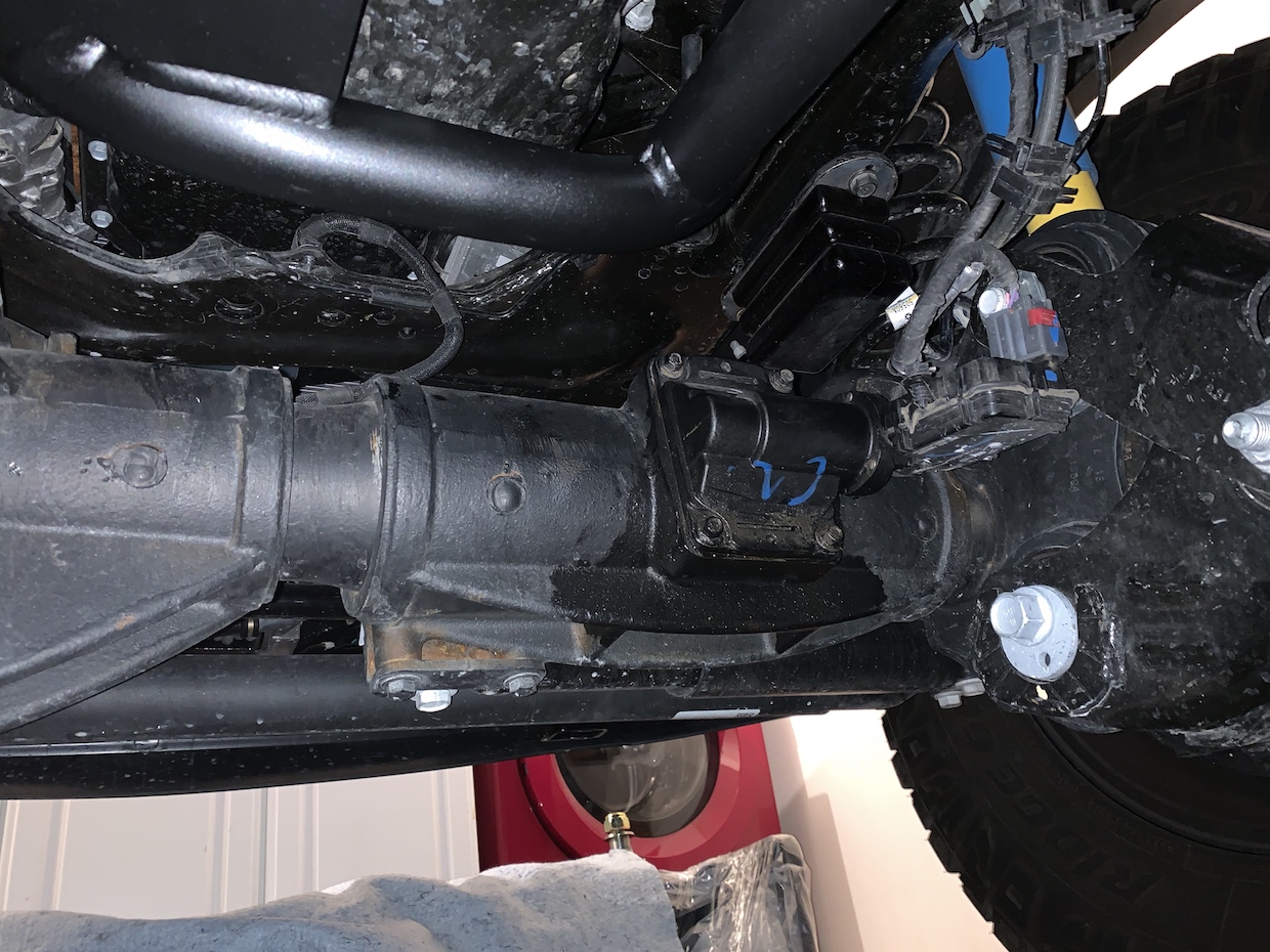

2018. 5k miles. Was under the truck installing the Dethloff skid plate (really nice product!) and noticed a leak. Does anyone have any information about this part. I'm a new convert from a Tundra and still learning the different systems on the RAM. Thanks.

CAD. (Axle disconnect) I've never had one leak there. I don't think it's even supposed to have diff fluid in that section. Been a while, but I always thought it was dry.

CAD alright. Looks like the actuator housing seal or housing is leaking. Assume it's under warranty, take it to dealer and get it fixed.

why didnt you determine what kind of fluid it was ? seems easy enough. diagnosing a leak is the same regardless of vehicle type
hard to tell from the photo. could be coolant or maybe engine oil from above. i dont believe theres supposed to be gear oil near the cad so if its gear oil you have a inner tube seal bad

The oil filter is right above that area. Recent oil change? I let the dealer do the 1st oil change on my '16. Drove it 300 miles to my cabin and found an oil spot in the gravel the next day when I moved the truck. Filter was loose, could spin it with two fingers and thumb.

If that smells like gear oil it would be a leaking axle seal inboard if the CAD collar.
The engine oil filter and the oil/coolant heat exchanger are above that area, check those as well.

The axle seal is outboard of the CAD housing. This looks like gear oil to me.

Check your transmission lines as well. I had a leak on that side that turned out to be ATF. It was weeping at the joint between the hard line and soft line.

I noticed it late last night when I went back out to torque the Dethloff fasteners. Quick finger-it and sniff-it test excluded AF. I cleaned it up. Checked it this morning after drive to work with no leak. Whatever it is it is slow. I’ll do root-cause inspection and post up after work. Will not be going to the dealer unless absolutley neccessary. Thanks for all the good input!!

I’ve had axle seals leak and then seal back up with no good explanation. Possibly due to some deep water crossings we did. Been running the same deals for several years since then with no new leaks and several oil changes. I wouldn’t be surprised if it just went away. I’m not the only one that’s had this same experience.

Light/slow weep from bottom of CAD housing to axle housing seal. Picture in original post is 5000+ miles. Research revealed it is wet behind the cover... earlier models look like an easy actuator housing gasket replacement. Late model part looks like the gasket is "built into" the $300 actuator. I'm going to monitor and maybe end up taking it in. Anyone do the by-pass? Hate going to the dealer. Usually, after the sale, they never see me again. Ever.

i would of thought the seal was inboard of the cad but maybe not. while i do have a service manual, ive never needed to look at the front axle pages. ram couldnt be stupid enough to not have some kind of replacable paper or oring seal. then again, the dummies made the thermo housing with no replacable oring . so nothing suprises me any more

It used to be on the old trucks with the vacuum CAD. The front tubes were dry on those.
My 07 doesn't have a CAD and I have not had to pull an axle on the newer trucks.
AS for the bypass, I don't think anyone makes a one piece shaft for the new trucks. I checked back when I bought my 16 but have not looked since.

the new trucks have a rubber gasket molded into the cad actuator housing ?

Maybe replaceable O-ring. I haven't been able to find anything other than the complete unit. Might have to pop it off when I get a chance and see it up close...

you would think there is a simple replaceable oring but that goes against any common sense. part diagrams dont show any oring that i could see. if its removable you might get it matched up at a hose and rubber shop
