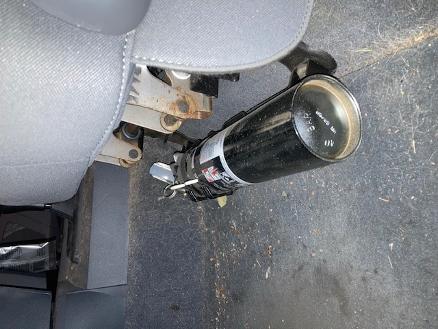

Mule inspired me a few months ago to install one. This is a 2.5 lb halotron from H3R Performance. I was going to install a dry chemical on the passenger side but lost interest due to the PITA install.
Yeah my floor is dirty so what? Yes that is yellow Labrador hair, it's everywhere.
