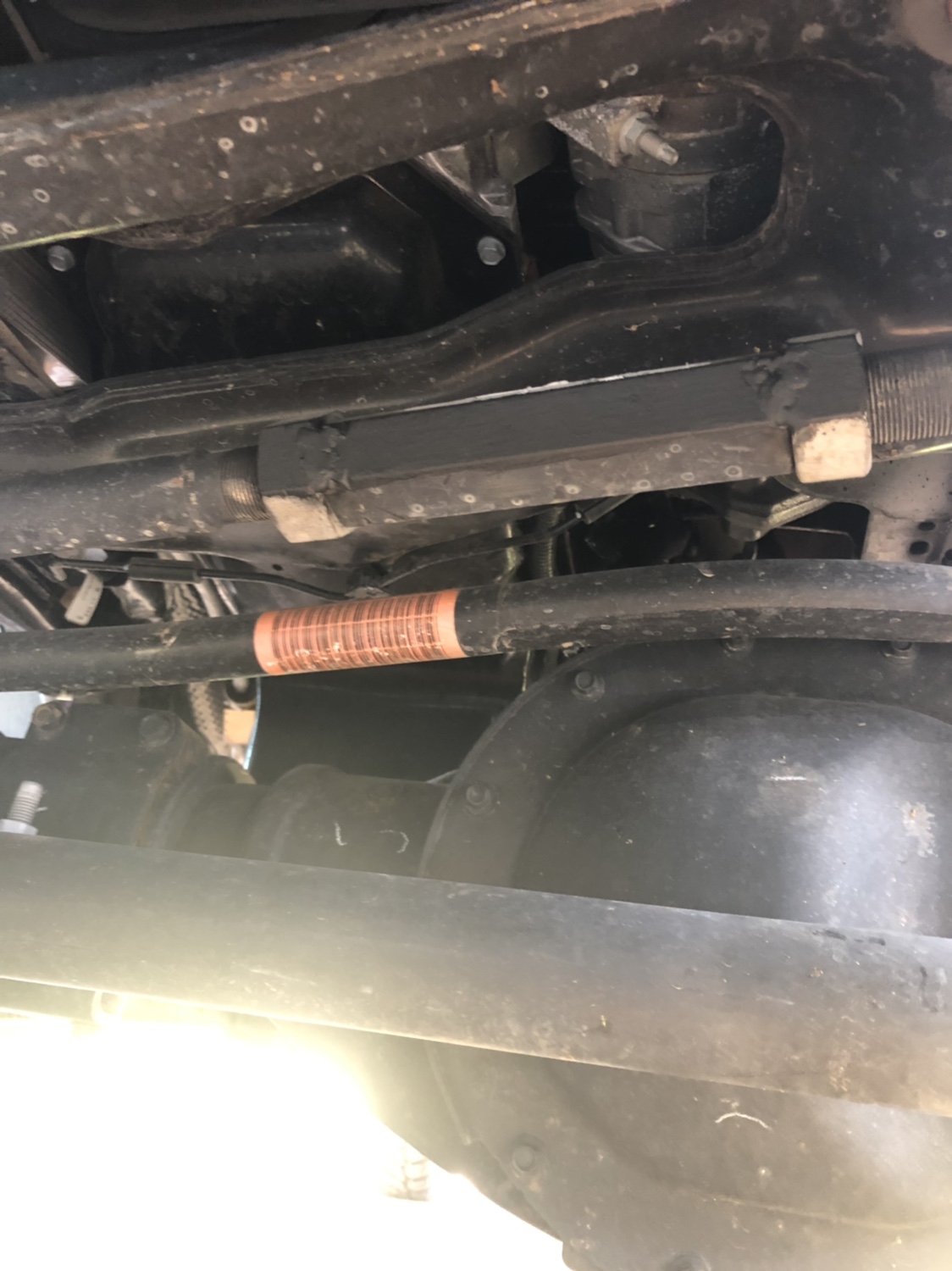

Interesting conversation. I was looking DOR drag link to replace the OE link with the latest recall out on it. Haven't taken it in for the recall yet. I'm leery about the recall fix, assuming all is good, to weld the jam nuts. Doesn't make sense and no longer able to center steering wheel when needed. I guess it is a tac weld so it can be ground off if adjustment is needed.
- Posts: 311
- Location: Albuquerque
Re: EMF steering linkage?
Nope. It’s a continuous weld around the nuts to the center unit. I suspect it’s going to need a new drag link to adjust it.SeppW wrote: ↑Thu May 30, 2019 8:19 pmInteresting conversation. I was looking DOR drag link to replace the OE link with the latest recall out on it. Haven't taken it in for the recall yet. I'm leery about the recall fix, assuming all is good, to weld the jam nuts. Doesn't make sense and no longer able to center steering wheel when needed. I guess it is a tac weld so it can be ground off if adjustment is needed.
Not the case with this guys drag link “repair”. I cant tell if its bubblegum, jb weld or an actual weld.
Regardless, what a joke.
