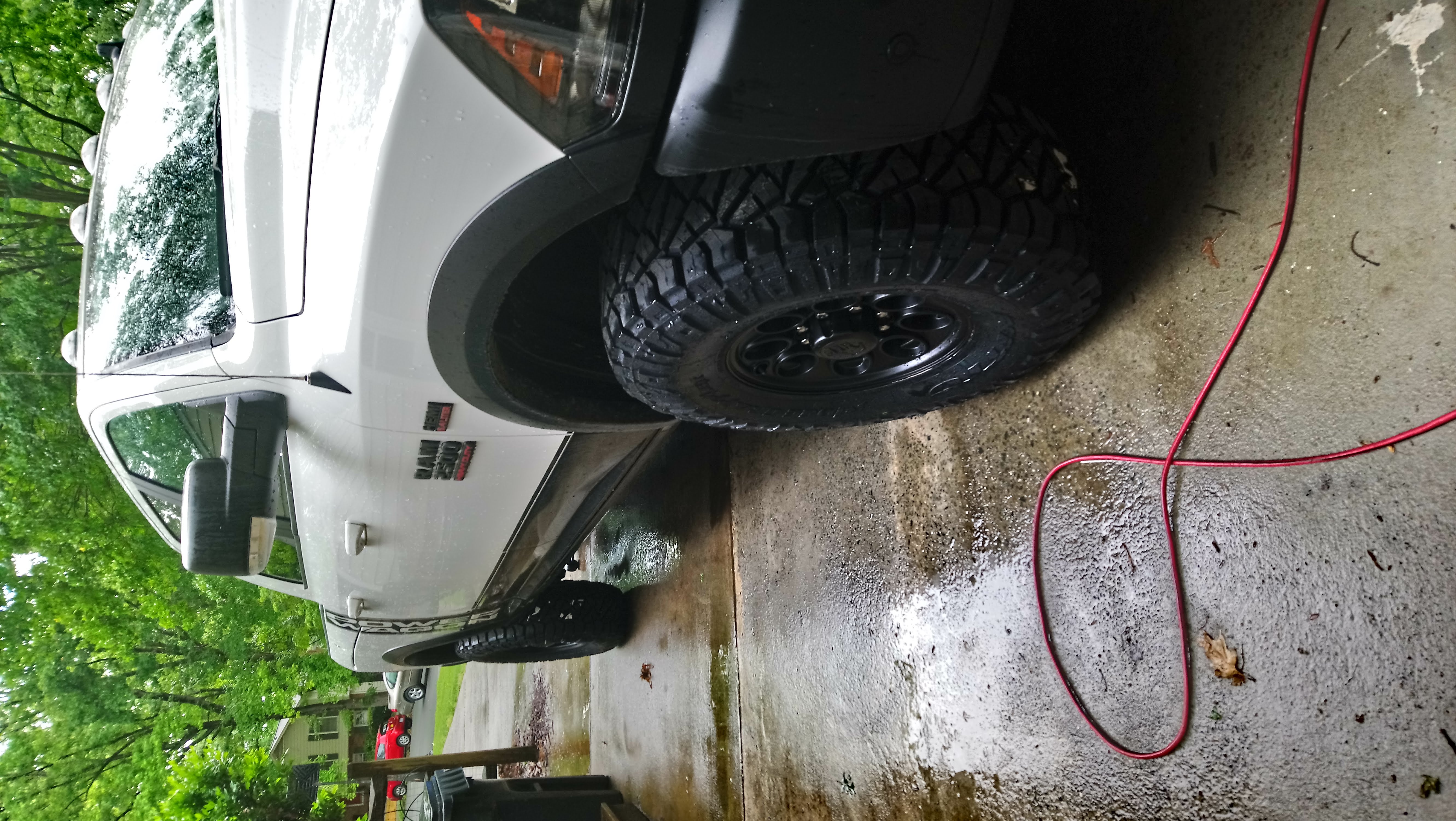

Been pretty bad about checking the forum. I ended up going with the Nitto Ridge Grapplers. They're on the truck, but with a little drama. I was able to get the TPMS and shift points calibrated, but the weights used by the shop that balanced them ended up rubbing on the brake caliper. In their defense, the amount of clearance between the wheel and caliper is insanely narrow. I'll probably end up trying to resolve the issue with some internal balancing medium.
Here's some before and after:
Before
After

Alrighty. Added as attachments. Took a few tries and a few of the attachments show as "no longer available," but I think the ones that worked give the general gist of it.
Anyone else have the issue with the weights on the AEV wheels?

It's a tight fit between any 17" wheel and the brake calipers. Your shop should be using the thin stick on weight and being careful about where they put them. If those Nittos need a lot of weight to balance, you might have issues.
My tape weights routinely get scrubbed off when offroading and mud/gravel gets in between the wheel and caliper.
Re: Torq's Build - 2017 RAM Power Wagon (Nickname Undecided)
The weights would have to be really damn skinny. If we can't make the weights work, I might try something like this:Low_Sky wrote: ↑Sat May 11, 2019 10:50 amIt's a tight fit between any 17" wheel and the brake calipers. Your shop should be using the thin stick on weight and being careful about where they put them. If those Nittos need a lot of weight to balance, you might have issues.

Got the wheels back. Moved the weights to the outside of the wheel and don't have anymore issues.
No I have to figure out the rubbing. Seems to rub around 3/4 lock, but only there. So I'm looking at some dremmel magic, or something more expensive like a Thuren lift (and I'm not sure the lift would fix the issue.

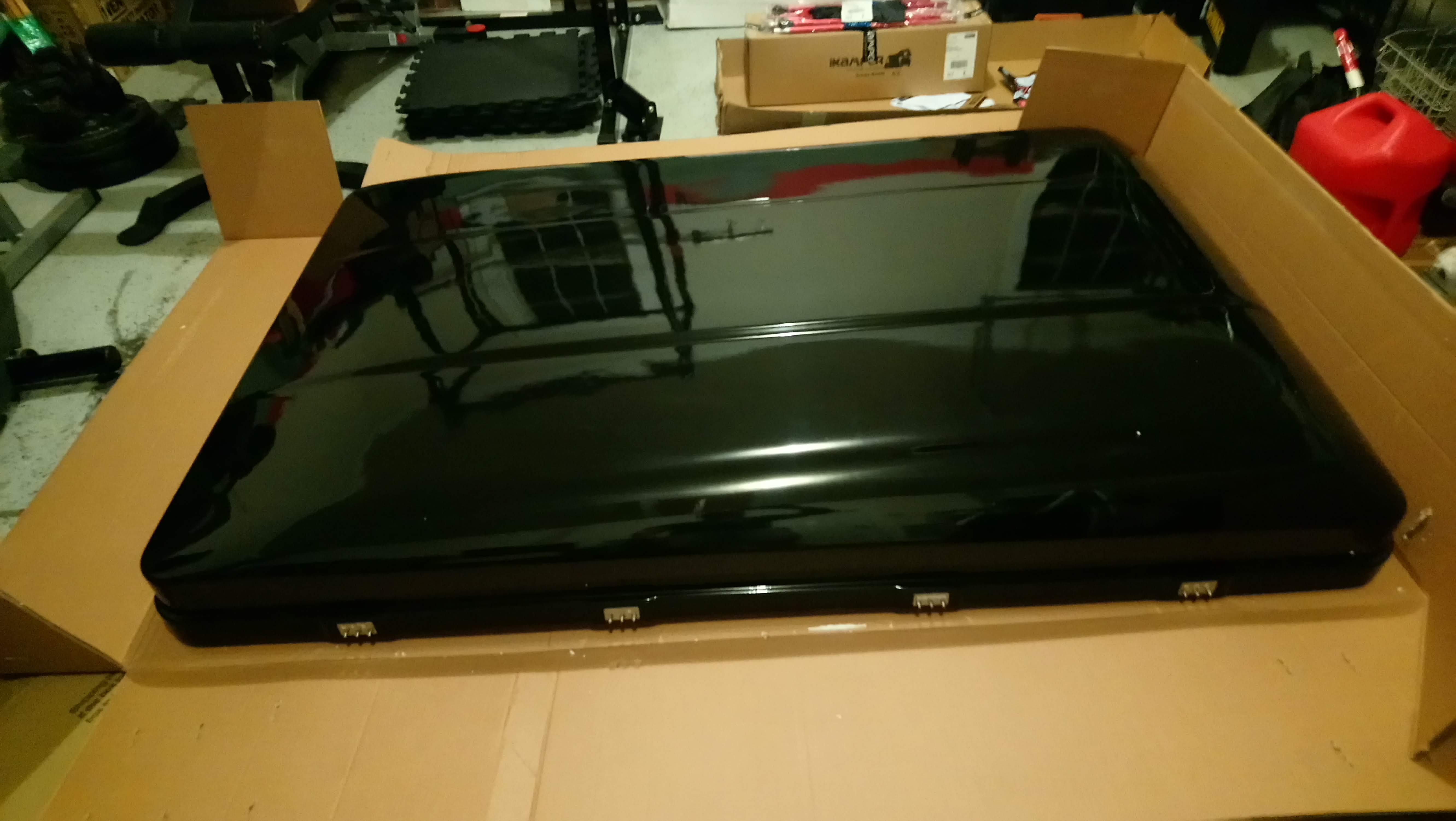

Frontrunner bed rack installation is complete (pictures tomorrow when the lighting is better. It was a bit of a bear getting it centered, but I'm in business.
Here are some preview pics of the rack assembly and the tent unwrapped.

That tent packaging is hilarious! Damn that’s effective!!
