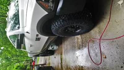

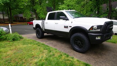

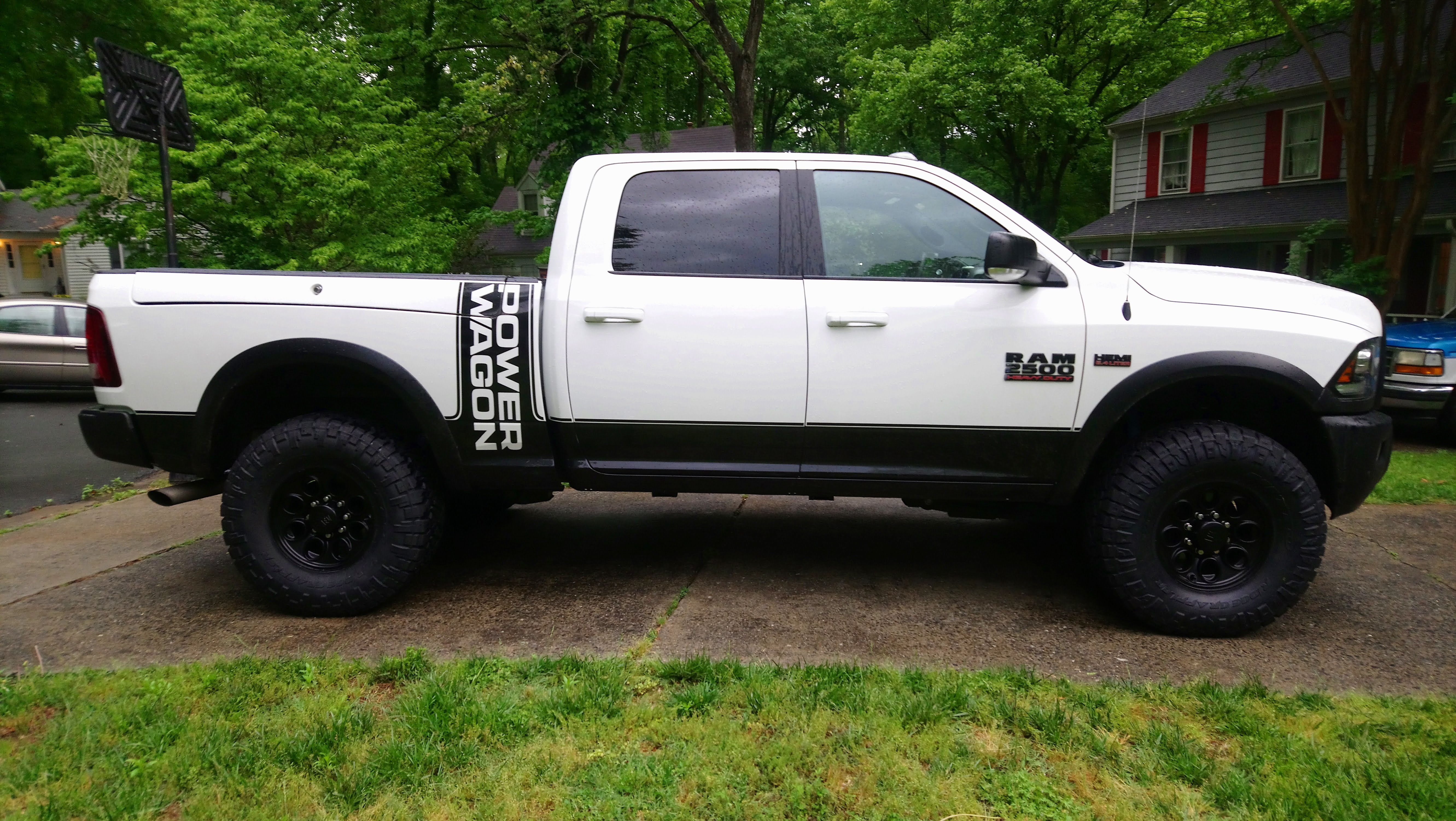

Been pretty bad about checking the forum. I ended up going with the Nitto Ridge Grapplers. They're on the truck, but with a little drama. I was able to get the TPMS and shift points calibrated, but the weights used by the shop that balanced them ended up rubbing on the brake caliper. In their defense, the amount of clearance between the wheel and caliper is insanely narrow. I'll probably end up trying to resolve the issue with some internal balancing medium.
Here's some before and after:
Before
After

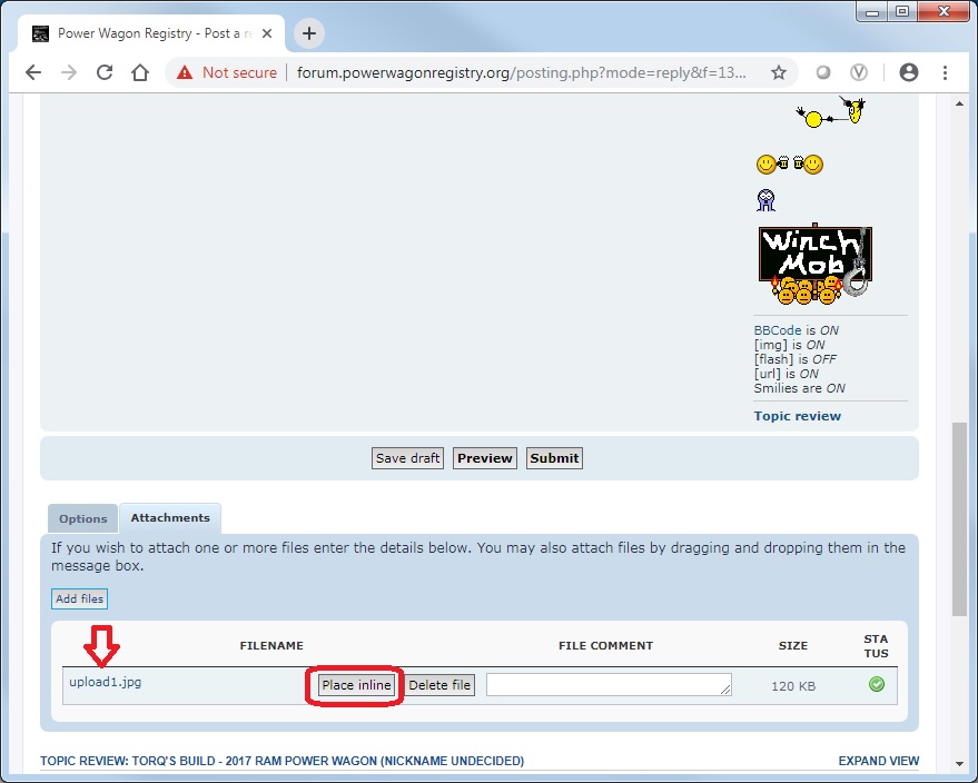

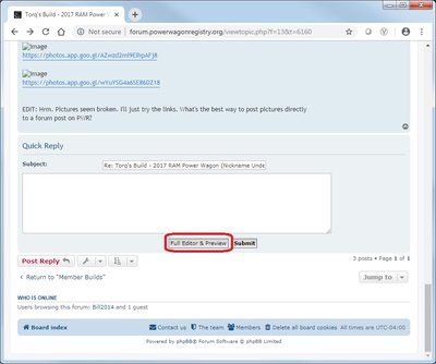

EDIT 1: Hrm. Pictures seem broken. I'll just try the links. What's the best way to post pictures directly to a forum post on PWR?
EDIT 2: Thanks for all the advice! Uploaded pictures.
Re: Torq's Build - 2017 RAM Power Wagon (Nickname Undecided)
If you are using a browser, select "Full Editor and Preview"
Select the "Attachments" tab and then "Add files"
Browse for the picture(s) you want and then select "Place inline"
And your post will look something like this one...

Alrighty.  Added as attachments.  Took a few tries and a few of the attachments show as "no longer available," but I think the ones that worked give the general gist of it.
Anyone else have the issue with the weights on the AEV wheels?

It's a tight fit between any 17" wheel and the brake calipers.  Your shop should be using the thin stick on weight and being careful about where they put them.  If those Nittos need a lot of weight to balance, you might have issues.
My tape weights routinely get scrubbed off when offroading and mud/gravel gets in between the wheel and caliper.
The weights would have to be really damn skinny. If we can't make the weights work, I might try something like this:Low_Sky wrote: ↑Sat May 11, 2019 10:50 amIt's a tight fit between any 17" wheel and the brake calipers. Your shop should be using the thin stick on weight and being careful about where they put them. If those Nittos need a lot of weight to balance, you might have issues.

Got the wheels back.  Moved the weights to the outside of the wheel and don't have anymore issues.

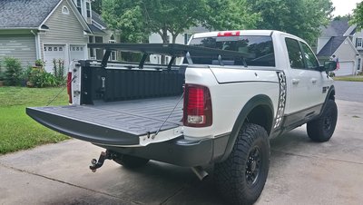

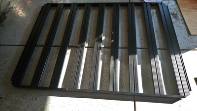

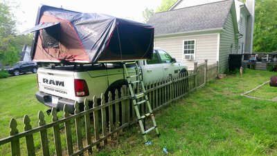

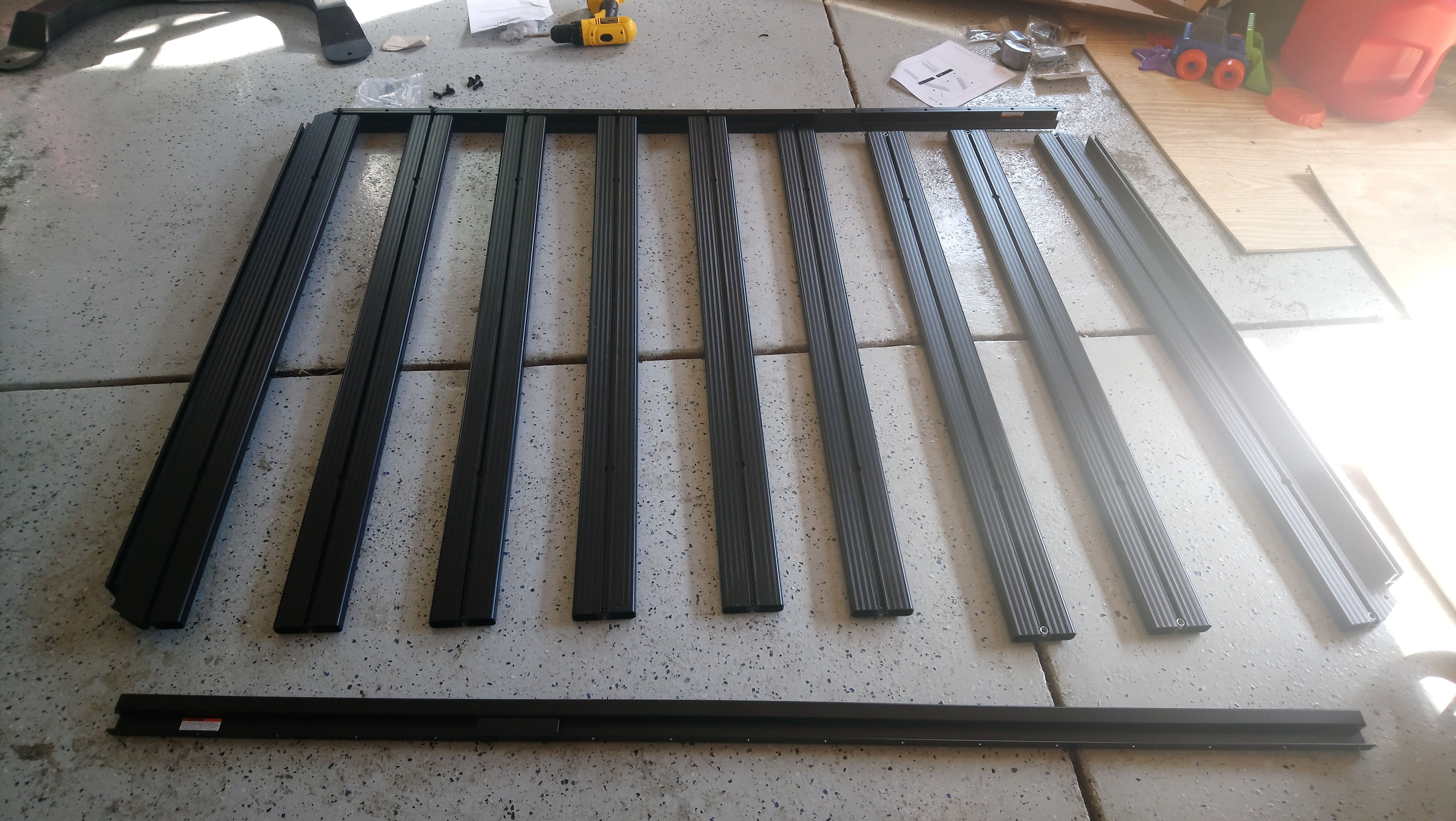

Frontrunner bed rack installation is complete (pictures tomorrow when the lighting is better.  It was a bit of a bear getting it centered, but I'm in business.
Here are some preview pics of the rack assembly and the tent unwrapped.

Oh yeah...twice. Discount tire jacked up my brand new wheels this way but made it right by refunding the full price of a 35 inch Toyo MT. The solution is to put the weights toward the inboard edge of the wheel. Was told they won’t balance as well this way but it’s worked fine for the last 10K.Torq wrote:Anyone else have the issue with the weights on the AEV wheels?

That tent packaging is hilarious! Damn that’s effective!!

Yup - that's exactly what we ended up doing and I was told the same thing. I've only got ~500 miles since balancing, but I'll report back if there are any issues.Punishher7 wrote: ↑Thu May 30, 2019 1:02 amOh yeah...twice. Discount tire jacked up my brand new wheels this way but made it right by refunding the full price of a 35 inch Toyo MT. The solution is to put the weights toward the inboard edge of the wheel. Was told they won’t balance as well this way but it’s worked fine for the last 10K.Torq wrote:Anyone else have the issue with the weights on the AEV wheels?

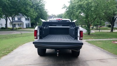

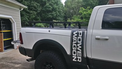

Bed rack installed:
...and RAM boxes open:
The real test is whether or not the RAM boxes will hit the tent once I get it mounted.

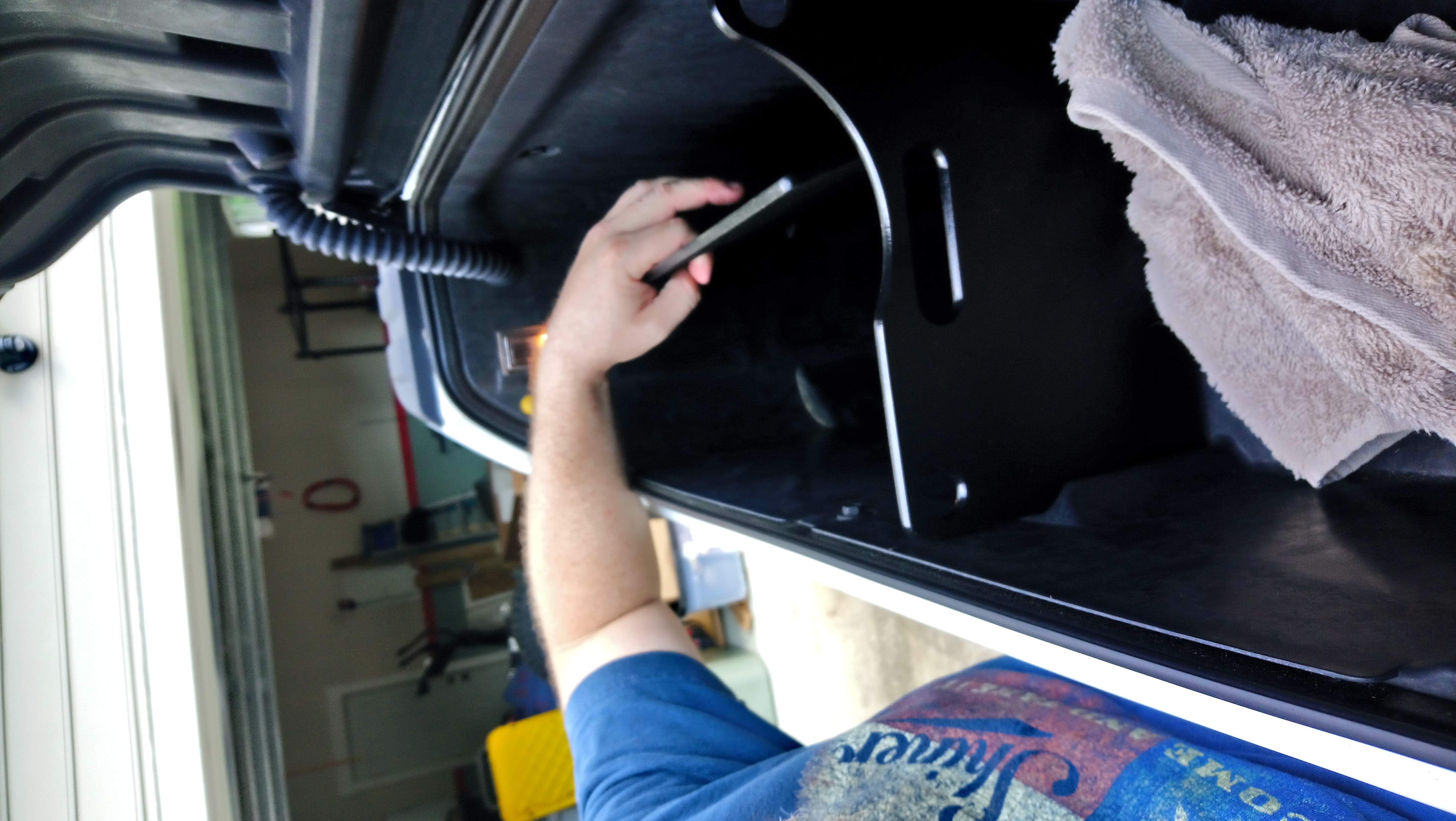

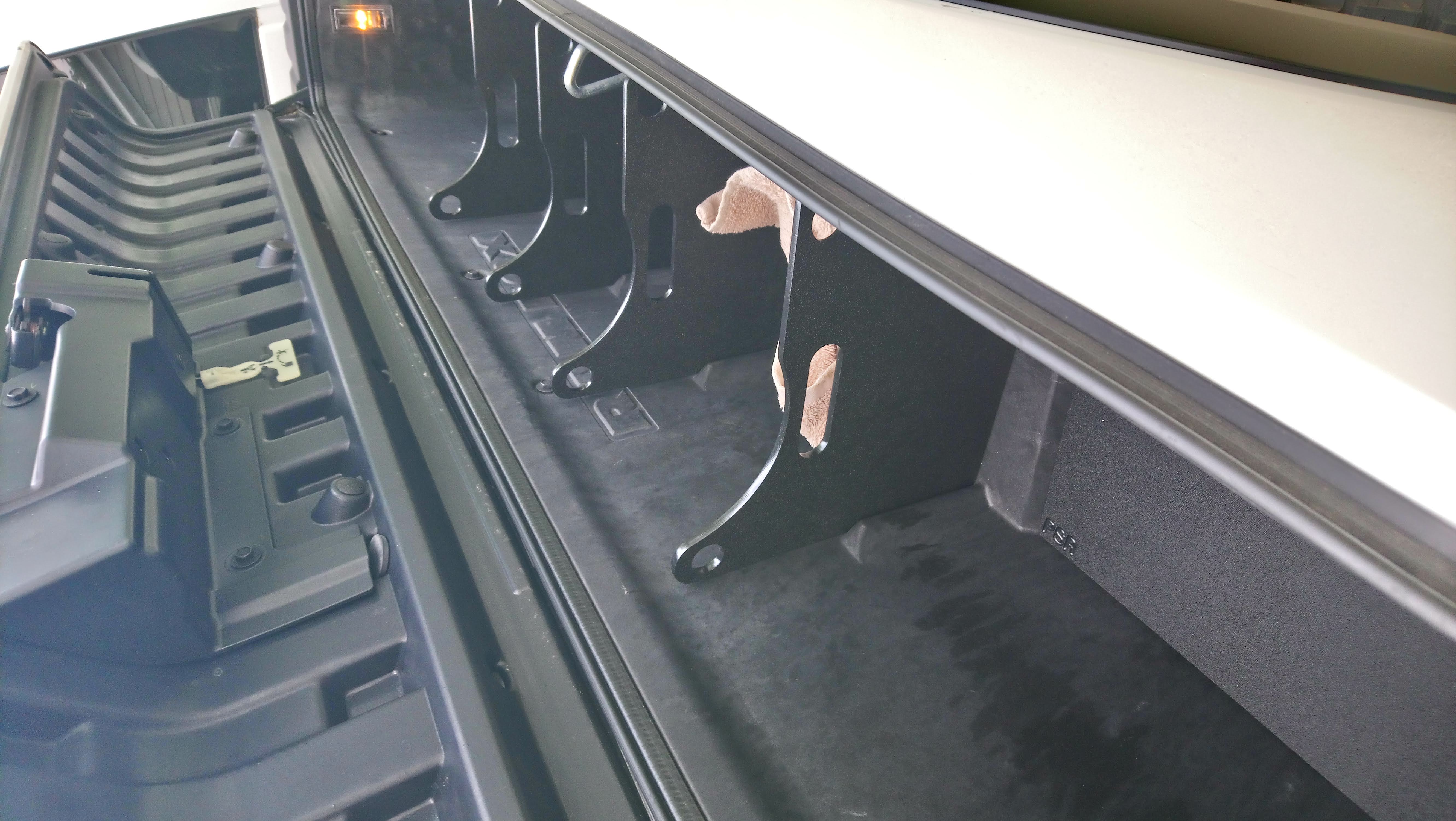

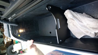

Easy mod, but I get more compartments.  Who doesn't love more compartments.  The RAM box divider kit:
Nice! So is that rack only going to bear on the accessory rails?
That's the claim by Frontrunner. It makes sense though. I think because of the geometry of the rack mounts, the load on the rack is pushing out AND down to increase the load rating.DamageWagon wrote: ↑Thu May 30, 2019 5:57 pmNice! So is that rack only going to bear on the accessory rails?
The dynamic load will only be a RTT and a camping table. I'd guess around 175-190 lbs. With me, wife, and kid, add 360-375 lbs. for the static load.
Sounds steep for brackets rated for 250lbs, might keep an eye on the rivers holding those rails in. It’s probably feasible if needed to remove the ramboxes and drill the rivers and add a reinforcement inside if it’s needed down the road.
Thanks for the rating - wasn't sure what it was. Is that 250 lbs per side, or 250 lbs total?DamageWagon wrote: ↑Thu May 30, 2019 6:17 pmSounds steep for brackets rated for 250lbs, might keep an eye on the rivers holding those rails in. It’s probably feasible if needed to remove the ramboxes and drill the rivers and add a reinforcement inside if it’s needed down the road.
