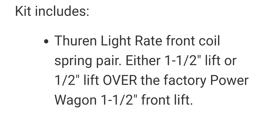

I am a little confused by the way this reads. I am looking just to level out my Power Wagon. Does that mean I want the 1.5"? I'm guessing so.... It just reads wierd to me.
Or does that mean 1.5" or 2" lift?

its 1.5 inch over factory 2500s but only .5 inch over a factory powerwagon

Got ya. So will that 1/2" really level out my Power Wagon?
And they give you the option to chose 1-1/2 or 1/2 in a drop down box when ordering?

2014+ Power Wagon 1-1/2" Front Lift will level you. At least it did for me.

PWJouster wrote:its 1.5 inch over factory 2500s but only .5 inch over a factory powerwagon
Wrong.
Don’s Hemi springs are 2” and 3” over a normal 2500 gasser. Accounting for the Power Wagon factory lift and weight of the winch, they net 0.5” and 1.5” on a Power Wagon.
Re: Thuren from leveling kit
Post by Low_Sky » Tue Mar 19, 2019 10:34 am
txjfrosty wrote:I am a little confused by the way this reads. I am looking just to level out my Power Wagon. Does that mean I want the 1.5"? I'm guessing so.... It just reads wierd to me.
If you want level, get the 1.5” springs. Just be warned, that’s going to be LEVEL. Put any significant weight in the back and the truck is going to sit nose high like a SoCal bro dozer.
1.5” front springs and a 1” rear coil spacer is a popular combo for those looking to gain that extra inch of ground clearance but also keep a little bit of forward rake.
Im not sure whats so confusing about that. It plainly states what lift height your going to achieve.

Low_Sky wrote:
Tue Mar 19, 2019 10:30 am
Wrong.
What's confusing is that they are both the same coils, Don has a separate section for the PW. We often confuse people talking about the standard vs the PW.
So a 3-inch lift coil on a standard Hemi is the same as the 1.5 for the PW, but both are the same coil. So it's pretty easy to get this mixed up.
But, most people think their PW is magical. Guys ask all the time why they can't find a PW specific spacer, not realizing it's the same. Or god forbid the trucks. "They don't have 2018 listed" - hey dummies, nothing is different. Maybe they haven't listed it yet. Duh. :doh:
:rant:

So "Either 1-1/2" lift or 1/2" lift OVER the factory Power Wagon 1-1/2" front lift." doesn't sound ambiguous to you? It did to me, until it was thoroughly explained.
But thank you for that awesome bit of help...
I saw you had several replies that stated the same thing that you quoted from thurens site, otherwise I would have elaborated.
However, after I read what you quoted from me I realize that was quite a douche response. As much as it sounds like I was being an asshole, it absolutely was not my intention. Everybody interperits things differently... I was just simply stating that I thought Thuren did a perfect job explaining it... but again, that did nothing for the thread.
Get the 1.5” springs if you want it level, get the .5” springs if you want a rake :cheers:

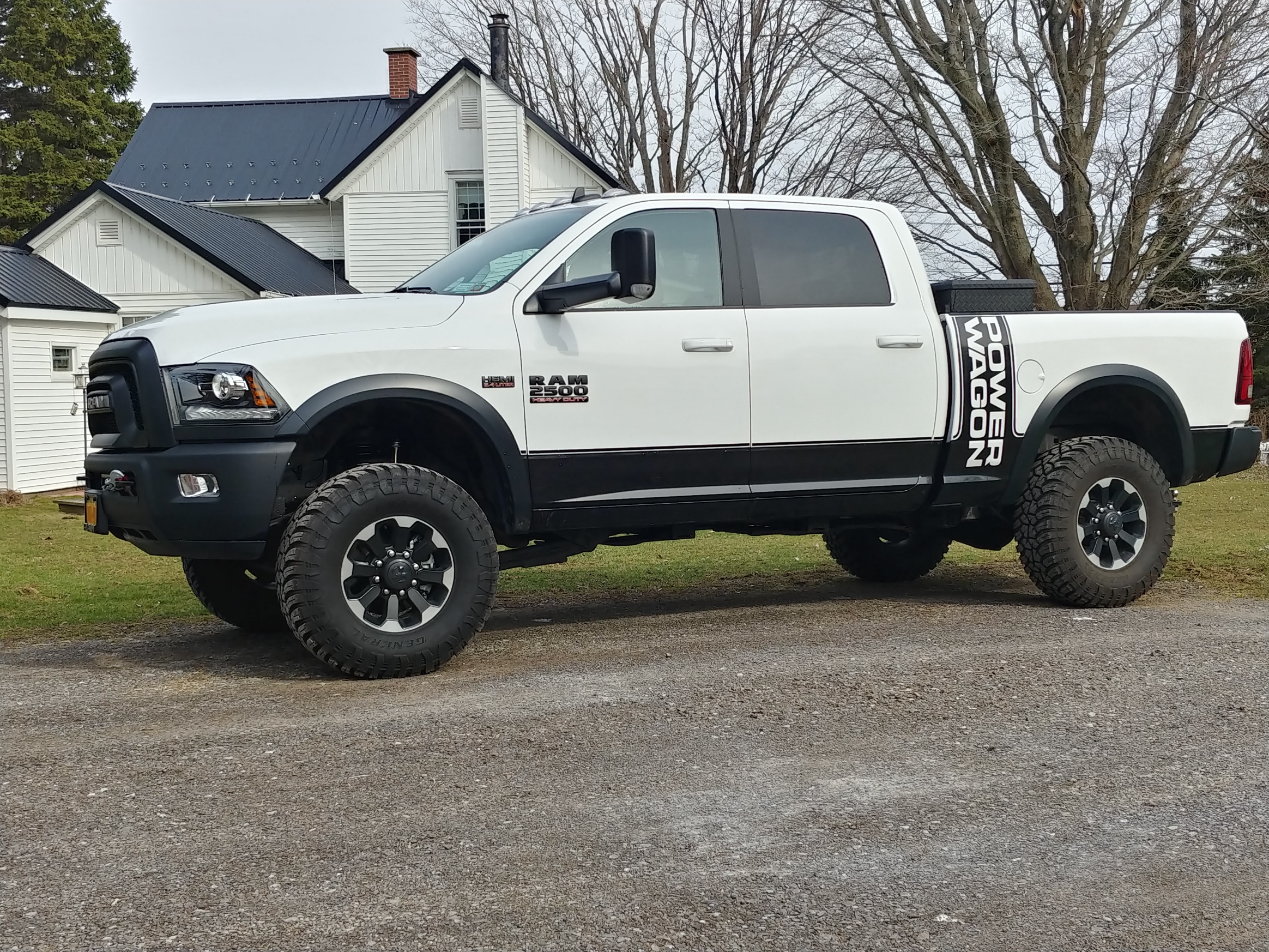

Post by txjfrosty » Thu Apr 04, 2019 5:54 pm
All levelled out... looks great! :rockon:
Re: Thuren front leveling kit
Post by OffroadTreks » Thu Apr 04, 2019 8:00 pm
Sweet trailer.
Post by olyelr » Tue Apr 30, 2019 9:43 am
So did you do just the front, or the rear too?
txjfrosty
Posts: 24
Joined: Thu Mar 07, 2019 9:28 pm
Post by txjfrosty » Tue May 07, 2019 8:43 pm
Just the front.
