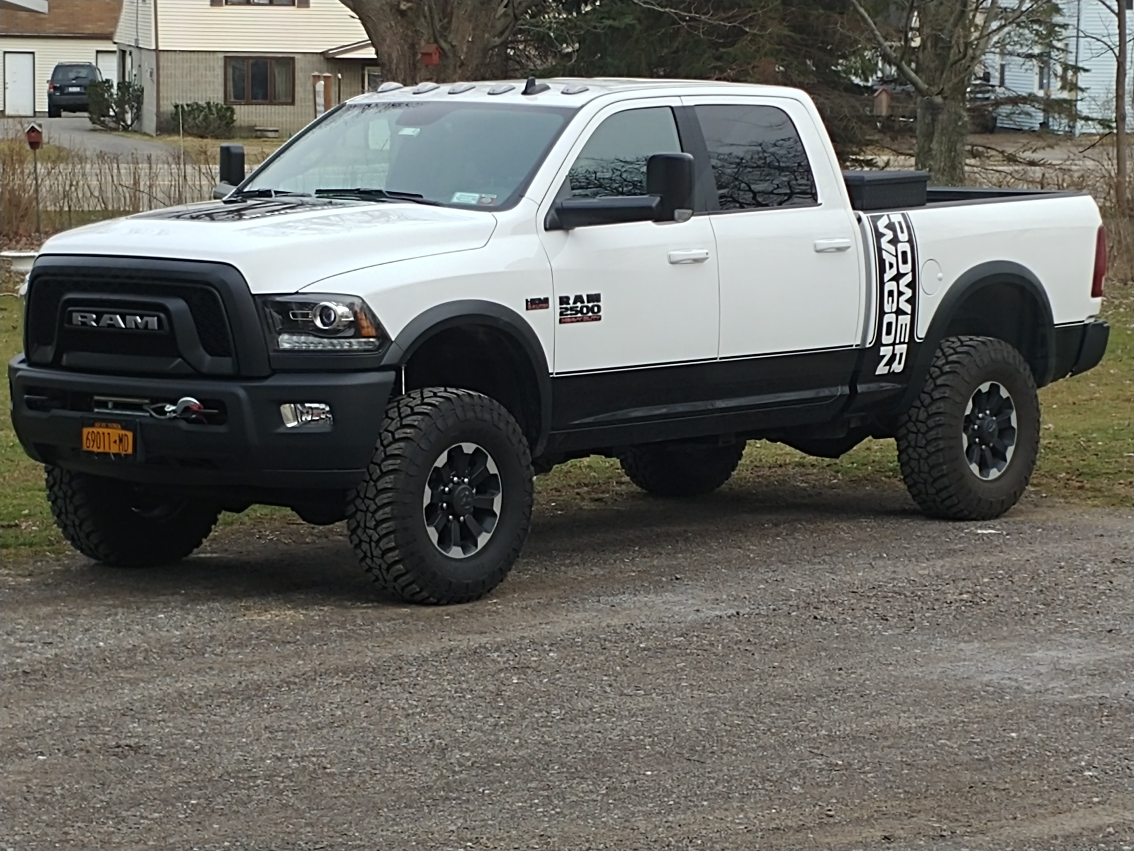

Planning to order up the kit this weekend. So hopefully I can get it installed in a week or two. I'll post up some pics after.
olyelr wrote: ↑Tue Mar 19, 2019 9:57 pmI saw you had several replies that stated the same thing that you quoted from thurens site, otherwise I would have elaborated.
However, after I read what you quoted from me I realize that was quite a douche response. As much as it sounds like I was being an asshole, it absolutely was not my intention. Everybody interperits things differently... I was just simply stating that I thought Thuren did a perfect job explaining it... but again, that did nothing for the thread.
Get the 1.5” springs if you want it level, get the .5” springs if you want a rake![]()
And post up pikchurz when your done!!!!!!
Re: Thuren front leveling kit
All levelled out... looks great!
Sweet trailer.
So did you do just the front, or the rear too?
Just the front.
