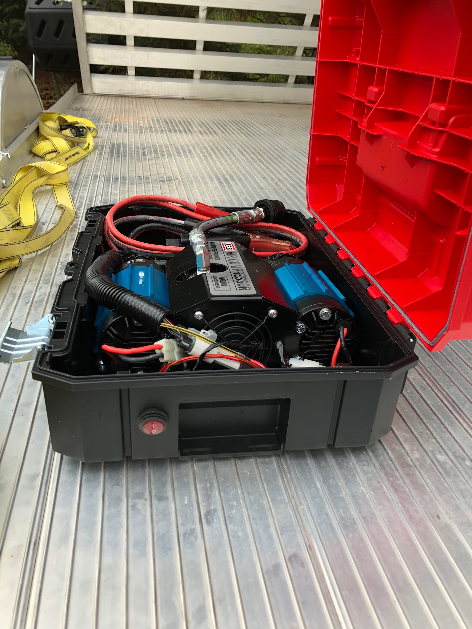

								by olyelr » Wed Feb 20, 2019 4:48 pm
			BoldAdventure wrote: ↑Wed Feb 20, 2019 1:35 pm
For the price you pay, if you're not doing an onboard air setup with a big tank, I'd say go buy two Viair 300p or the 400p
https://amzn.to/2Xf1rNZ
You can buy two for less than the ARB twin unit and do two tires at once.
But, I wonder if an arb twin would fill a tire twice as fast as one of those? Which would result in less “stuff” to pack.
Tanks are good and all for quick punches for air tools and horns and such, but once they are empty then its back to relying on the compressors output. I dont really see the benefit of a tank for just filling tires.

								by OffroadTreks » Wed Feb 20, 2019 5:03 pm
			One pump per tire, quick connects next to each tire and a control system It's going to be faster than anything else.

								by 16PW » Wed Feb 20, 2019 5:10 pm
			[/quote]
[/quote]
Looking at the output numbers, it should just about save half the time with a twin compared to a 440p which is Viairs strongest portable. I watched a test comparing the single and twin ARB. The single is equivalent to the 440p numbers wise. The Twin filled up a 35 from 15-32psi in 1:14 which was about a whole minute faster than the single ARB. I definitely don't need a tank as this will only be for tires and the less crap the better. I'm already just about out of storage in the cab.

			How about dual Viair compressors of some sort hooked up to a 5+ gallon tank? Seems like the OBA setups only come with 2.5 gallon tanks max. I'm wondering if the larger tank like 5 gallon would be beneficial for airing up all 4 tires from 20psi-40/35 quickly.
A 5 gallon tank like this design could work where the spare used to be. Slim enough so it won't hang down.
https://www.amazon.com/Vixen-Air-Gallon ... s=air+tank

			Marcus is the engineer, and I can't calculate the volume of a tire. I tried and failed to get a correct number.
But I do know the volume of a 2.5 gallon tank is 577.5 cubic inches but I can't grasp Boyles Law. But point being, I think you can caculate how much air tank you need for all four tires.
The problem is, I think these tanks are usually good for one or two tires before the Air compressor kicks back on.

								by Low_Sky » Thu Feb 21, 2019 3:32 pm
			16PW wrote:How about dual Viair compressors of some sort hooked up to a 5+ gallon tank? Seems like the OBA setups only come with 2.5 gallon tanks max. I'm wondering if the larger tank like 5 gallon would be beneficial for airing up all 4 tires from 20psi-40/35 quickly.
After the tank is exhausted (a 2.5 gal tank typically only speeds up the first tire), you’re filling straight off the compressor.
Tanks aren’t for filling tires. They’re for running air lockers, air brakes, air tools, etc. Short duration, high flow/pressure or constant pressure applications that most compressors just can’t keep up with.

			Dang guys, was doing some research, I think I found something better than the ARBTwin at a GREAT VALUE if you wanted to copy my method of 1 per tire.
VIAIR 444C 200 PSI Dual Value Pack $289.95 & FREE Shipping - $579.90 so just a touch more than the ARBTwin but you will have 4 compressors putting out 3.53 CFM free flow at 0 psi.
Fill rate: 2.5 Gallon Tank 0 to 200 PSI 2 minutes and 30 seconds, 5 Gallon air tank 0 to 200PSI in 5 minutes and 30 seconds.

								by Low_Sky » Fri Feb 22, 2019 9:54 pm
			BoldAdventure wrote:Dang guys, was doing some research, I think I found something better than the ARBTwin at a GREAT VALUE if you wanted to copy my method of 1 per tire.
I am very very tempted to replace my setup. I dunno if these old compressor are worth anything at this point to try to get some money of of them. I gotta think about this.
The flow rate charts for Viair’s dual packs are for both compressors running. I compared the charts for the 450C single and dual pack.
Four 444Cs still put out more air than the ARB twin, but not massively more. ~1.75 SCFM @0 psi per compressor.
