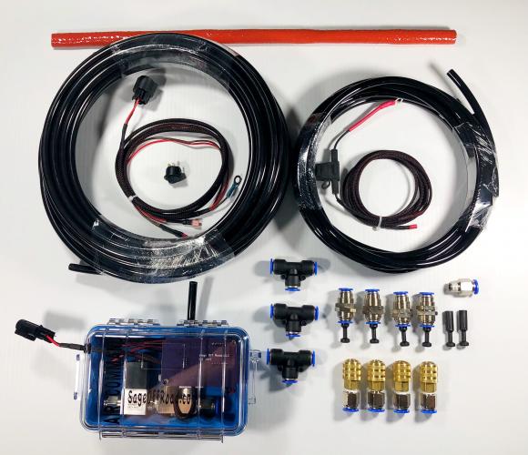

Post by OffroadTreks » Wed Feb 20, 2019 5:03 pm
One pump per tire, quick connects next to each tire and a control system It's going to be faster than anything else.
Are you going to use that app? I just saw a video on that today. Bad ass setup!
