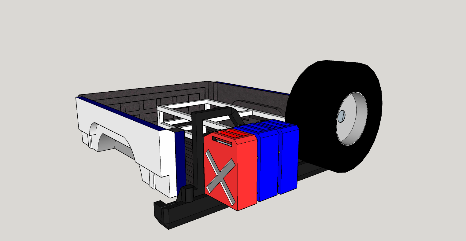

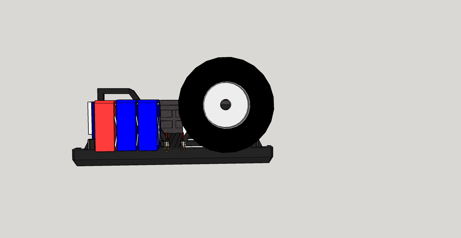

Post by TommyG » Sun Feb 17, 2019 9:02 am
DamageWagon wrote:
Sat Feb 16, 2019 7:50 pm
I see swingout carriers taken so lightly on these trucks. Do not take them as a cure-all. Guys running swingouts on these trucks are running 37” or larger tires, and with how capable these trucks are, especially with the bolt on suspension options, you could shear the swingout carrier off in a heartbeat. There is not a good mounting method to put a swingout on these trucks without some serious time spent figuring it out. Frame spacing and tail light to tailgate location do not make it easy. I do not think swingout carriers are the golden solution they look like on the surface in this application.
I agree it needs to be well thought out. I have seen swingouts, tire mounts and entire bumpers laying on the ground or bouncing down the highway. It is one of the reasons I have never home brewed one or had a local shop build one up. There has to be a way to do it and do it right though don't you think? I had my own all planned out then chickened out over worrying about losing a 37 off the back going down the interstate. Double shear mounts and very short arms for the swingouts, etc, etc.
I would trust Thuren to think it through and not just add swing outs as an afterthought since they are into the gofast stuff.
