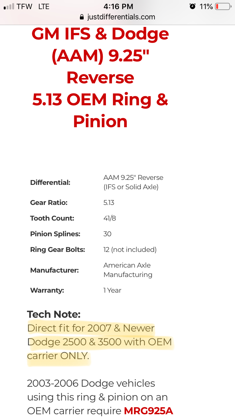

Post by benking » Sun Feb 24, 2019 3:56 pm
ramv wrote:
Sun Dec 16, 2018 5:25 pm
So, if I read this right, would this be a direct fit, no spacer for our trucks (other than early 3G)
https://www.justdifferentials.com/AAM-9 ... 13r-oe.htm
I thought the same thing. What does this tech note mean, if this isn’t the right gear...?
Re: Gears?
Post by Reloaderguy » Sun Feb 24, 2019 5:26 pm
Different carriers have different ring gear flange locations. I believe 3.42 or 3.73 is the cutoff. Your carrier is correct for those gears.
