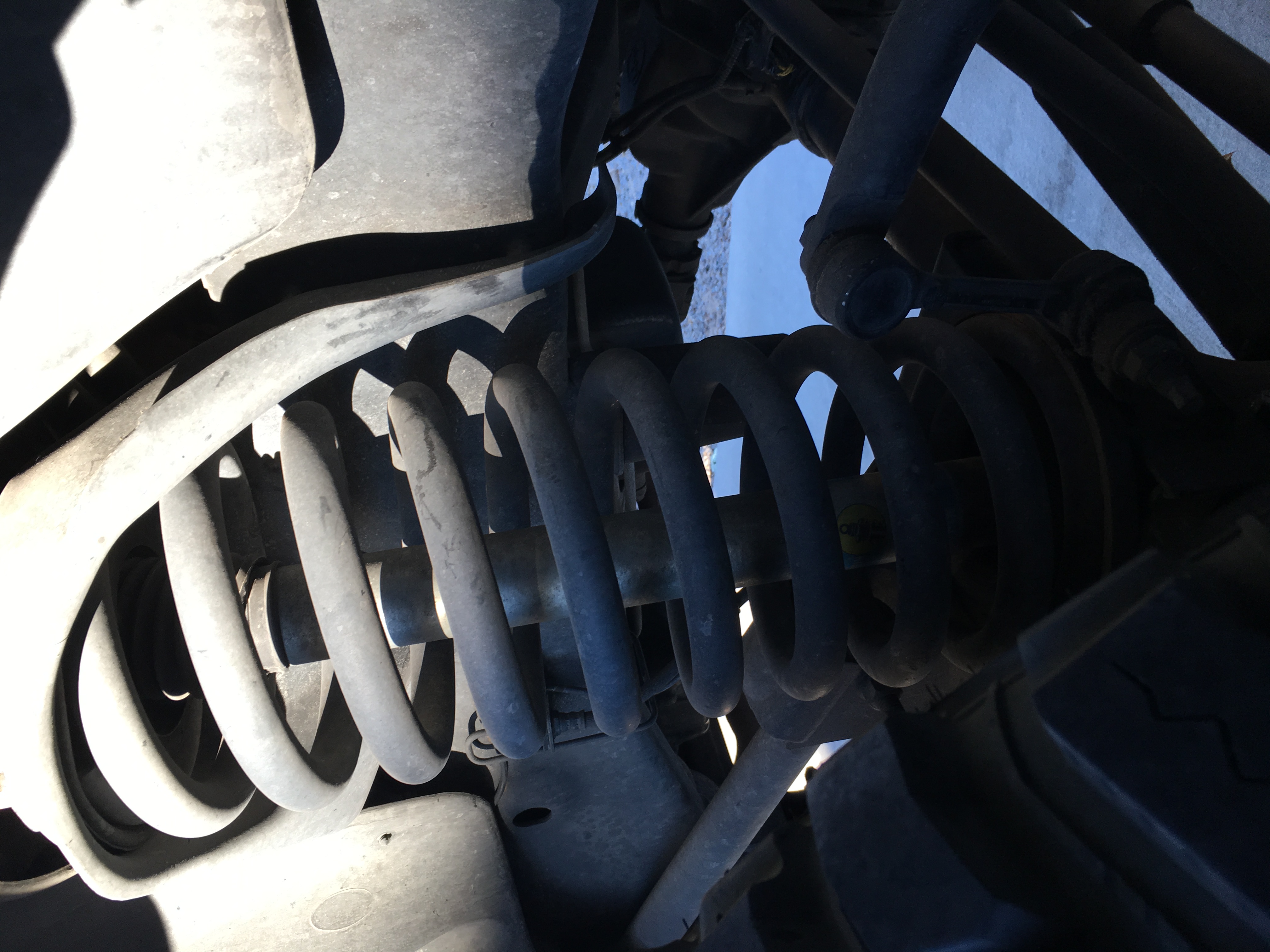

Can you take a picture of the front springs and control arms.

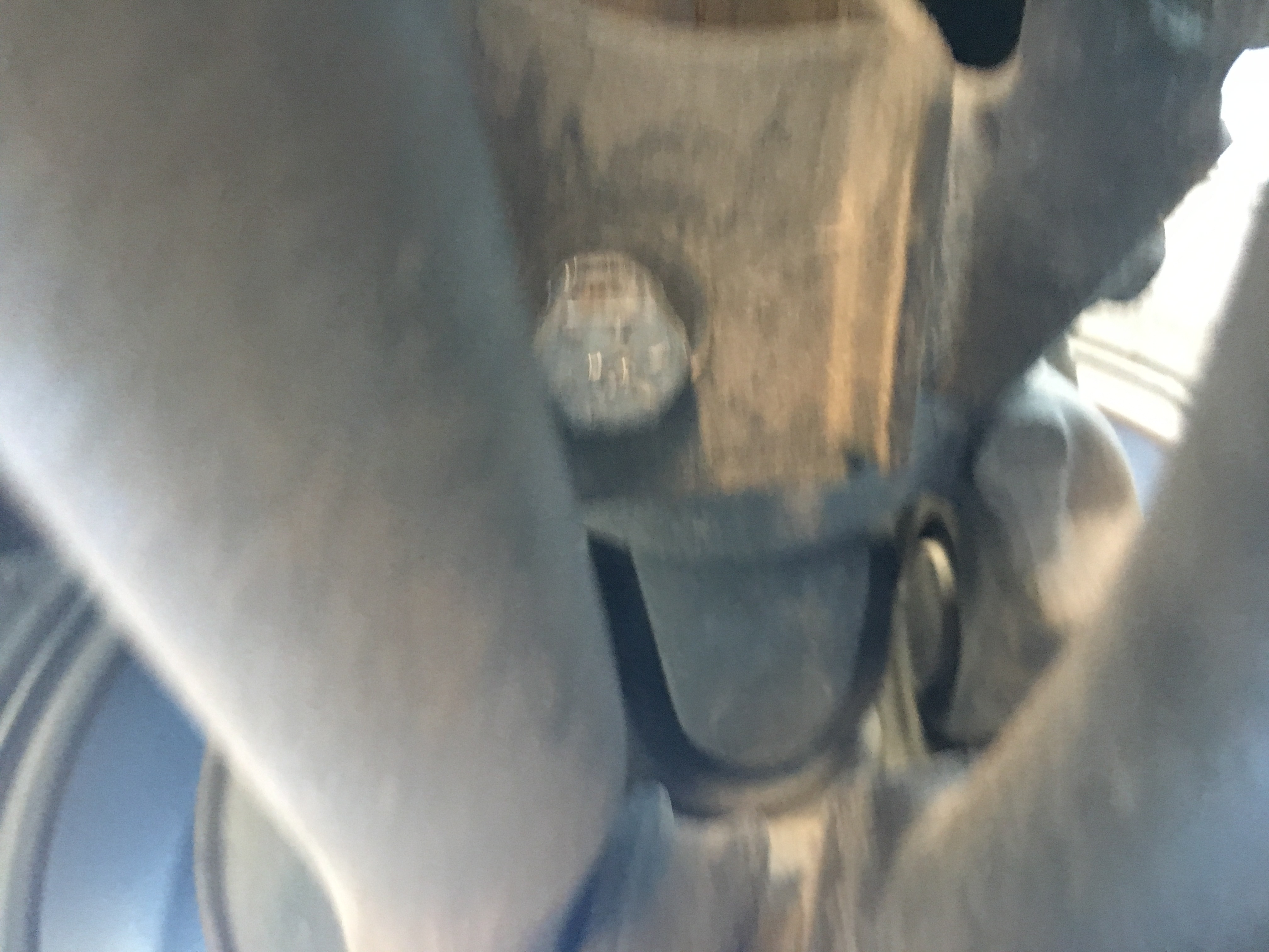

Post by RockyTrout82 » Sun Nov 25, 2018 5:29 pm
The attachment AA31CE5D-9083-488C-ADB9-26F77C39639D.jpeg is no longer available
The attachment CCCBD9B0-9CB4-49A4-80AD-3D4AE7913404.jpeg is no longer available

The arms look straight with no bends in them. So they're not Carli or Thuren.

As far as the track bar here are my thoughts, 05-07 have 14mm bolts I still have mine. I drive my truck hard and never had a trackbar bolt break I had the drivers one bend slightly once but never break. You can do the upgrade to 08-09 16mm bolts but it sounds like the geometry is off on your front end somewhere.
Try replacing the bolts (either size) and getting an alignment and see it that helps. Have them set it to 0 toe and about 4.5 degrees of castor.
Also you have some kind of aftermarket control arm that are probably longer than stock this can push your axle and stock trackbar off center how much depends on how much longer they are, usually you never want more than 1" longer than stock even then you need an adjustable track bar (set to 39 1/4") to recenter your axle.
