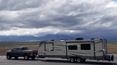

Post by olyelr » Sun Dec 10, 2017 10:07 am
No test with any weight yet, but with no load and 50psi in the bags the rear is 2.5” higher than the front (with the 1.5” leveling kit). I dont think I will really have any issues keeping the truck level without the bag spacer.

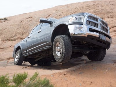

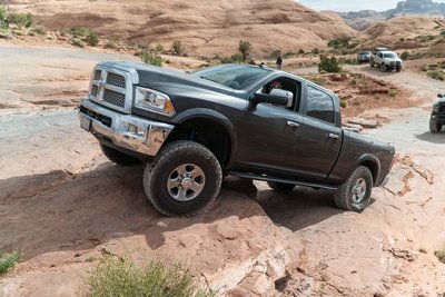

Post by TankerZak » Sat May 19, 2018 12:27 pm
Just as a follow up. I took my truck through Moab with this install and my articulation was just fine with 0 PSI. I'm not even sure i ever hit the internal jounce or if I did it was muuuch softer and not jarring at all. I do have boogie bump stops in front.

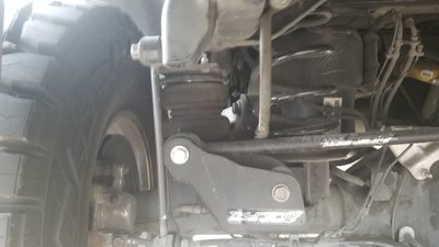

Post by tds2957 » Mon May 21, 2018 6:42 pm
I run boss air bags with day star craddles. No air empty and 15 to 20 # towing. Great set up with no rattle so far.

Post by TankerZak » Mon May 21, 2018 7:08 pm
SAM_0787 (2).JPG I run boss air bags with day star craddles. No air empty and 15 to 20 # towing. Great set up with no rattle so far.
The one thing i really like about the Airlifts is they dont have extra hardware at the top. It's a flat plate so you don't loose as much up travel. The boss and the firestone both seem to have unnecessary height to their bracketry.
