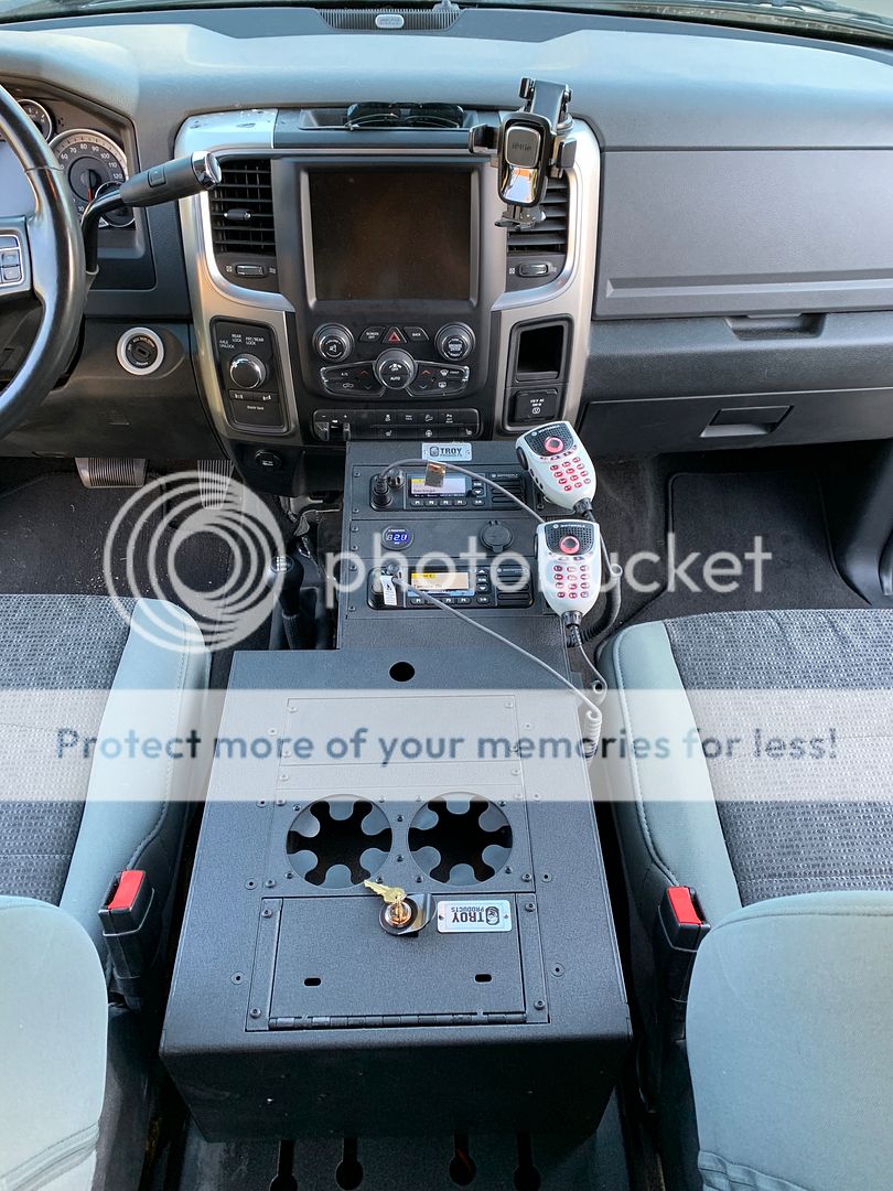

I found a Troy Products console which kinda sorta fits in the wagon. I then set about removing the front center seat / arm rest to make room for the console.Getting the center seat / armrest out, was an exercise in what not to do, LOL. Well, I learned a lot so I guess that's a good thing.
Here is the first mock up of the new setup:

Post by LagunaH1 » Fri Nov 09, 2018 7:14 pm
Made some progress today:
Still need to connect the good 'ol IC-7000's control head and HF antenna, but at least I now have FM & DMR on VHF and UHF

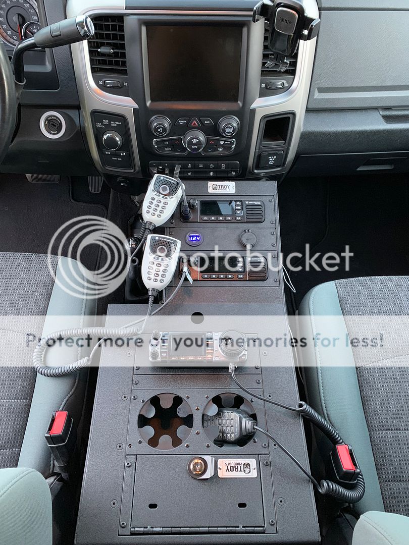

Post by LagunaH1 » Mon Nov 12, 2018 9:31 pm
Today I got the IC-7000 wired up with the voltage booster, tuner and control head. A few days ago, I decided to move the mics form one side of the console to the other
Here is how the setup looks today:
Next, I want to get the Icom mic situated properly, and after than I want to run a FAR thicker gauge cable to power the radios. The voltage drops from 12.5 with no load, to 12.0 with all 3 radios on, but not transmitting. If I transmit, the voltage drops even further.
In other words, there is too much resistance in the cable I've used. I had honestly thought 10 gauge would be good enough, but I guess not.

Post by Mule » Tue Nov 13, 2018 2:06 am
Personally, I'd go for a car stereo amp install kit. They're inexpensive, come with power cable, fuse, short ground cable, terminals, and some other cables/wires for amps.
I have 8AWG to the amp/radio in my pickup, seems to work fine.
