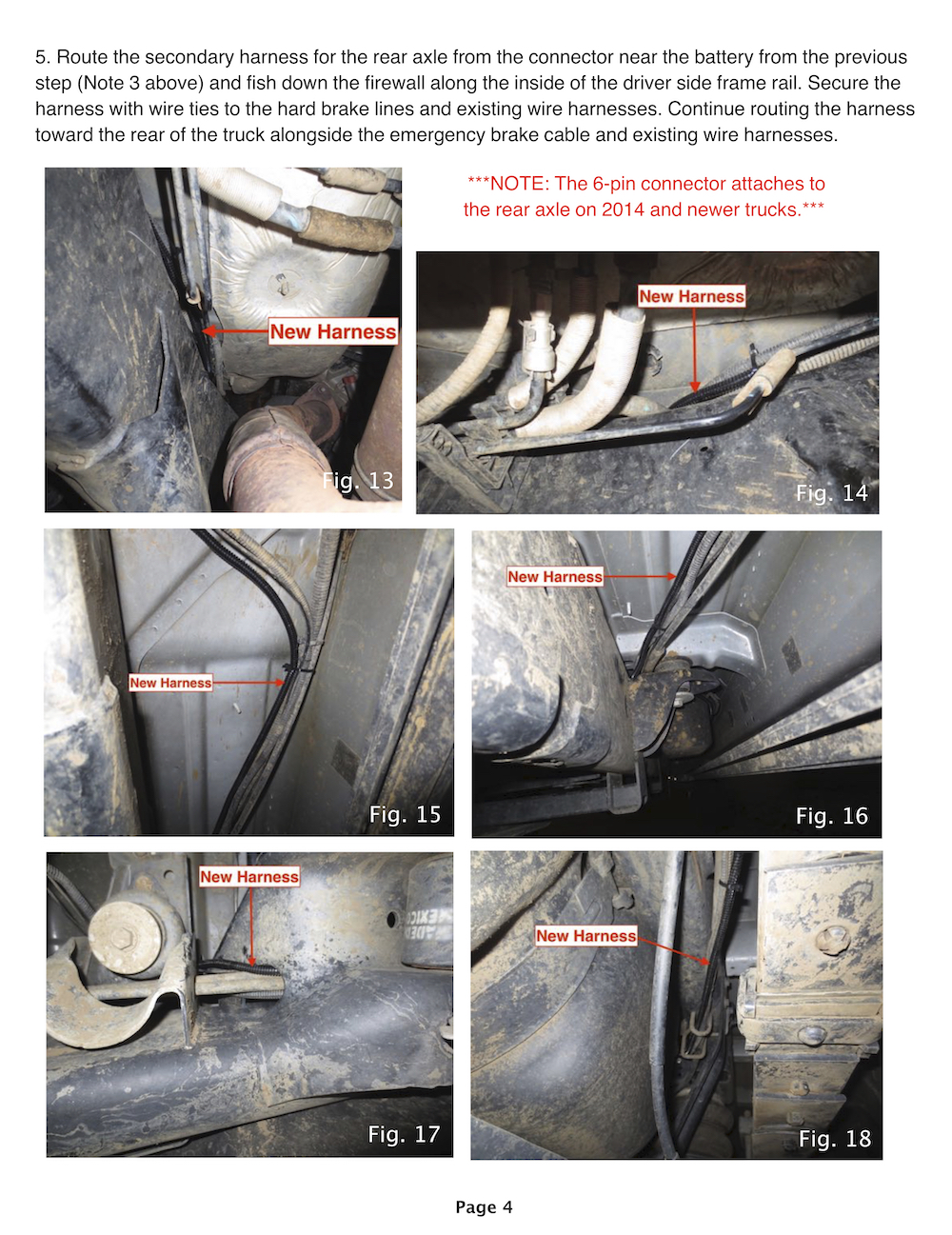

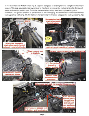

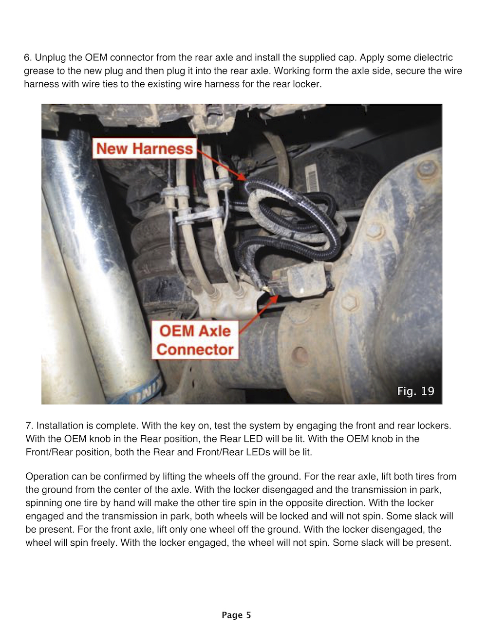

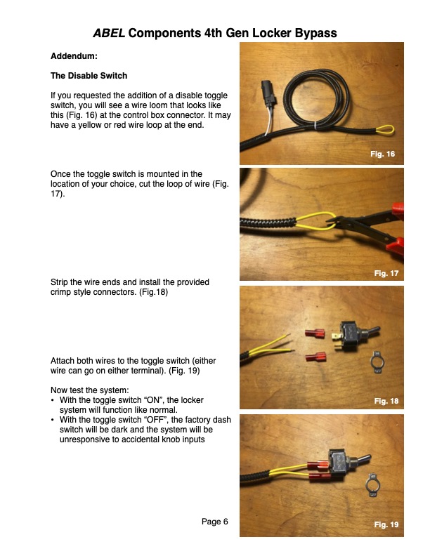

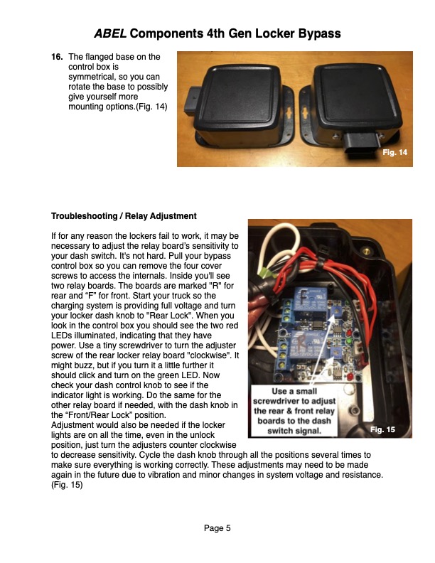

The Installation instructions can get lost or misplaced, so I thought it would be good to post them here so everyone can access them. The only problem is that it's a PDF file and this forum doesn't support the PDF format, so I've converted each page to its own JPEG image to make this work. They do get a little grainy after converting and downsizing, so if you want better quality, shoot me an email.
For some reason I can't delete the old instruction attachment pictures at the bottom of this post, so please disregard them. The old system mounted in the engine compartment, the new system mounts the control box under the dashboard and passes the harness through the clutch master cylinder block off plate hole.
