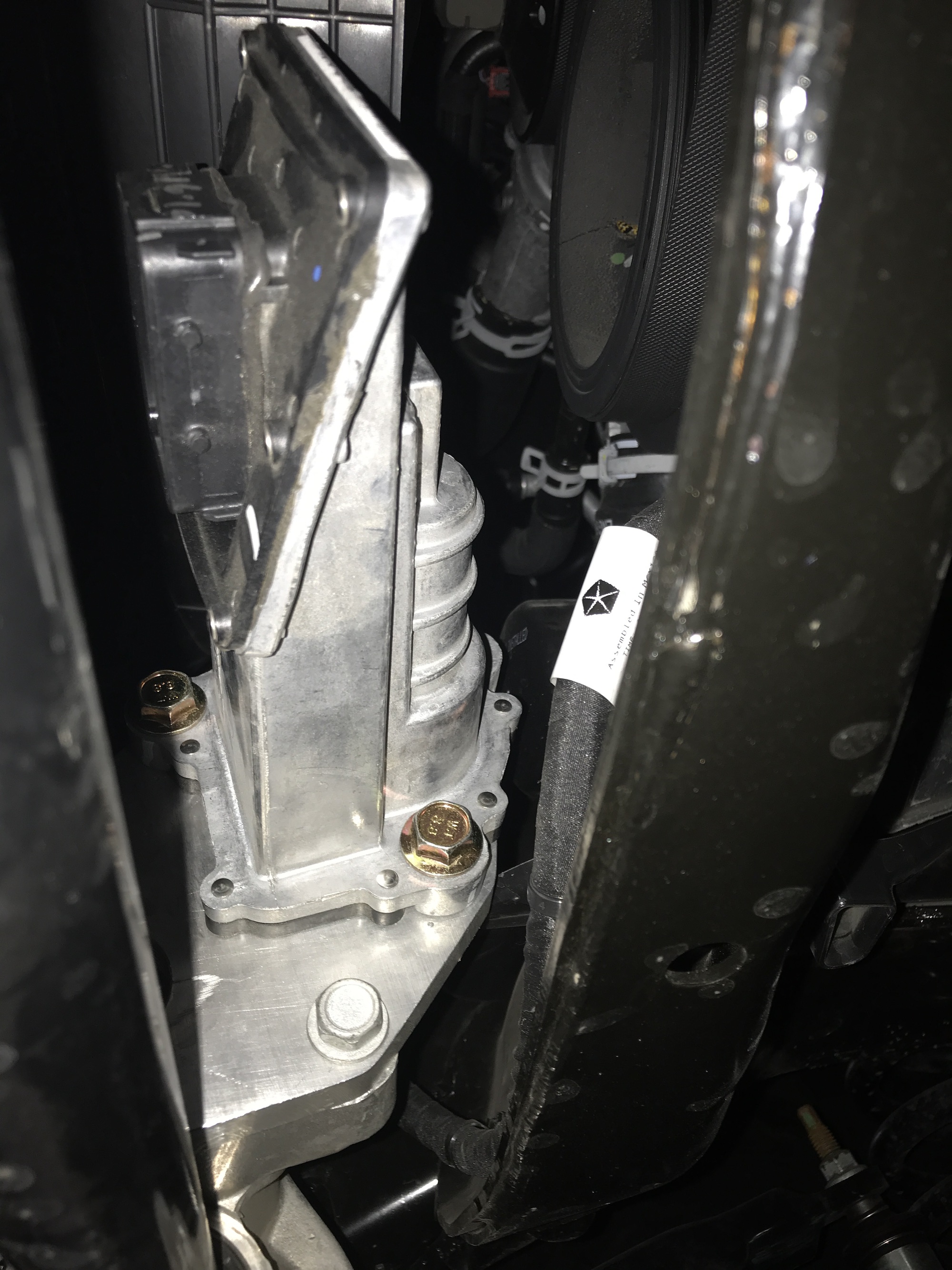

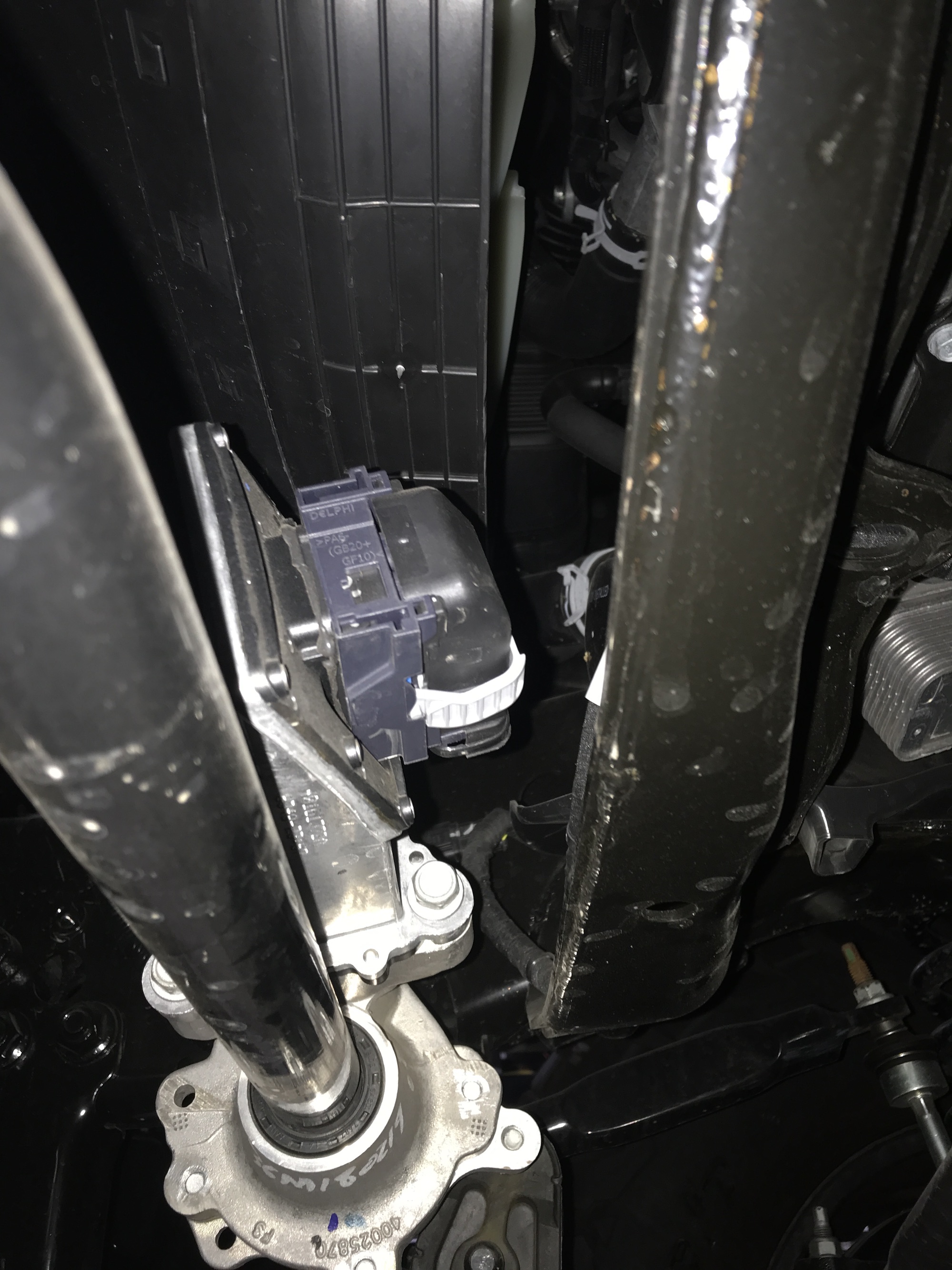

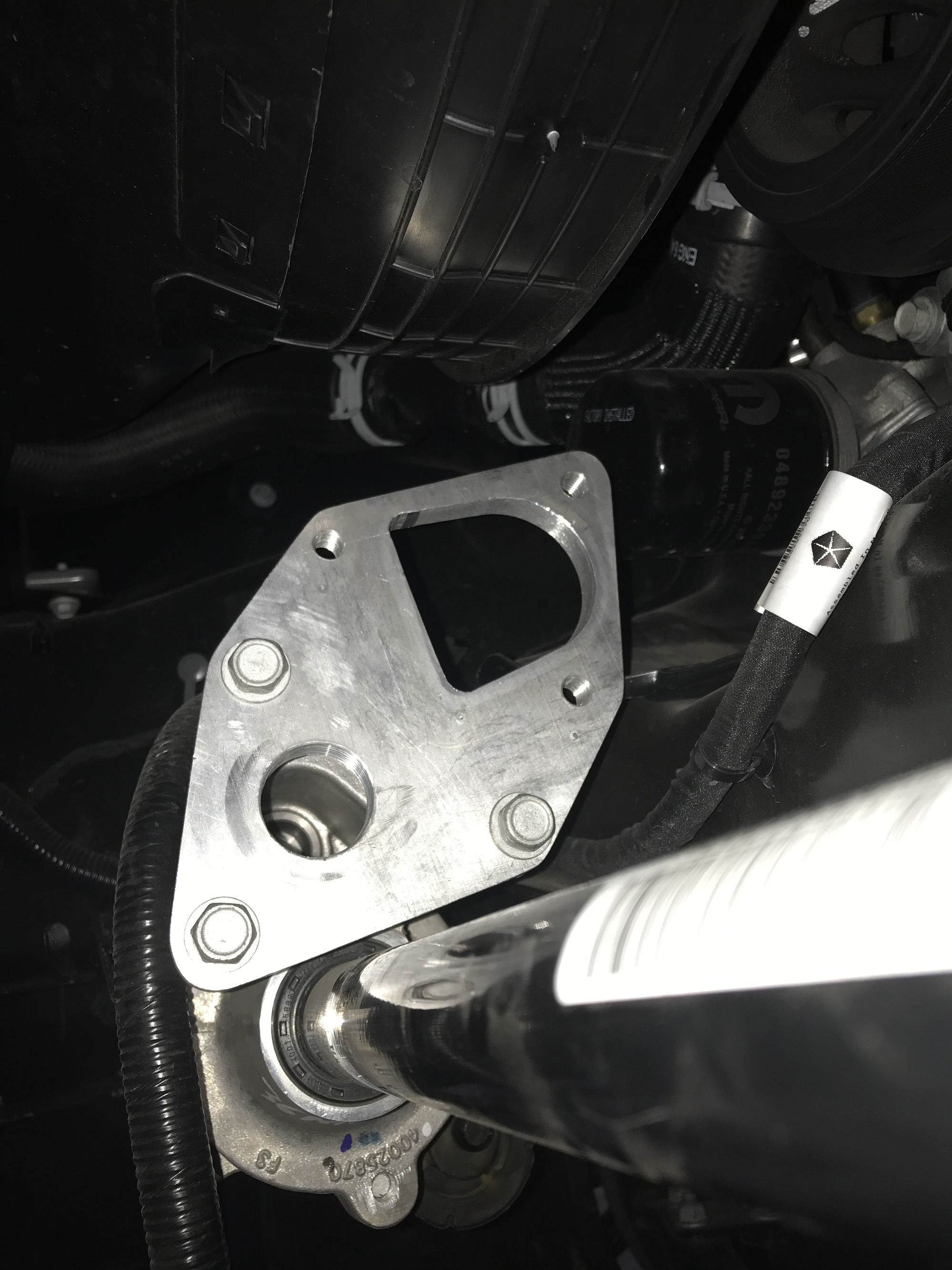

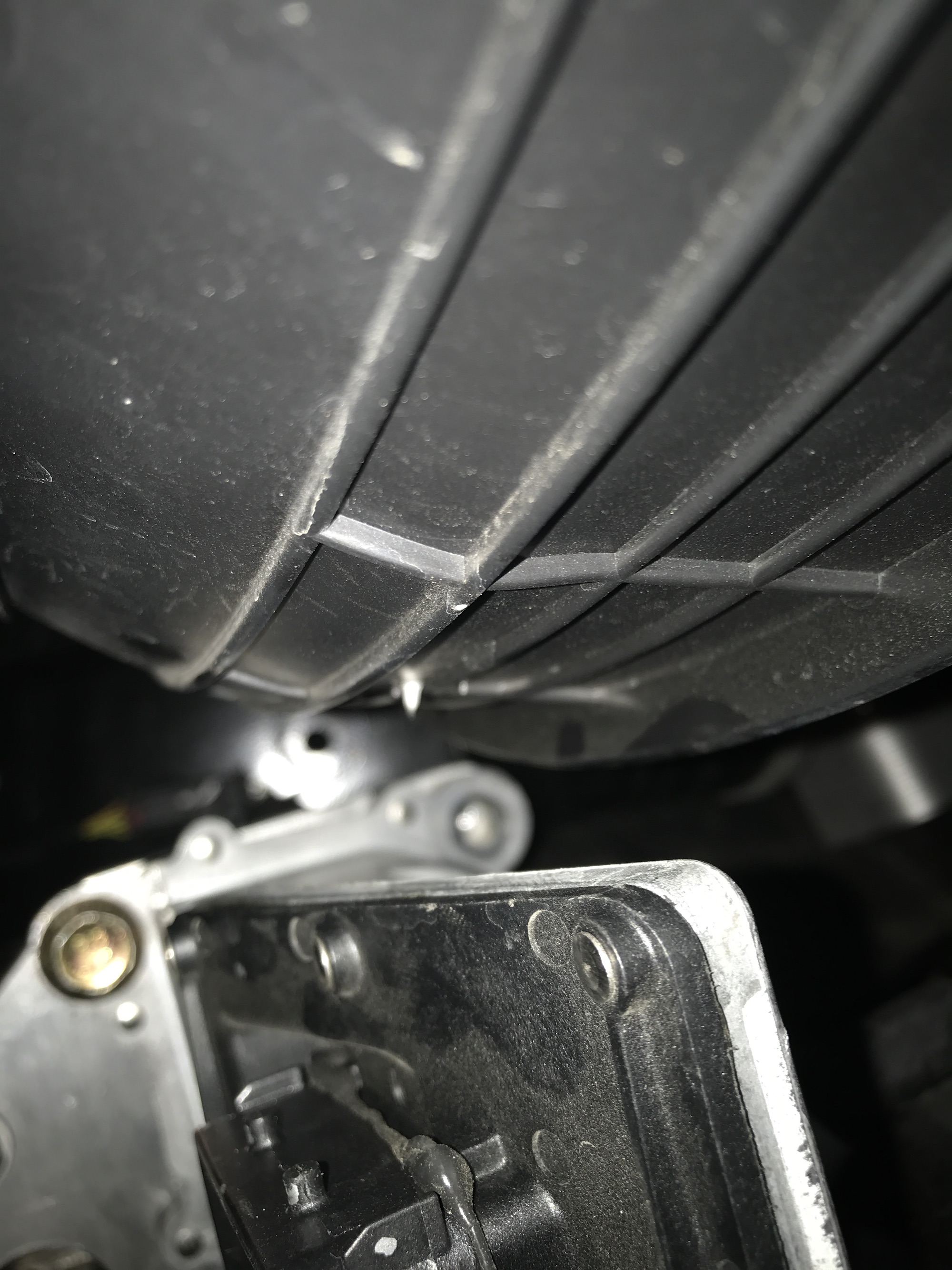

I had the opportunity to look at a 2019 and test fit the prototype:
2019 Stock SmartBar module.
My main concern was if there would be clearance issues with the crossmember and fan shroud.

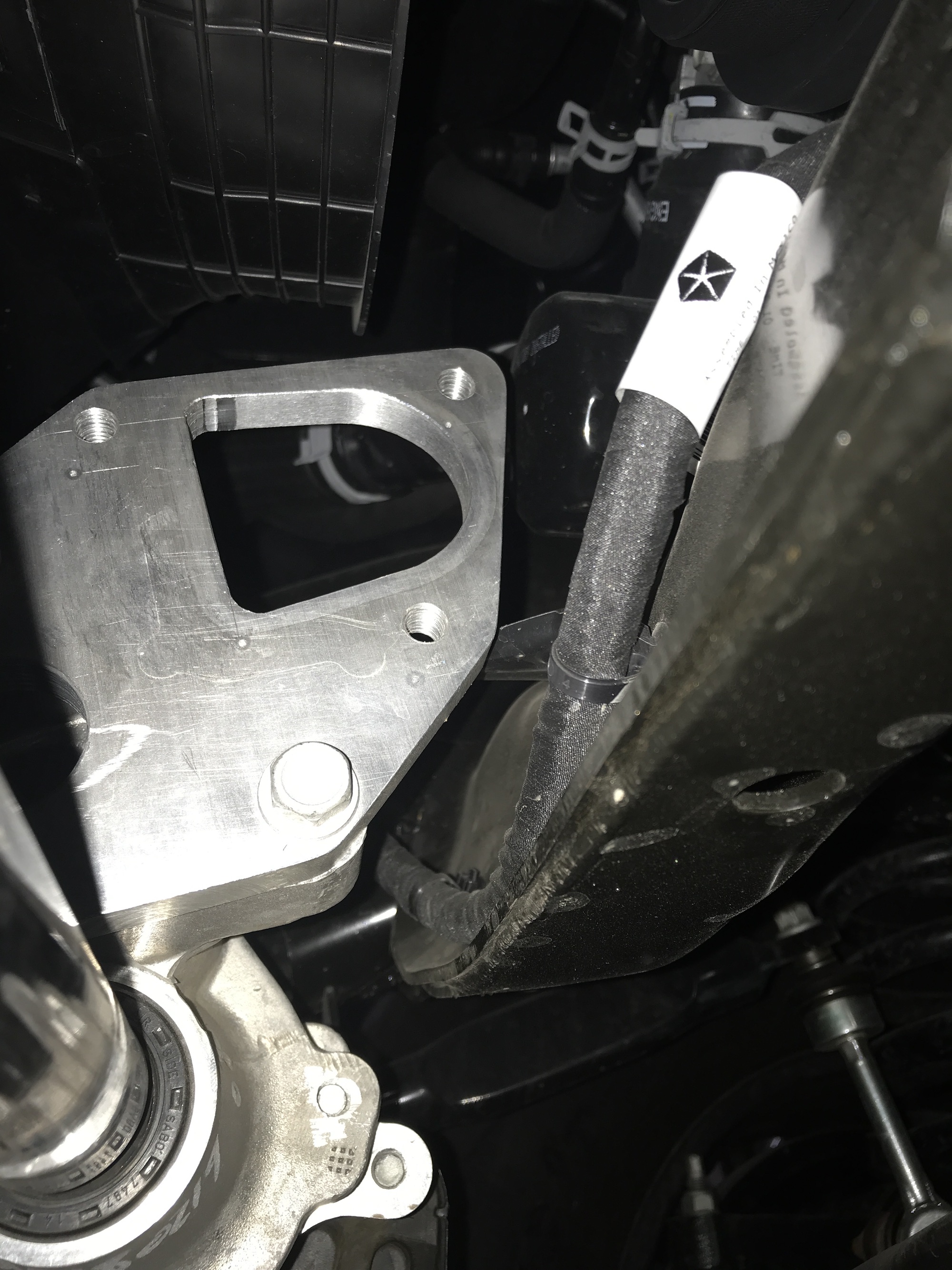

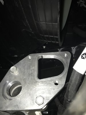

The adapter plate fits with room to spare.
Clears the crossmember.
Clears the fan shroud.
The only thing that's close is the plastic oil filter drain tray, but I don't think that will be a problem.

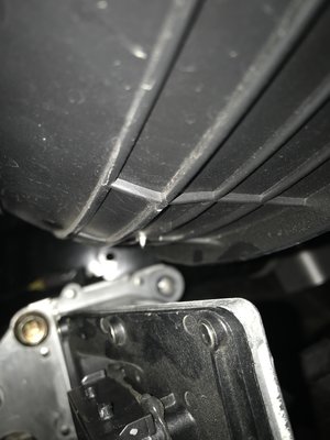

Fan shroud clearance with SmartBar module installed.
Crossmember clearance with SmartBar module installed.
Conclusion... Yes this will work on all generations of Power Wagon

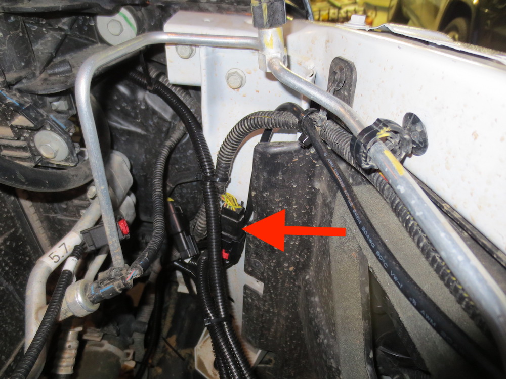

Locate this 10 pin connector on the passenger side vertical radiator core support frame.
Count the number of wires in the connector:
  • 9 Wires = It might work :)
  • 10 Wires = It won't work :(

10 wires.

There are 10 wires going in and out of that connector on my truck. What does that mean regarding the bypass possibilities?
