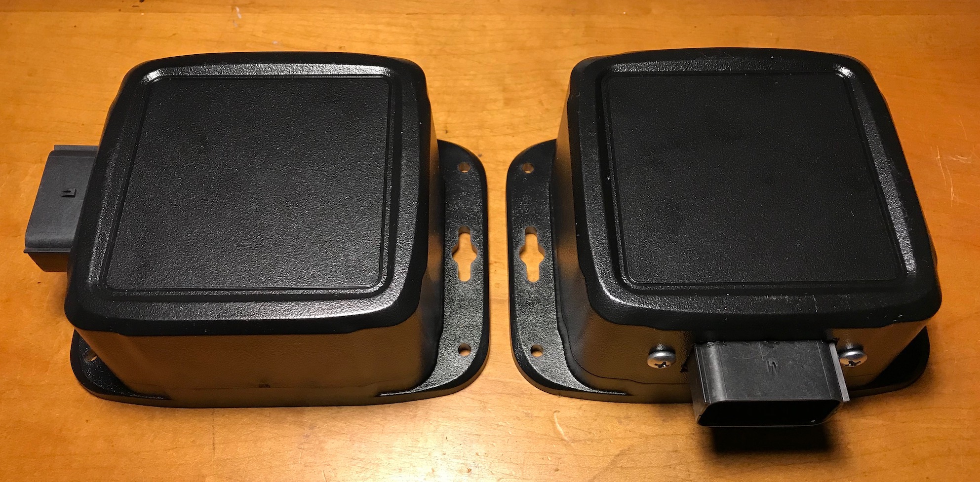

The new box is square instead of rectangular making it symmetrical so the box can be rotated 90º on the flanged base to provide improved wire harness routing options. The supplier is CNC machining the cutout for the bulkhead connector for me, which gives it better fit and finish.

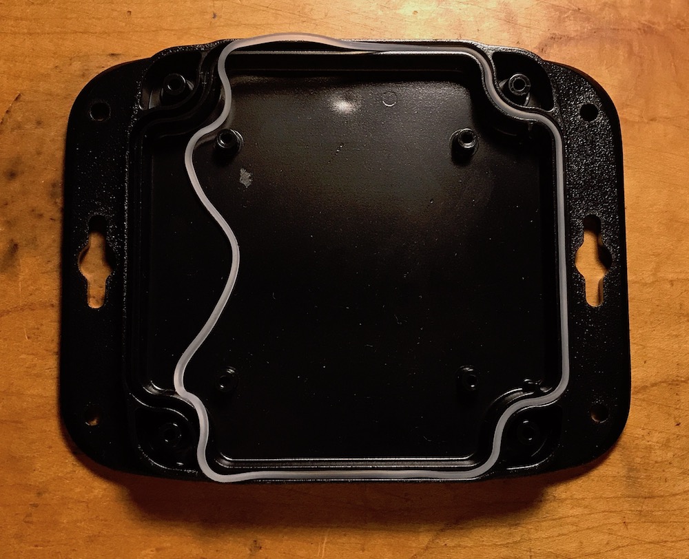

It's still a rugged, heavy duty waterproof enclosure. There's a silicone gasket that fits in the groove of the base.
Once the gasket is pushed to the bottom of the groove it's barely noticeable.

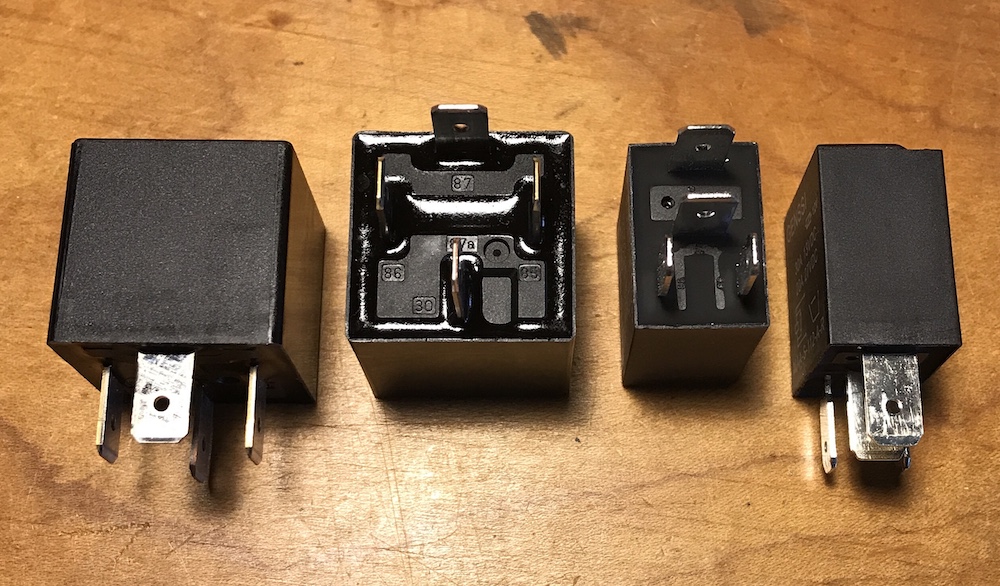

One of the ways I was able to downsize the control box was to downsize the components inside the box. The relays on the left are the original ISO style that Morgan was using and the ones on the right are what I'm currently using. They are the same brand and type found in your factory fusebox and have the same amp rating.
Comparing the difference between Mini and Micro relays.
Also Morgan's relays weren't easily replaceable, but now mine are.

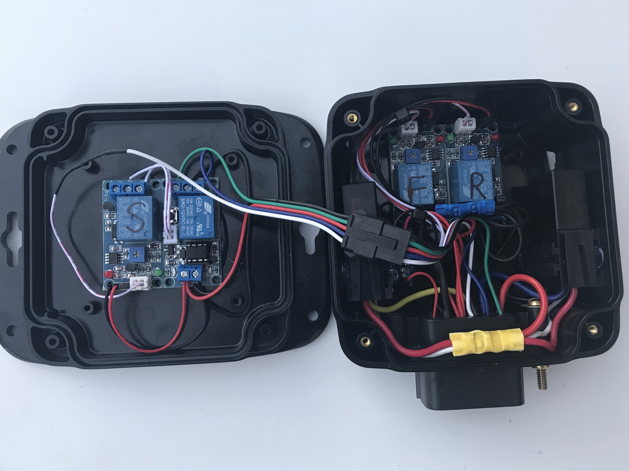

Using smaller relays has made room for more components. Here's what the inside of the new "Full SmartBar Bypass" looks like.
Inside the new "Full SmartBar Bypass"
