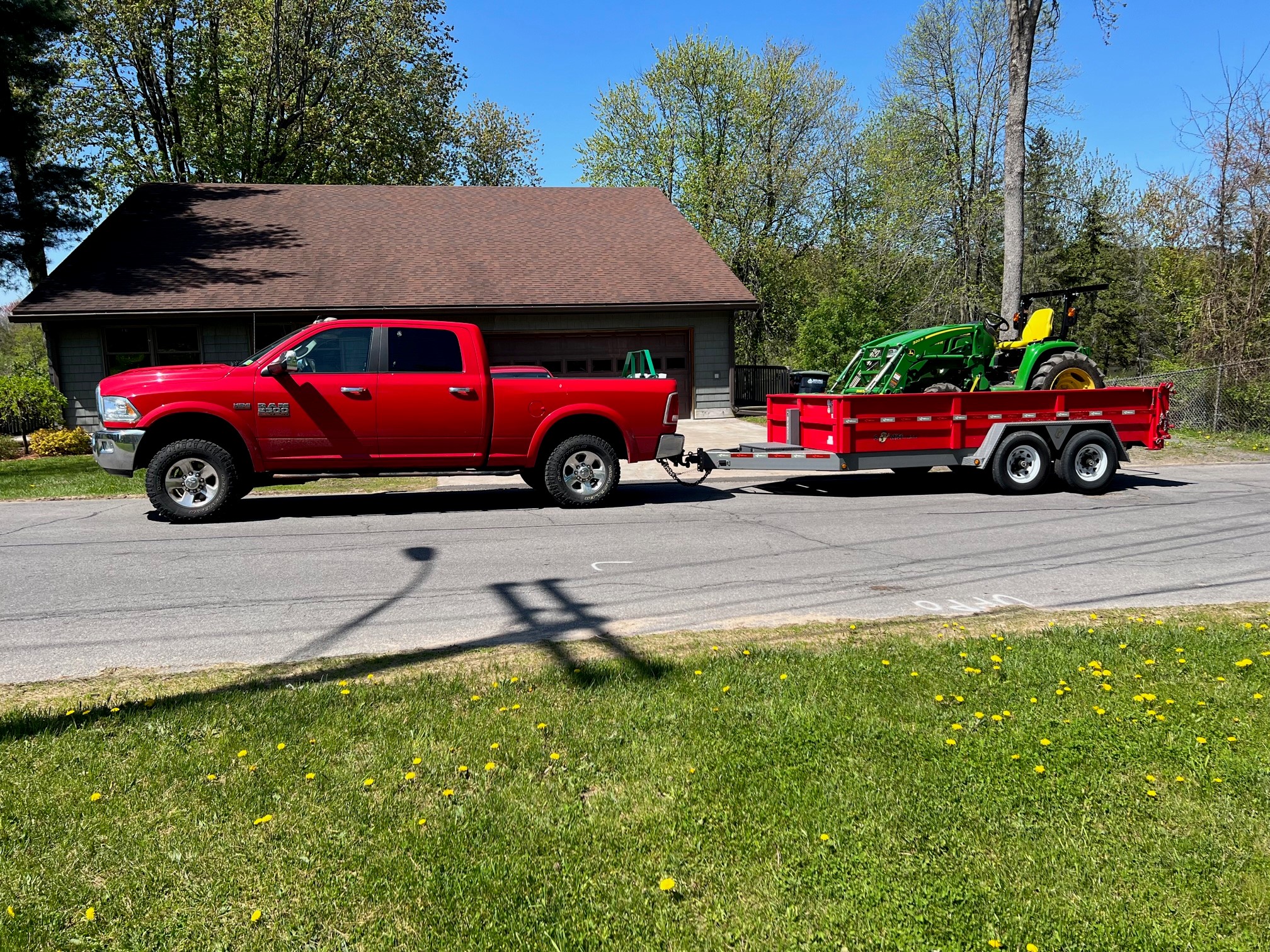

So yesterday loaded up a tractor and trailer, total weight about 8500lbs. Did not chock wheels and loaded with truck in park. When I went to drive away the gear shifter was very tight, and seemed to have no detents in it. The light moved appropriately on the gear indicator and the transmission seemed to work fine. What have I done and what does it take to fix? 2012 PW.
