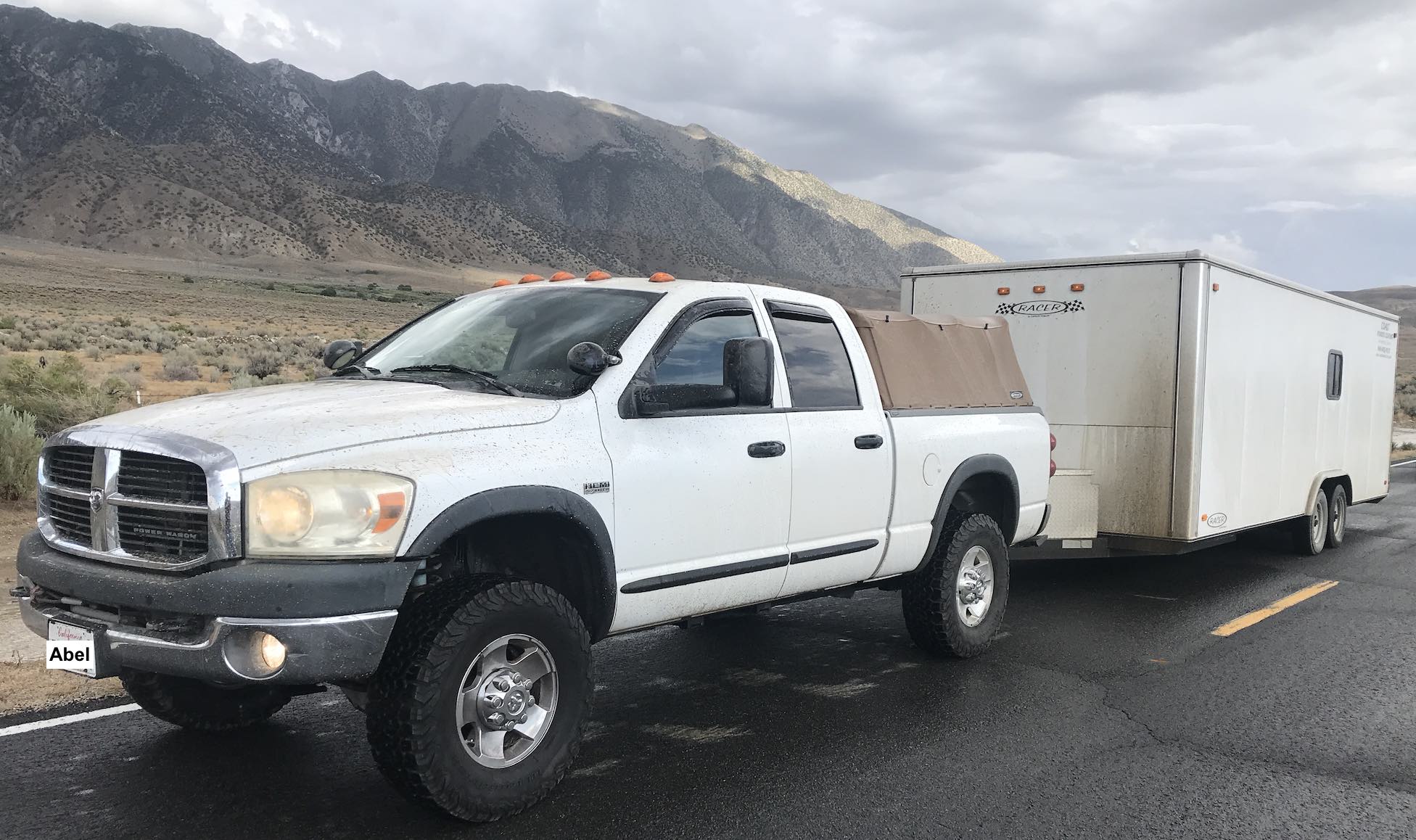

Power Wagons have softer springs for off roading. They still have all the same HD drivetrain components as the other HD Ram trucks, so if you just add some air bags and or a weight distributing hitch, you'll be fine. One benefit of the Power Wagon you're considering is the 4.10 gears that it comes with, which makes it more tow friendly.
My 2008 has a GCWR of 17,000 lbs. I added air bags and Daystar cradles to my truck and have exceeded that rating on a couple occasions.
