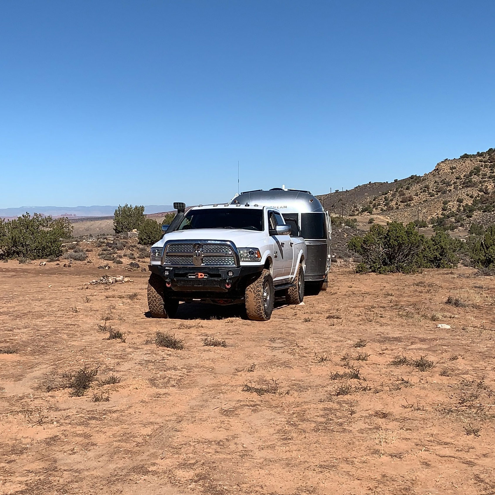

I just dragged the Airstream up a muddy ass hill today and the Airstream was going one way while the truck went another.
