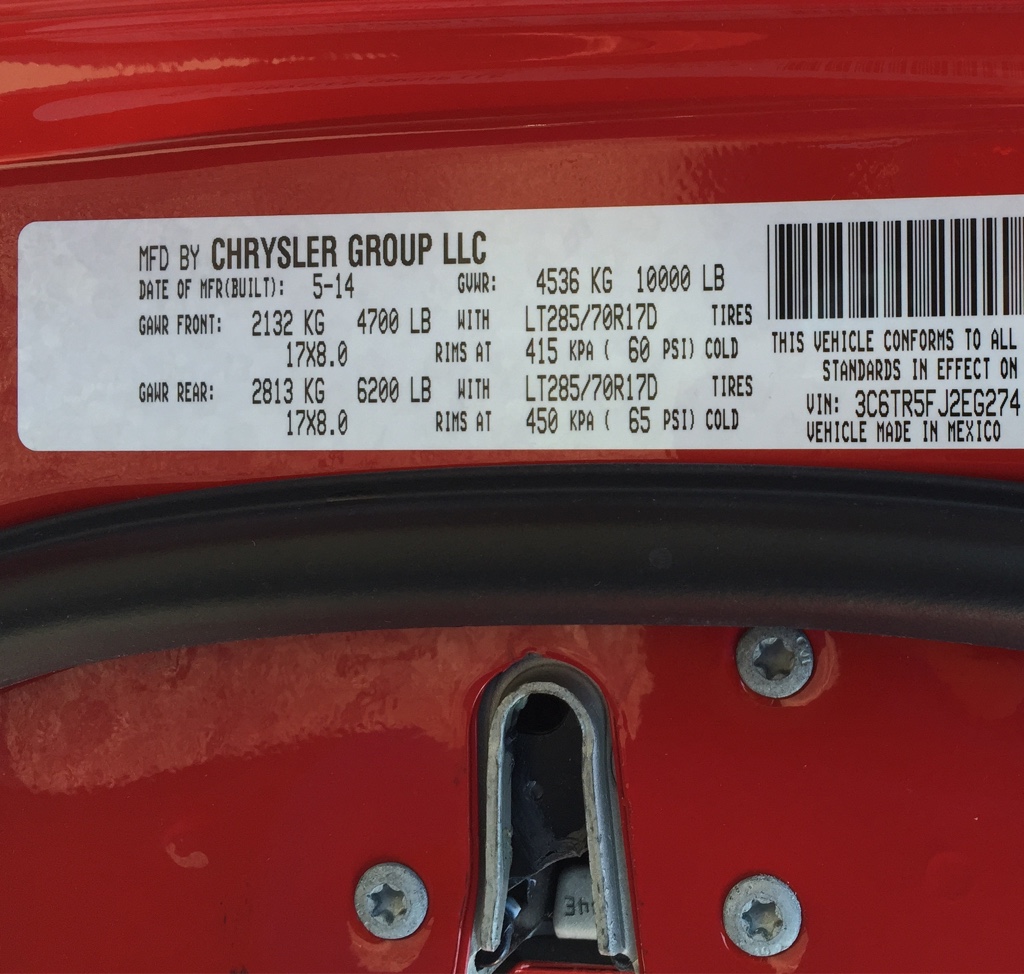

I’m curious if anyone here can answer this question. If I change my suspension components or add air bags or change tires can it increase my GVWR or payload? I’ve seen some of you make comments about the PW having a low payload capacity because of the suspension. But other 2500 variants seem to have much higher payloads. Suspension gurus please chime in.

You can never change the sticker. But the only thing lowering the rating on these trucks is the suspension. But when you replace the suspension with upgrades it'll get a little worse and a little better in different aspects. At the end of the day I personally use the normal 2500 gas payload and towing numbers and airbags to offset the suspension.

You can never change the stickers?TankerZak wrote: ↑Sat Sep 29, 2018 3:14 pmYou can never change the sticker. But the only thing lowering the rating on these trucks is the suspension. But when you replace the suspension with upgrades it'll get a little worse and a little better in different aspects. At the end of the day I personally use the normal 2500 gas payload and towing numbers and airbags to offset the suspension.
Where did you get that information?
Re: GVWR and Payload
Fine... i didn't want to cover it. But in rare instances a shop can change your sticker if they rebuild a portion of the vehicle and are authorized to do so. But it's pretty rare. I've seen one truck with a modification sticker. He's asking basic questions so I was trying to stay out of the edge cases that can cause confusion.

Change you change the payload? The answer is technical yes.
Consider the differences in trim. You take two 2500's a Laramie and a Tradesmen. They're the same truck and chassis, but why is the payload less in the Laramie. Simple, all the extra shit weighing it down.
If you take out all the leather seats and stuff, what happens? Payload increases. Follow the logic here.
Same with suspension components. Different coils, different axles, extra.
The thing is, when you get stickers put on the truck, it's based on a set of variables with built-in safety. So if you change the variables, technically the numbers would change. But it's also a combination of factors.
Like if I had a 1500 and swapped in a 1-ton rear axle, that wouldn't mean the coils out back could now support the same amount of weight. Right.
Hope this makes sense.
As to why other 2500's have higher payloads, it's because they usually have 10000 GVWR, where the Power Wagon has like 8590 GVWR (or something, I forget, not going outside to look) - this is the "derating" we all talk about. If you think about it, the PW has the same axles, same frame, most of the same parts as a 2500 6.4l Hemi non-Power Wagon. What's different then? The coils, the extra lift, and the 33-inch super soft D range tires.
So my truck was like 7500lbs with two passengers stock, so 8590 - 7500 = 1090 lbs payload
vs a standard 2500 with 10k GVWR
10000 - 7500 = 2500lbs payload.
The standard 2500 comes with load range E tires. So imagine if you have 35's and E rated AT tires with bags, you can easily handle the same amount of weight. Your truck is not going to break in half like an aluminum Ford.
So, really, all the worry is misplaced.
Now, don't go towing a 30k backhoe on an gooseneck, but at the same time, don't fret that you won't be able to load up all your shit either.
