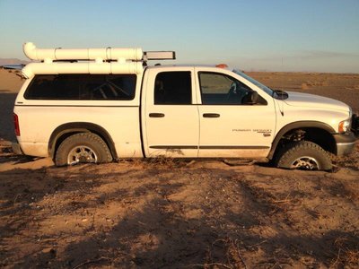

This is the old tank that I am replacing to reduce weight on the rack. This one is made up from 6" PVC Sch40 pipe, with lots of big fittings (mostly with custom cuts to get them to fit) and lots of glue joints. Capacity calculates to more than 18 gallons, and I configured it to fit fairly precisely over the projections of the Yakima rack crossbars, so that it can't move forward or backward because the bars are captured b the tees. The tank is held to the Con-Ferr basket by stainless steel U-bolts and some fabbed aluminum reinforcements. Overall length is about 6.5 feet, and it can be filled from the 4" plug in the top, or by a pressurized garden hose attached to the boiler drain at the rear. This tank is heavy even when empty, and it bent the crossbar at the rear rack tower when I drove a bit too fast over rough ground with a full tank. New tank will be a single length of 6" PVC with a screw cap at the front for cleaning and flushing, and a saddle fitting at top rear with 4" threaded plug for filling and the same boiler drain for draining or pressure filling. Overall length is 8.5 feet, about the same as the bag awning on the opposite side of the rack. Will use same U-bolts and reinforcements as old tank and capacity will probably be right at 13 gallons. New Yak bars will be the HD 86" bars cut down to fit my system, and I will probably fill the tank with wiffle softballs to control surge in the tank. The front caps facilitate the wiffle idea.
- Yuma PW Stuck 1a.jpg (29.32 KiB) Viewed 19776 times

I like the whiffle ball idea. I think they should not be able to move inside the pipe to be effective.
