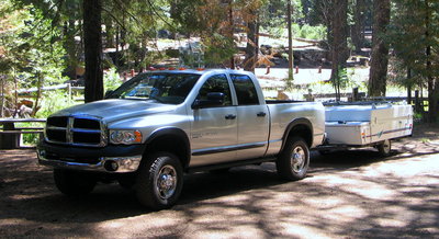

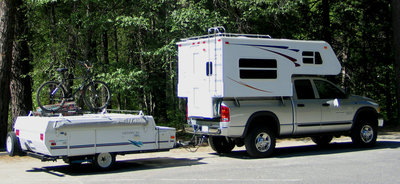

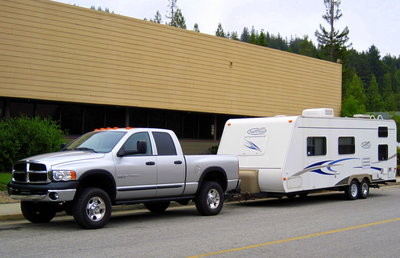

Overweight ? Not even close ...Limamikemike wrote:When your powerwagon is loaded.
I've debated putting a sled deck on my truck to carry a dirtbike and an Atv while towing our travel trailer. The total weight of this is about 1025lbs plus 800lbs tongue weight plus driver, wife and dog 425lbs. Then add fuel and snivel gear etc
The payload on my PW Laramie is 1330lbs (yes you read that right). Bags or timbrens will be required no doubt.
Some will ask why I didn't buy a regular 2500 or 3500. I wanted the truck I've lusted after since 05 and I figure that PW still has a full float axle and regular HD running gear so it should be able to handle the weight with some help.
A new F150 has better payload# than a PW but I think it's better to have an understressed 2500 chassis rather than a overstressed 1/2 ton chassis.
So guys with slide in campers, guys that tow or load heavily and work their trucks please chime in with your thoughts.
The weight police will probably chime in and say GVWR is the law, BC is the only Canadian province I know of that enforces personal vehicles weight ratings, I should still fly under the radar with the regular 2500 badges, unless the Mountie knows what a PW is.
Anyway let's hear your thoughts...
