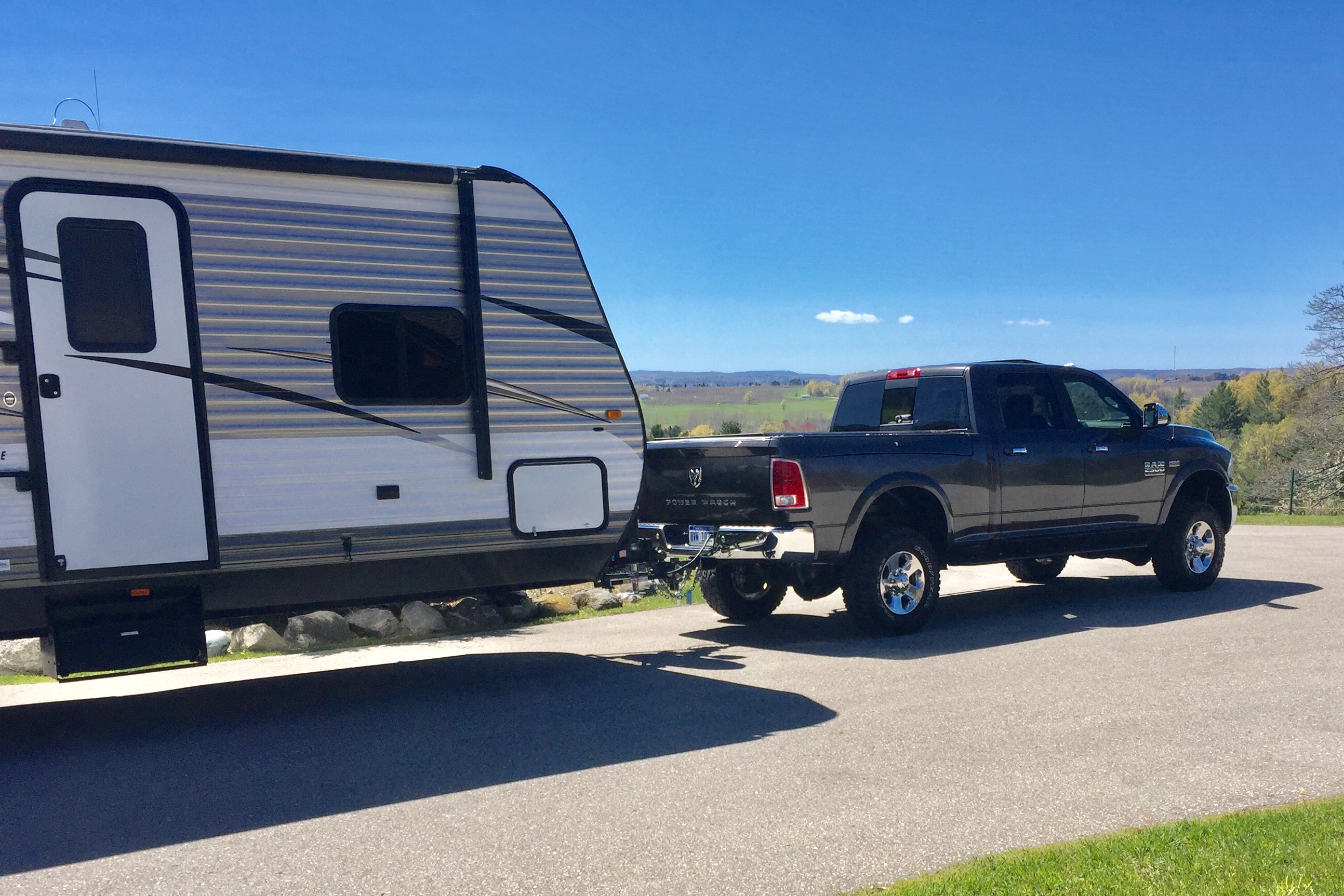

Well, we were in a bit of a hurry and I didnt really have any time to tinker with the setup, but all seems to work well. Only towed it about 20 miles or so. Going by memory (which, according to my wife, SUCKS), the truck seemed to do less "bouncing" up and down in the back, although it never really did it too much anyway. To my surprise, the truck actually looked fairly level yet before adding any air to the bags, but maybe that was because the trailer was basically empty? A quick squirt from my small air compressor (and i mean real quick) bumped the pressure up to 40PSI and lifted the back of the truck just over an inch. I may need to add more air when the trailer is loaded up and has more tongue weight, I am not sure, but the bags are rated for 100PSI so that is not an issue.
I snapped a quick pic with no air in the bags and one with 40PSI. Not sure if the difference is even noticeable in the pics, though.
Hope to have some more input about this setup soon. I am going on a dads n lads camping trip with the setup this weekend, but its only about 15 miles down the road. But, I think it is going to work great at keeping the truck level as well as stiffening up the rear suspension when towing heavy.
On a side note, I think I need to adjust my weight distribution hitch now. The bars went on so much easier for some reason (before I even put any air in the bags). I also have to lower the hitch a bit more, as the front of the trailer is essentially and inch or two higher now than it was before.

Re: Airlifter 5000 Ultimate airbags w/ Daystar cradles '14+
Post by olyelr » Wed May 24, 2017 10:44 pm
Pics with no WD hitch or air in bags...
The front of the truck raised up roughly a .5", while the rear lowered roughly 1.5".
Pics with WD hitch connected but no air in bags...
The front of the truck was basically back to unloaded height, and the rear was still 1" lower.
Pics with WD hitch and 45lbs in the bags...
The front height raised back up roughly 1/8"-1/4" from unloaded height, and the rear was 1/4" higher than unloaded height.

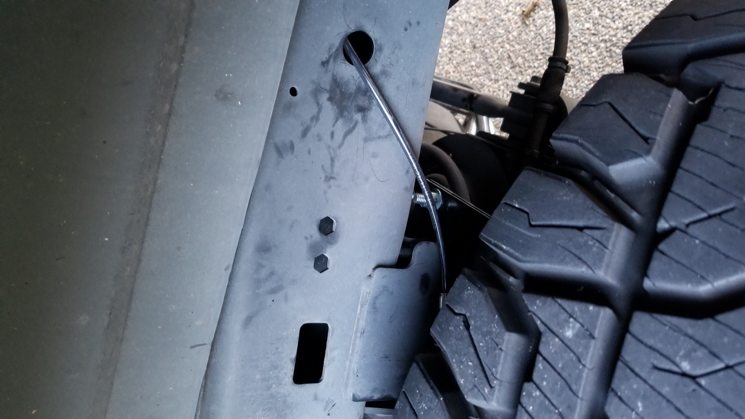

Okay. Finished the install today and a big thanks to DamageWagon! Definitely do NOT use the spacer. It needs to come out for sure. I measured the factory bump stop with spacer vs the airbag jounce with all hardware installed and both came to 3 5/8 inches. So assuming that jounce is as hard as it felt the bump stop effect is equal to factory without the spacer. If you add the spacer I think you have about 3/4 inch extra bumpstop.

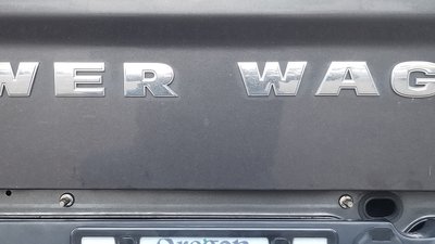

We found a GREAT place to run the hoses, up the frame and into two metal pre existing holes below the tailgate but above the bumper. So no drilling. I also added some Alligator V2B fittings instead of the black platic caps. I use them on all my truck and RV tire fittings so I used them here too.
We didn't end up installing the Daystar craddles. I'm still not 100% sure this was a great idea but the airbag hits this giant square bump pad. Not sure it could possibly miss the pad. Thoughts? We didn't install the bottom bracketry either, so its just feee hanging and sitting on the bump pad. I'll post some pics.

Adding pictures. And yes the tailgate easily clears the air fill points.
