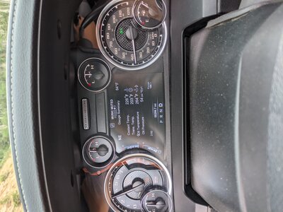

2018, all Amsoil fluids, 37s, 5.13 gears
Towing my 8500lb'ish trailer up 13% grades for several miles (3,000 ft above sea level to almost 11,000 ft above sea level).
Outside temps started above 105 but we're much cooler at the top.
1st/2nd gear most the way...wrapped out 1st.
By far the hardest I've ever towed and definitely made me consider a Cummins (never going to happen but I thought about it).

So what's the temp gauges parameters? Looks dead center but I'd think at nearing 230 it'd be 3/4 to "H"...
