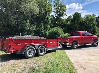

Post by Bill2014 » Thu Jul 26, 2018 1:54 pm
Had to use a new mine location - asked for 5 tons and they dropped 7 tons in my trailer for one of the loads. The poor Power Wagon. :o

Post by Bill2014 » Mon Jul 30, 2018 10:25 am
14'x7' dump trailer
