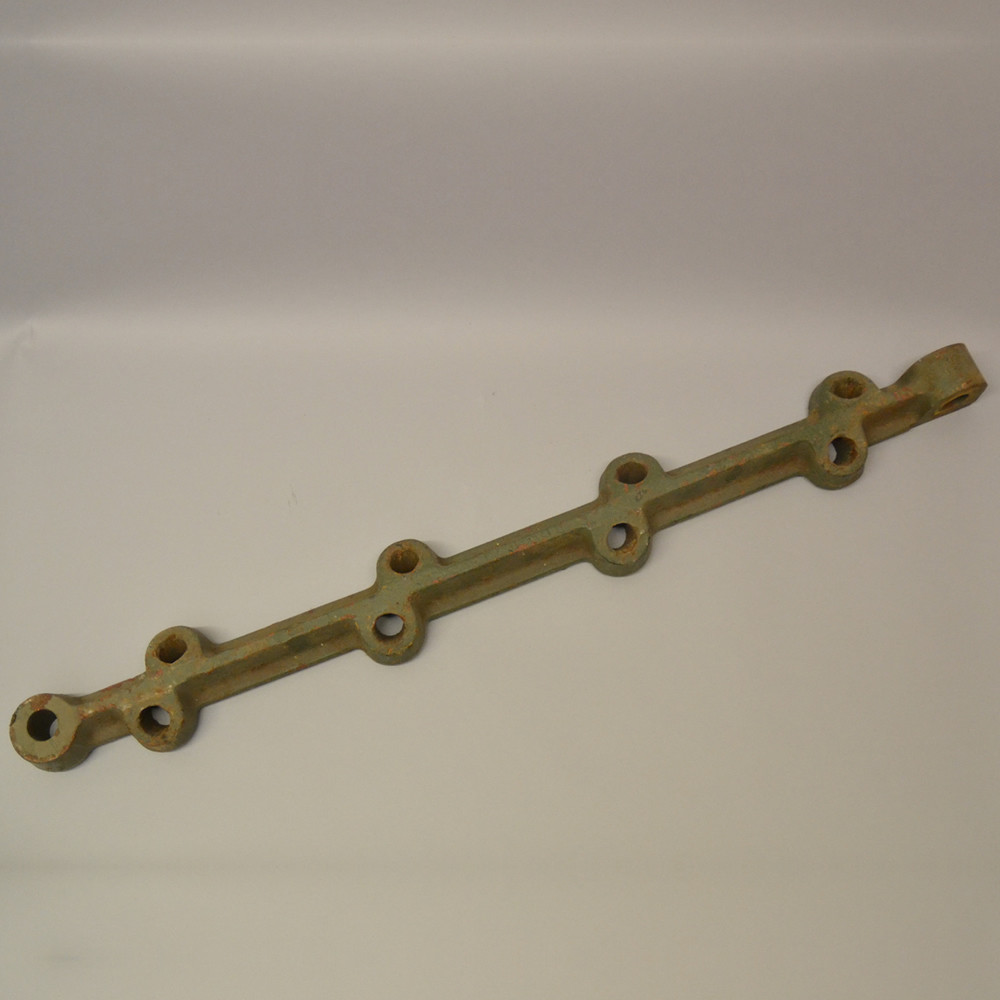

Brit Army/NATO Ground Anchors
Anybody have experience with these? Any sources for them on this side of the pond?

They are part of a system that includes a plate w/ holes in it. The UK version is roughly 36" long w/ 8 holes. That part could be replicated by purchasing 1/2" plate, having a shop plasma cut or drill holes in it. If the plate is made, a standard concrete stake would work fine. The picture is of the UK plate - a flat one would be fine.

Thanks for following up. This is the plate that Denbeigh sells in the UK. Seems like if you buy the system with the plate and eight stakes, it's about $290 plus freight, customs and all the other BS. With all that, probably getting close to the $500 cost of a Pull Pal, but takes less space than a Pull Pal. OTOH, Pull Pal is less work to deploy and use.

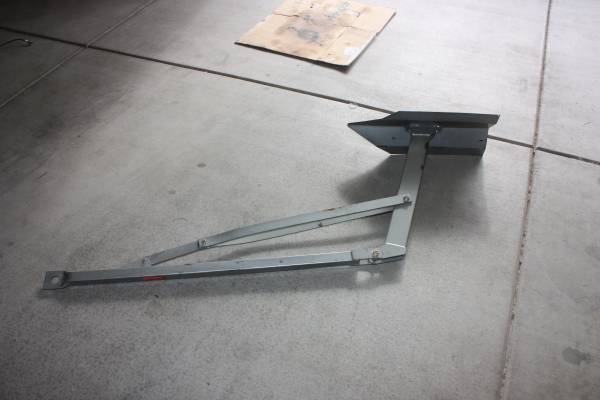

I spoke with OK Offroad about Pull Pals, and they told me to not even think about anything smaller than the RW 14000 for the PW. Pull Pal is real picky about not undersizing the tool for the truck.

Hey Ducky, I have the 14,000lbs Pul-Pal with the body bag. It take up no space in the bed of my PW. I have it position in between the front of my tool box and the front of the bed, standing on edge. Most of the time, I forget it's even there.

I am now the owner of a Pull-Pal RW11000 (the size for Jeeps and mid-size trucks). Found it on CraigsList, got it for $160 so couldn't pass it up. Even if I bend it on the first recovery, it will have paid for itself. The guy I got it from told me that his brother had used it a couple of times with a HumVee H1 and it worked OK with that beast. Still looking for an RW14000 at the right price.

Nice! The frame is plenty strong, so you can add width to the spade if desired to get a better bite. Once buried, they are difficult to remove, so attach a chunk of chain or cable to the spade end of the frame so you can pull it out if you can get in front of it. I doubt you'll need the bigger unit.
