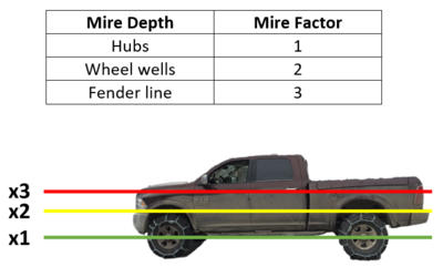

Mire Resistance
Mire resistance is the load on a stuck vehicle imposed by the surface it is stuck on. The resistance of a mired vehicle depends primarily on the depth to which it is mired, and the weight of the vehicle and cargo. Not all surfaces are created equal, but the mire factors presented here are a good starting place. If in doubt, adding extra mechanical advantage won’t hurt. For example; soft soupy mud with a fairly hard bottom will offer less resistance than bottomless thick clay. Fresh powder snow offers less resistance than spring snowpack with a hard crust. The clear exception to the mire factor chart below is being high centered or otherwise hung up on rock. Go straight to mire factor 3. Vehicles with smooth skid plates underneath may drag over rocks more easily, but with the mess of crossmembers, bars, small skid plates, etc. underneath a Power Wagon, plan for a hard pull. The best course of action is to jack the vehicle up and build track under the tires so you don’t have to drag it over rocks in the first place.
Multiply the weight of the vehicle (including cargo) by the mire factor to determine the mire resistance.
Mire Resistance = Vehicle Weight x Mire Factor

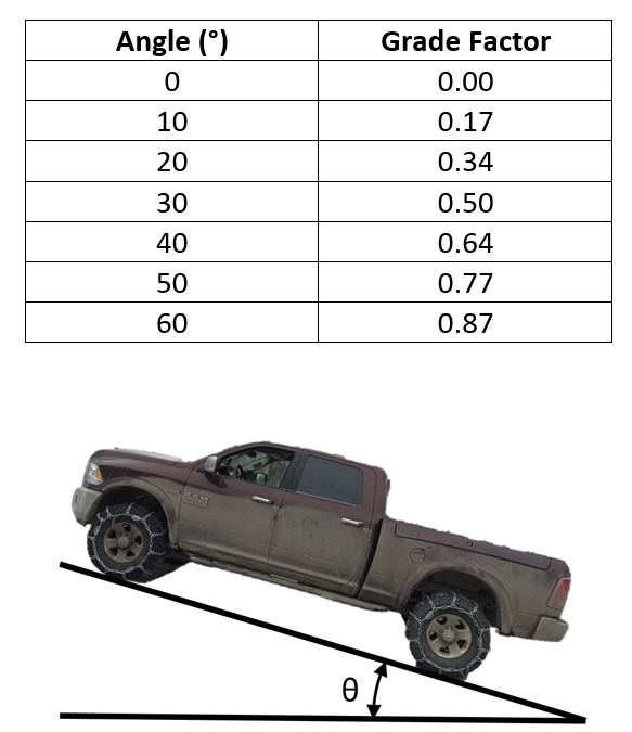

Grade Resistance
Grade resistance is the load on a vehicle imposed by the angle of the surface it is stuck on, along the direction of travel of the vehicle. An uphill grade adds resistance, and a downhill grade subtracts resistance.
Multiply the weight of the vehicle (including cargo) by the grade factor to determine the grade resistance.
Grade Resistance = Vehicle Weight x Grade Factor
