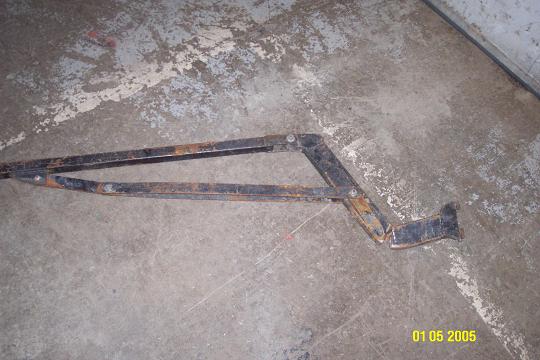

Found this pic of a Pull-Pal failure. Site says it's the old RW9000, which it turns out is what I have. Found a small label on mine that I did not see when I bought it. This failure is more like what I would expect when overloading the Pull-Pal, and probably explains why some of the current models seem to have gusset plates welded to that section before they are painted or powder coated.

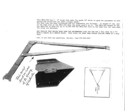

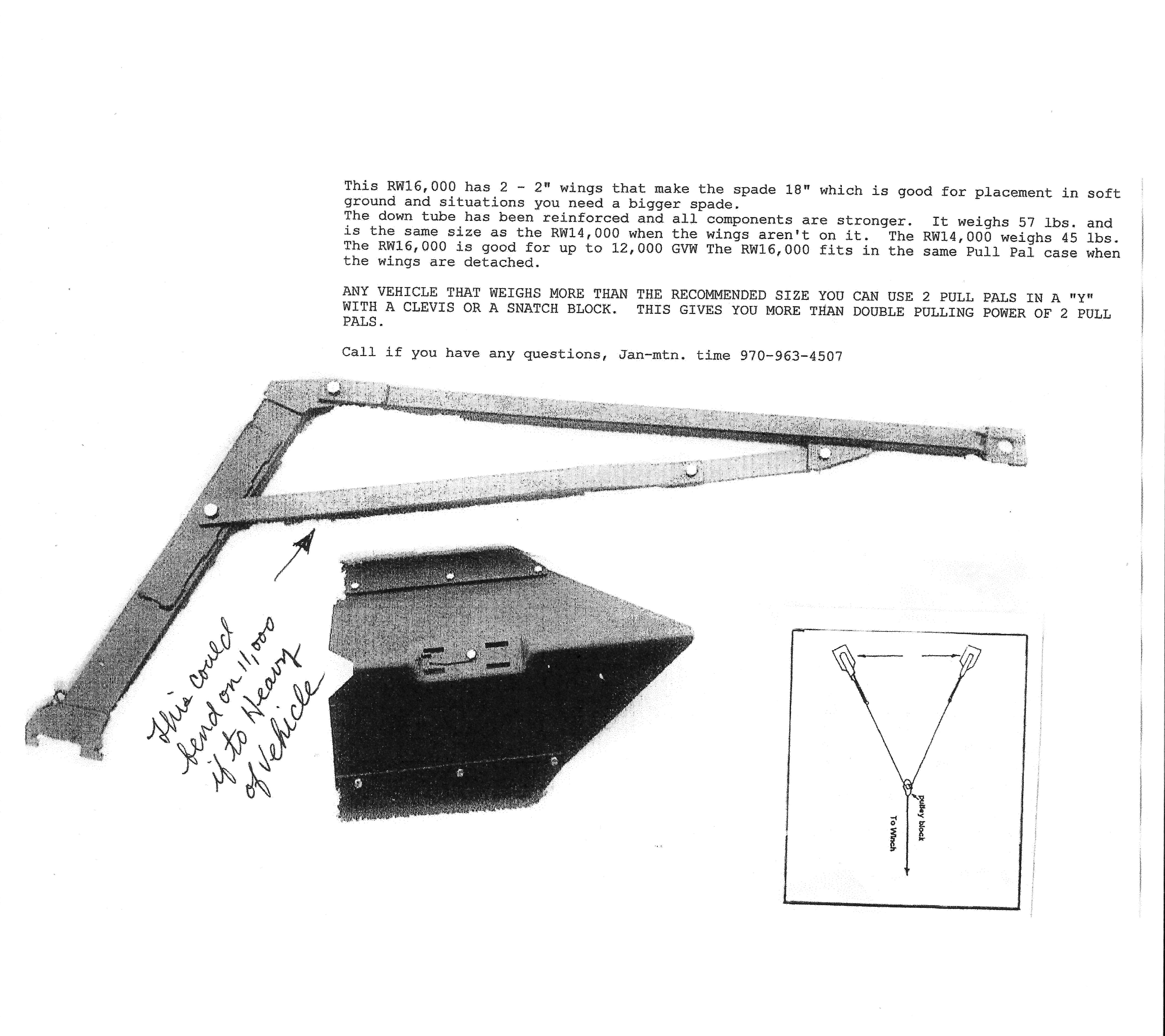

Here is the pic of the Pull-Pal RW16000 that Jan Gremillion sent me. See her note about where it would fail if overloaded, which seems contrary to both logic and the failure pic I posted earlier. Note also the gusset that appears to be welded to the down-tube where the bolt goes through that tube.
