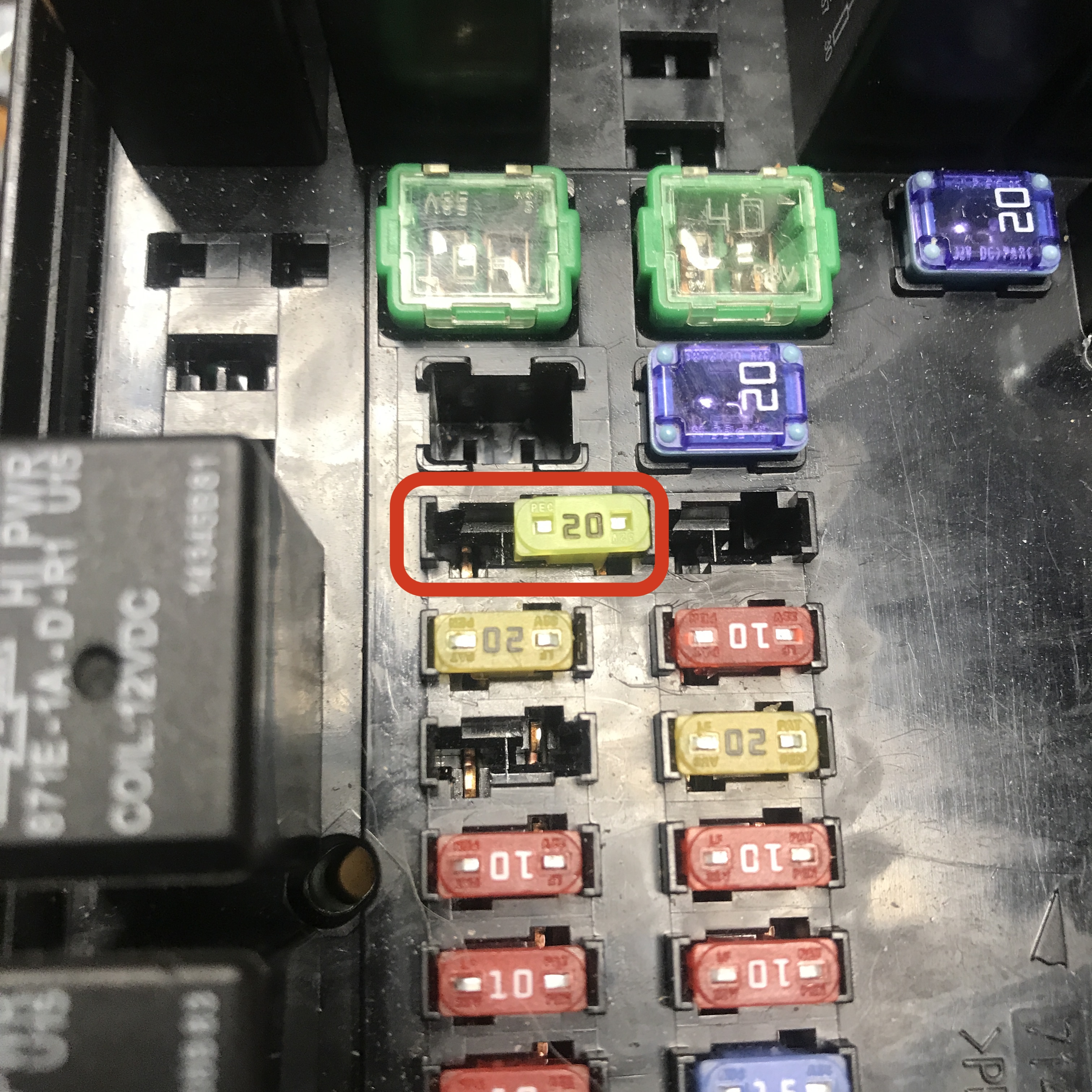

Here's a picture of a 4th & 5th gen fuse box. It's fuse #F90/91.
In this position, one of your power outlets will only have power when the ignition key is turned on.

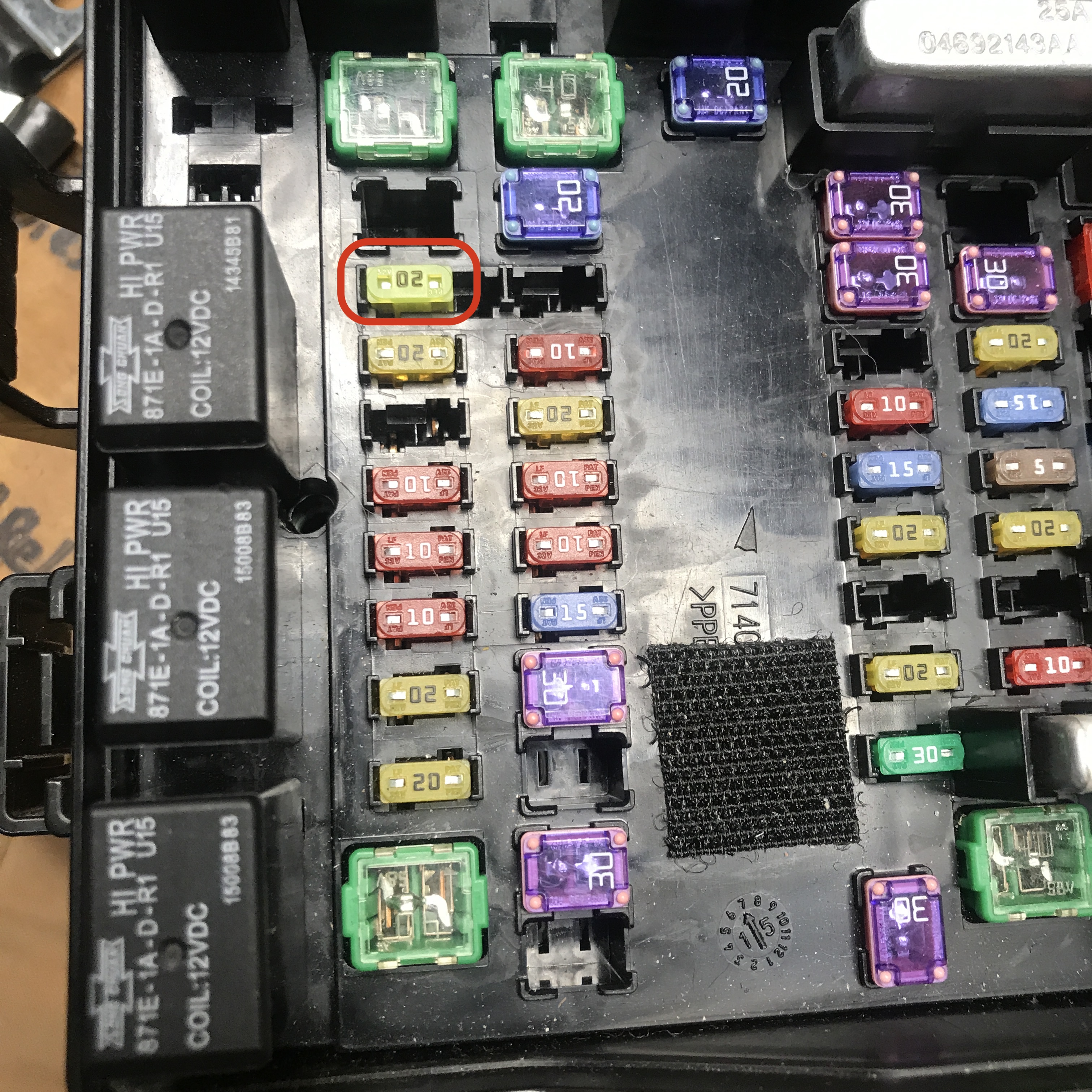

If you shift the fuse over to this position, the power outlet will have power all the time, even when the vehicle is parked.

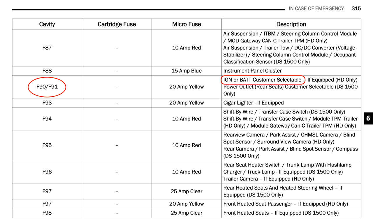

Here's a screenshot of the owner's manual that explains it.
